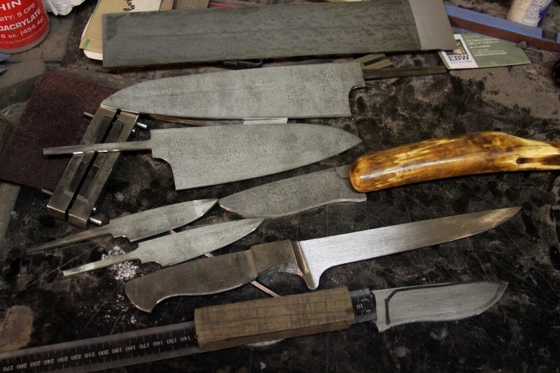

  10. HHH Knives
    Made some progress on the damascus blades yesterday . [​IMG] All are profiled and ready for Heat Treat. [​IMG]
    The mokume is all made and now need to be rolled out to thickness. I have enlisted the help of my friend and teacher Del. He has the right tools and the experience get this stuff down to the desired thickness and sizes needed for this special project. Thanks Del.
    So thats it for now. Im on hold for a minute while I wait for the Mokume to get back to me.
    Sorry about the bad picture. The top 2 blades and one of the small paring knife blades are for this EPIC adventure. There is also going to be a 4th knife in this WIP but Ill probably wait and just show the finished knife. As Its sort of a surprise/gift. And not a kitchen blade. [​IMG]
    You may also notice there is a few other blades in progress as well. [​IMG]
    Its a KNIFE LIFE
    Randy
