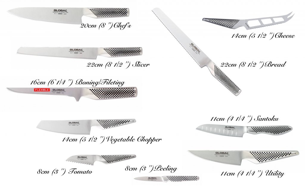

  1. Hello everybody! I decided to join here so that I get some help into completing my kitchen knives collection. I'm just home cooking, but appreciate the use of good quality knives. Here in my country Global is a brand that offers such good quality for an affordable price. Therefore, a few years ago I decided to switch to Global completely. Now I have come to the idea that something in my collection is missing, but I cannot decide exactly what?!
    Mostly, I do European style cooking and generally prefer smaller type knives. My mostly used knives are the small Santoku and the vegetable chopper. Apart from the knives I have kitchen shears and a peeler. I probably wouldn't find any use for a cleaver.
    So, I will appreciate some wise thoughts. Thanks!
    This is what I currently have:
  2. A few whetstones to keep your set sharp is all you need :)
    I would let a need drive that decision of a next knife. In other words is there a task that you do that might be more efficient with a different knife?
    I dont see a long slicer in your kit?
  4. Anton, currently I have a minosharp wheel sharpener. I find whetstones intimidating, I'm afraid I will ruin my knives, because I don't have the skill to use them. If I do get some, is the Global set with 220 and 1000 grid a good choice?
    Jim, I probbaly miss something in the 15-16cm length range. Doesn't the 8.5" Slicer look good for slicing to you?
    If a 220 mm slicer works ok for what you do then there is no need. I prefer much longer slicers like 300mm+.
