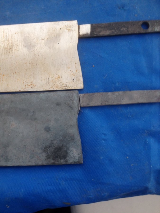

    I have been little over ambitious with one of project my knives and after quench while trying to straighten the tang I snapped it from the blade. I have annealed to blade and the broken tang with the hope of salvaging maybe at least the blade.
    Can I weld them together and heat treat? Or is my only option to make it a smaller knife ?

    Hidden tang , snapped right from where it connects to the blade

    Looks like you created a stress riser, by not allowing a radius where the tang transitions to the shoulders. It isnt in a critical area, so grind a little bevel on the snapped piece, align and mig/stick weld. Clean it up and HT. You may be left with a cosmetic line at the weld, but if you push the heel/machi forward, you can hide it in the handle. It wont harden, but should hold.

    Thank you for suggestion Pierre , unfortunately after some inspection I found hairline cracks at the tip of the blade, so this batch is going into the scrap bin:(
  7. Pierre is right on all counts. bummer about the cracks.

    Mert you can weld like Pierre said how ever you are going to need to thermal cycle the welded area I would do it at least three times. If you don't do this the welded zone will be more prone to breakage than it was before. Also don't cut the machi for the tang/ handle to such a sharp angle. I don't do mine until after the blade is hardened. Heat the weld and tang to a black heat just going into dark red after you harden temper the blade. This will make it softer and less likely to break again. Then just make a smaller blade from it to get rid of the crack at the tip.

    Thank you for your explanation Bill, I have learnt not the leave the tang area like that hard way :) I am going to experiment welding a tang on one of my "shortened " blades to see how it comes out

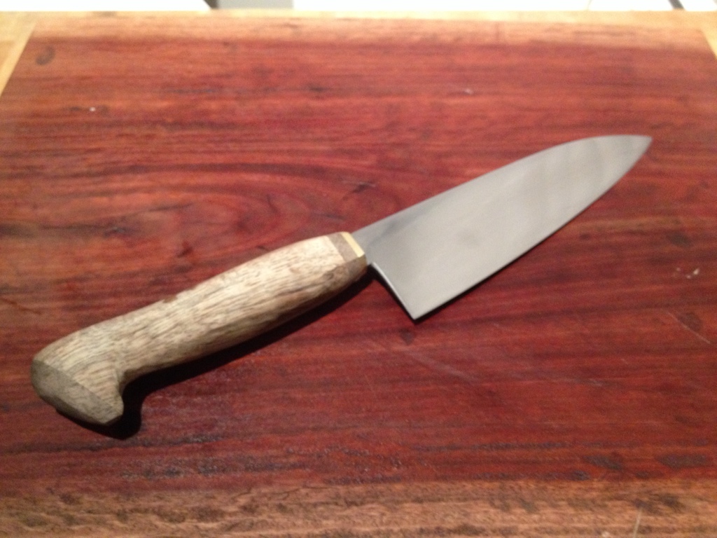

    Thank you all again for your help, when life gives you broken tangs, you make santokus I guess!!
    Here is a preview
    It is 175mm on the edge and will get a Hawaiian mango and claro walnut handle
  19. Well that looks like a great save! from broken tang to sweet looking santoku, nice!
    What actually is the difference between a santoku and small gyuto, is it just a profile thing?
  20. chefcomesback
    Thank you , the reason I called this one santoku is the tip is quite low and it's between santoku and a short but tall gyuto
