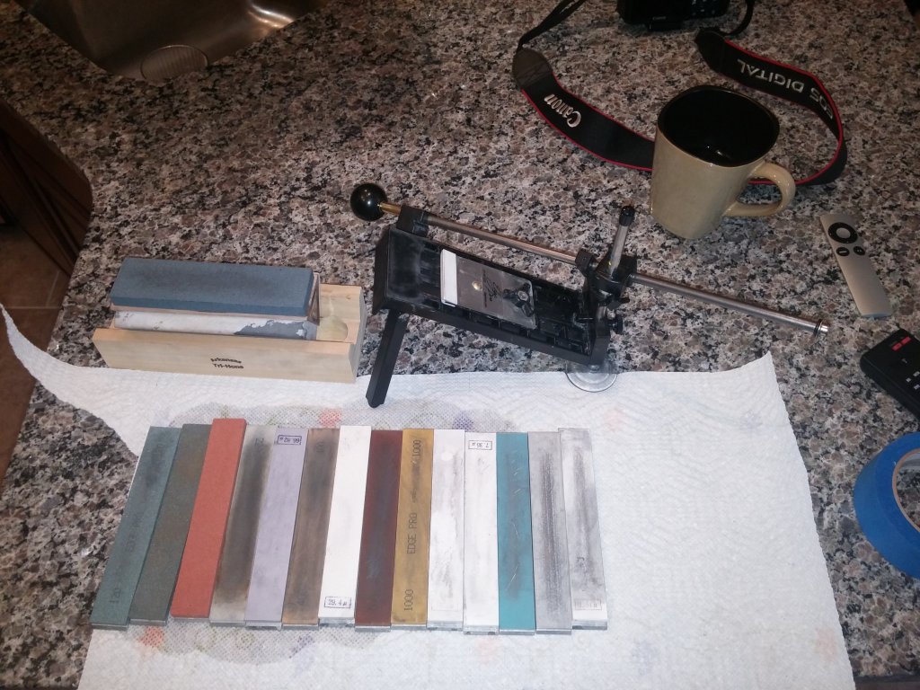

  6. I have an edge pro apex that does a fantastic job on smaller blades. I have some Shapton and Nubatama stones for it aswell. Looking to get better at free hand though.
    I think I will buy a cheap chefs knife to practice on. Any suggestions for some good stones to start out on? (not trying to jack this thread, sorry) 0220151340.jpg
  7. Reid, I use a simple King 1000/6000, and finish on wet newspaper, felt, or balsa depending on my mood. This is a very good basic setup to practice on, and is fairly inexpensive. The edges produced can be pretty spectacular if you're careful and thorough.
  8. Thanks Cris! Ill be checking that out soon
