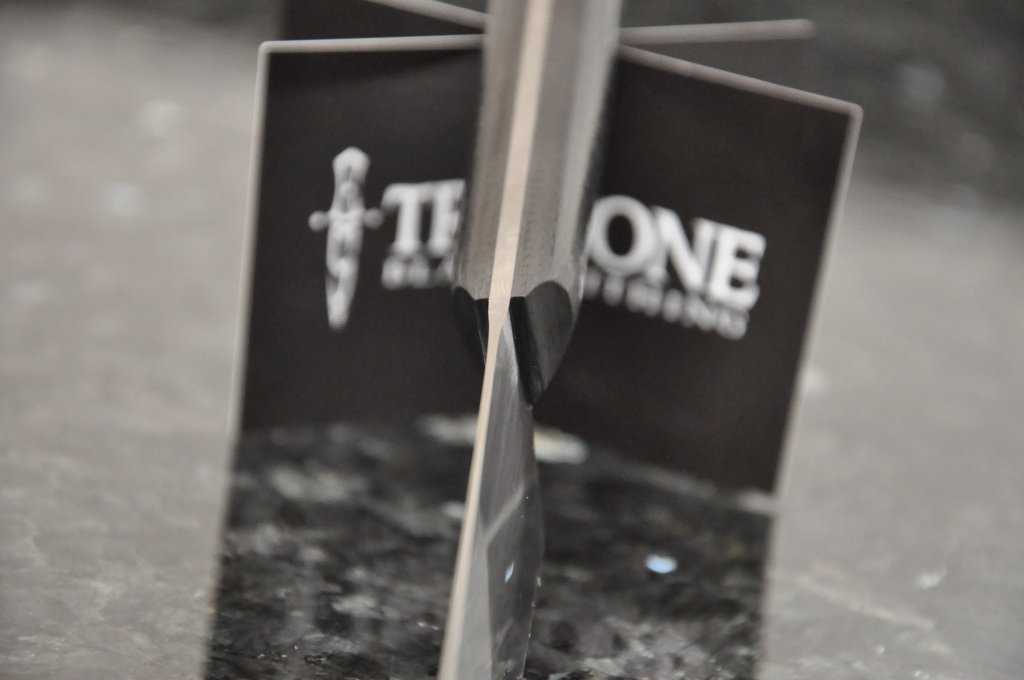

  5. I was lucky enough the other day to pick up both a 72" and 48" radius platen. Below is the results of 15minutes grinding to get from what was a scrap piece of AEBL at 60 HRC i broke as part of my controls for the knife show. Suffice to say if I get told these knives snap, I'll be asking some questions and sending a video. Like I said though, fifteen minutes to get a hollow from the spine to 8mm above the edge with a 72" platen (Per side). Computer sims I ran of the grinding showed that I still have just over 1mm at the narrowest point between the two hollow grinds, which was one per side. This obviously a rough job and it is the first time I have used the platen, but from what I experienced during grinding I am quite happy with the results. I'll do some more testing after the show and make a few knives with a professional finish to test the performance. I will keep you updated.

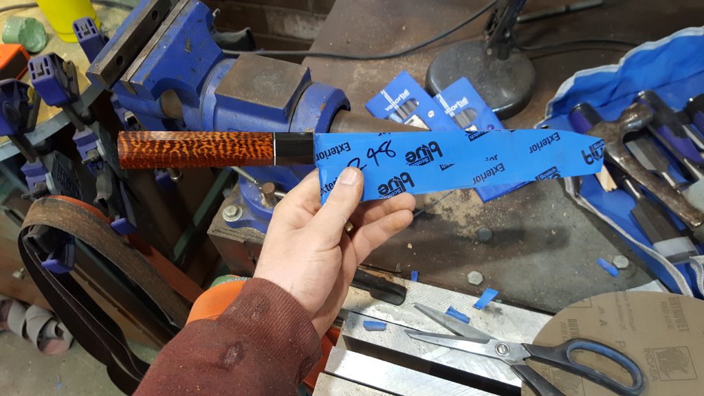

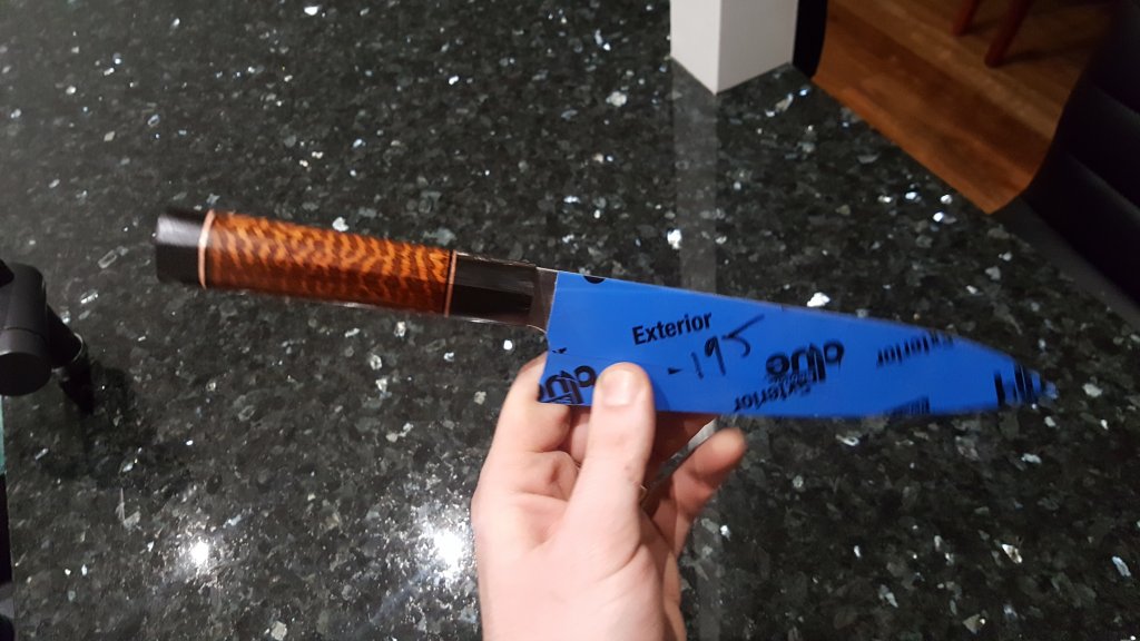

    Below are some other shots of my knives I have been prepping for the knife show. I have not yet done any full tangs much to my dislike, and I am hoping to get a few done before the show, I have two AEBL blades at 60HRC and one RWL34 blade at 63hrc full tangs waiting to be done. Anyway here are some pictures of some WA handle knives, just keep in mind these are not finished and after the knives are glued I will be cutting the rear of the handle to put on the angled butt for those knives that require it.
    20160727_151726.jpg 20160728_224815.jpg 20160729_202618.jpg 20160730_155945.jpg
    165mm SG2 Wa Gyutuo at 1500grit with Black buffalo, copper, g10 and Snakewood D shaped handle.

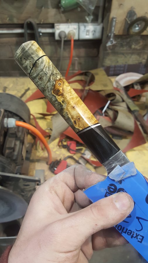

    This was the first rendition of an octagonal, black buffalo, stainless and snakewood handle on a 248mm RWL34 mirror polished blade. I changed this to a kite handle.(Octagonal on the top, oval on the bottom. In my opinion gives both comfort and looks over a standard Octagonal handle.)
    This one is an RWL34 Gyuto 210mm with black buffalo, stainless, g10 and ringed gidgee kite handle.

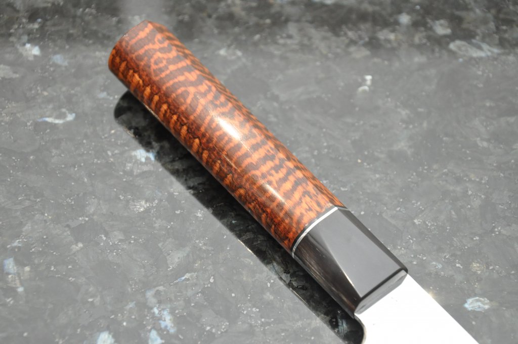

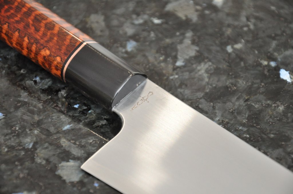

  12. This blade here is a Super Gold 2 San Mai gyuto at 195mm long. Handle is Horn, snakewood and copper and won best kitchen knife of the Sydney Knife show 2016. Very happy and honored to win considering the stiff competition.
