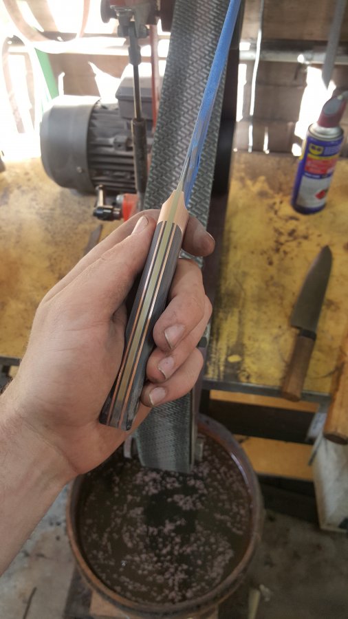

  5. More of a WIP on the second prototype G10/Copper/62HRC RWL34 210mm Mans Man knife.
    Lining up the plunge lines and bolsters does not seem to get easier with practice.
    Still a lot of work to do on this one.
    Thanks for looking, comments and questions appreciated.
    Chadd.

  19. Few more pics of the RWL34 @62HRC 210mm gyuto. Triple cryo and tempered. Very thin behind the edge. This one seems to be a pleaser amongst the makers here at the show. I date day I will be making a couple more. I have a 250mm 61HRC S35vn and 250mm 62hrc Niolox blade coming in the same design but with lightning strike carbon fibre for the scales.
    This one is one of my favorites, currently for sale, $1,200 AUD.
    Thanks for all the kind comments I appreciate the feedback from everyone.
