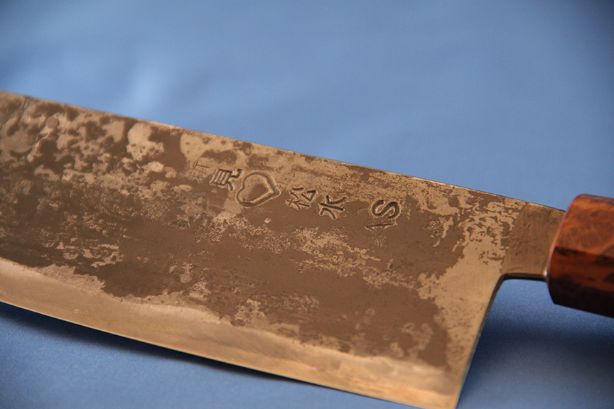

    Hard to tell exactly what you're talking about without pictures, so I'll share one of mine that's already on my computer, though it's not the greatest for showing it either. Shown is the kuroichi cladding. If you look closely, there are two different grays extending to the edge of the knife after the kuroichi finish. The first duller gray after the kuroichi is the softer steel cladding the harder steel core. This softer layer is called Jigane. The harder layer of steel is called Hagane. These two terms are Japanese, in the states, I often hear them referenced as cladding and core steels.

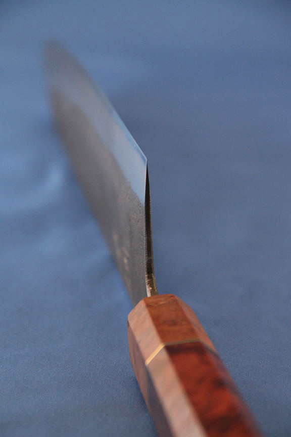

    Below is a picture of another kuroichi cladd knife taken from the perspective of the choil (the curved section extending from the handle to the heel, and referenced as such because it does not have a bolster). Thinning this knife would be to flatten the exposed section near the edge. That section should be flat on both sides of the knife, though if you only sharpened at that angle, the edge may be too thin to be useful. Hence, most sharpening is at a slightly more obtuse edge that can handle more obtuse. Neither of these knives will have to be thinned beyond that, as they are slightly concave after that bevel. The concavity leads to the max thickness of the bevel getting thinner and thinner as progressive thinning happens. Thinning convex or flat ground knives means starting from the spine, and removing material all the way to the edge, but most kuroichi knives I've seen are slightly concave. If you want to look at the grind, hold a flat edge (a business card works well here) against the side of the knife, and see where it makes contact and doesn't by looking for light coming through the gaps. Hope that answers at least some of your questions.
