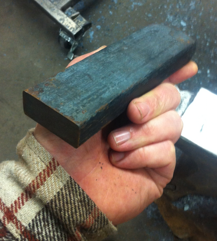

  5. Ok folks, back at it again. Here's a little extra to go with the previous post.
    This is my bar of mosaic steel that I grind clean of forge scale, then cut into little tiles, flip on end so as to orient the pattern to face out and to be seen on the faces of the blade.
    Screen Shot 2015-12-01 at 9.55.35 PM.png Screen Shot 2015-12-01 at 9.56.08 PM.png Screen Shot 2015-12-01 at 9.56.38 PM.png
    I have to take good care to maintain the proper orientation and relation of the pieces to each other as I prepare them to be forge-welded back together. Doing this ensures that the pattern flows together nicely from piece to piece.
    From this point each individual piece is cleaned up to at least a 220 grit finish to allow for clean, flat surfaces of contact. Then, as shown in the video in the first post, the pieces are tack welded together, a handle is attached for ease of moving it in and out of the forge, and then the material is heated up white hot before I put it under my 25 ton press to combine an incredible amount of pressure with the extreme heat to achieve a solid forge weld.

    Screen Shot 2015-12-02 at 9.49.47 AM.png Screen Shot 2015-12-02 at 9.50.18 AM.png Screen Shot 2015-12-02 at 9.50.53 AM.png Screen Shot 2015-12-02 at 9.51.24 AM.png

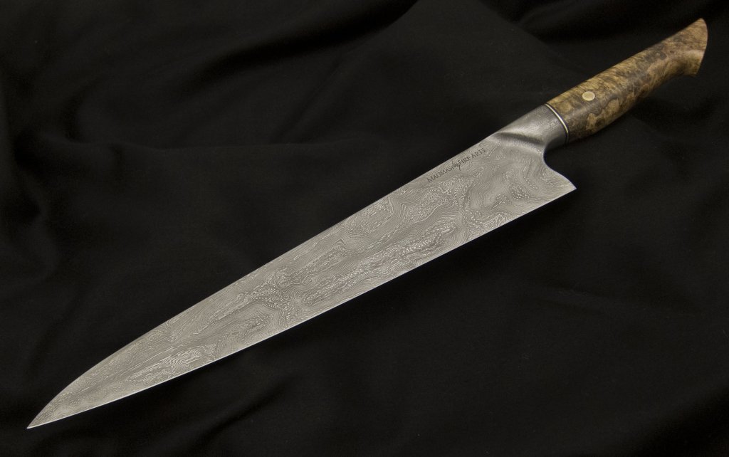

    After the heat treat is all done the finish grinding begins. The blade is ground down to it's final dimensions and then the handle is put on and handle sculpting takes place, taking care that all the contours and lines of the hand look and feel perfect.
    Here are the pictures of the finished Suji:
    I hope you all dig the finished piece. Again, I am so incredibly sorry that it's taken so long to get these final images up.

  11. Just. a m a z i n g. what a piece of art!
  12. Thanks @zetieum! It certainly was a fun challenge as it was a new mosaic forging technique for me.
