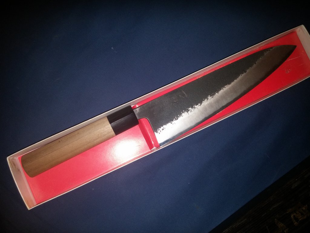

    This I'm working on!!
    The original knife.
    Thanks Al!! I hate to have taken over bieniek's thread lol. I watched his video again, and can see some very subtle differences in the way the knives were modified. It looks like he kept the shorter shinogi height (and thus a thicker knife at the shinogi) towards the heel. I actually thought about this after the fact, as it probably wouldn't affect performance much, and would aid in increasing anti-stiction in that area vs the grind I did. It's a lot easier to remove metal than put it back on though, so it was kind of a moot point by then :p. Regardless though, the hollow forged into the blade flats makes for great anti-stiction regardless, so the thinner shinogi wasn't a complete loss.

    1 Some time ago, when the blade started loosing its, otherwise very durable, black finish, I polished the blade [machine job] thinning somewhat the sides, so that is a part of the reason why "shinogi" seems lower.
    2 One other thing worth noting is that in the video you can primarily see the right side of the blade, the left side [for a righty] is ground at even more obtuse an angle then the right side= shinogi is a tad closer to the edge still.
    Why is that? Just my philosophy.
    I believe that the right hand side should have a mildest curve to it, convex from the shinogi all the way to the edge.
    Entirely different on the left hand side, where I look for a bulky differing between blade flat and a shinogi and a secondary bevel.
    I believe this, by some natural force, when slicing/chopping fast, makes the knife un-stick
    [you are familiar with those laser type knives with flat grind on one side that when it gets stuck to a potato, you need 10 tons garage press to release it?]
    itself from the produce on its left side and held by cutters left hand. At the same time, just the gentliest of curves on the other side makes the produce let itself cut easier without too much of a drama and just slide off of the concave secondary bevel.
    My sharpening angle on the right side is also steeper.
    It might be a load of crap to you, guess this to me is what his kiai is to Master Motorcycle driver Murray Carter :k
    3 To answer what youre asking about finally. I would not say higher shinogi means thinner. My first thought was that the blade must have been thicker at the heel??
    But no, you sneaky man...:j
    If it would be so, I would not care about how funky this or any other shinogi looks like on that cheap of a knife.
  6. Ahhh! Good to know!! I was saddened by the idea of you slaving away on a stone or diamond plate for years to work on that knife :p.
    More seriously though...I knew that lol...I'd just completely forgotten!!
    On how you ground it, not crap at all!!...and I think I've got it. The right is a convex (helps with food separation without sacrificing cutting too much). The left I might not be understanding completely. The blade road is basically flat?...with a sharper angle from the shinogi to the primary bevel.
    If I've got that right, it makes sense. Sort of like a cross between the laserish one sided flat grind you were talking about, and a more typical double bevel. The angled, flat blade road on the left sort of pushes the knife from the product, limiting suction, while the gentle convex on the left separates the product. The result (when used quickly as you stated) is a knife that steers cleanly, cuts well due to reasonable thinness, and is virtually suction free on the left, and stiction free on the right.
