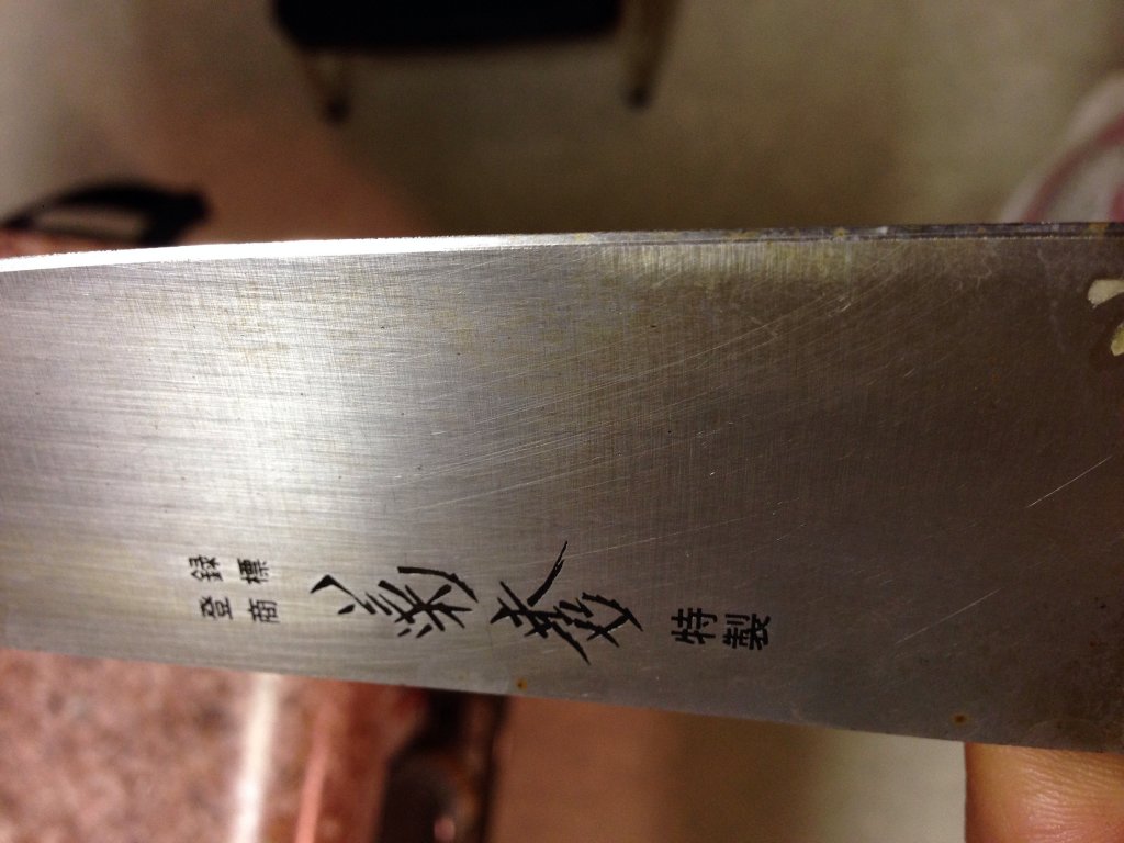

    I have a couple of knives that are only beveled on the left side, and it mildly irritates my left handed mother when she slices harder root vegetables and whatnot. Is there any benefit to it that I am unaware of before I grind a bevel into the right side?

    Do you have pictures of your knives?
    Kent I think we need to know if they are true single bevel knives or just have a left side bias?

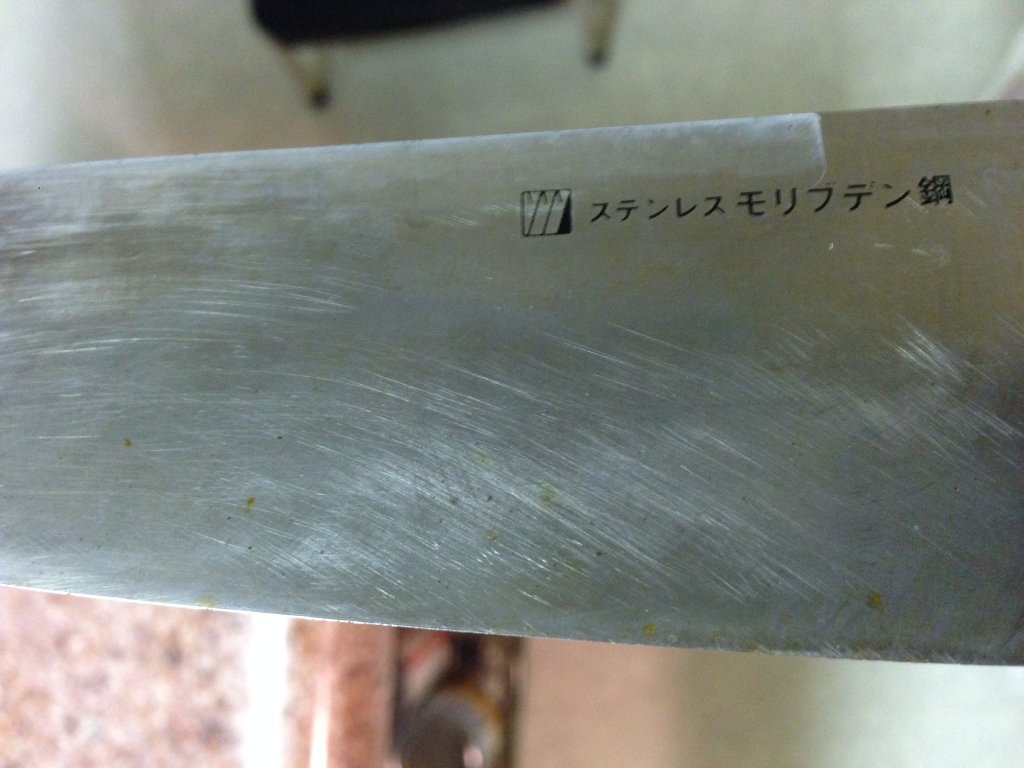

    It's a Yugo compared to the heavy metal I see from Youse afficionados :). And not maintained very well...
  5. kentos
    kentos Founding Member
    My other one I steel on both sides, but it's a single side as well

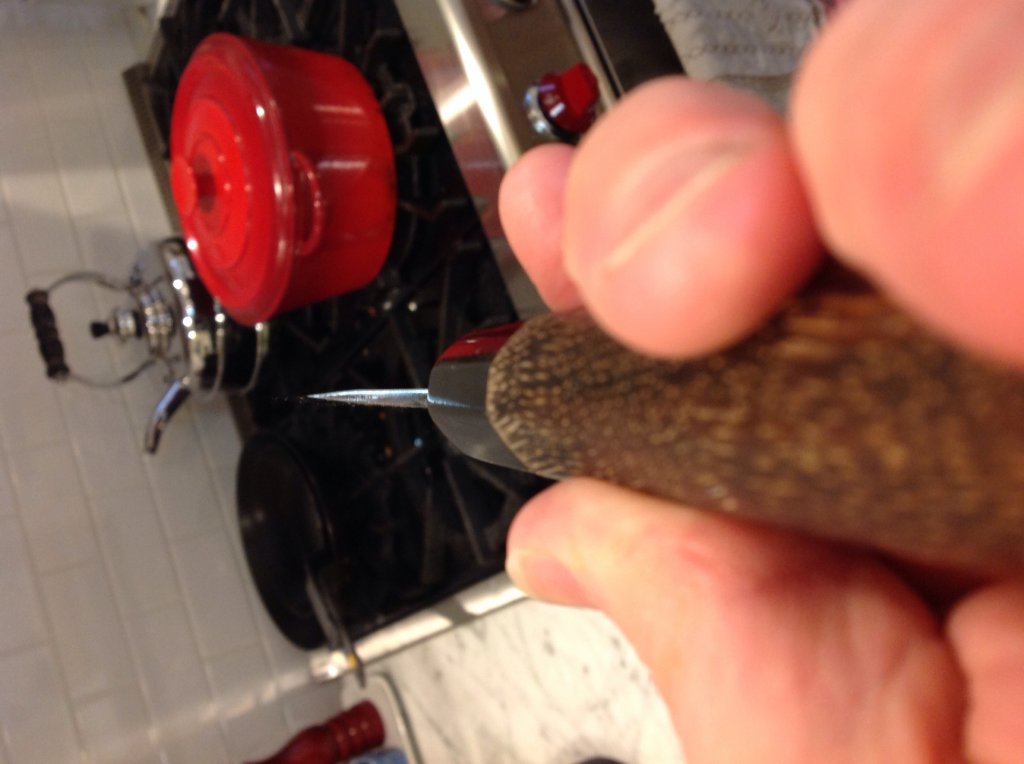

    So here's a question that I've never heard a good answer for- single bevels are beveled on the leading hand side, and strong asymmetrically beveled knives are as well. But asymmetric gyutos and sujis seem to have the flatter side on the leading hand side, with a stronger (shorter) bevel on the off hand side.
    Example: heiji suji, with the more pronounced bevel on the left facing side of the blade (sorry for the crappy ipad pic). My theory is that many single bevel techniques cut to the left side of the knife (eg sushi/sashimi slicing, etc), while western techniques cut to the right side.
