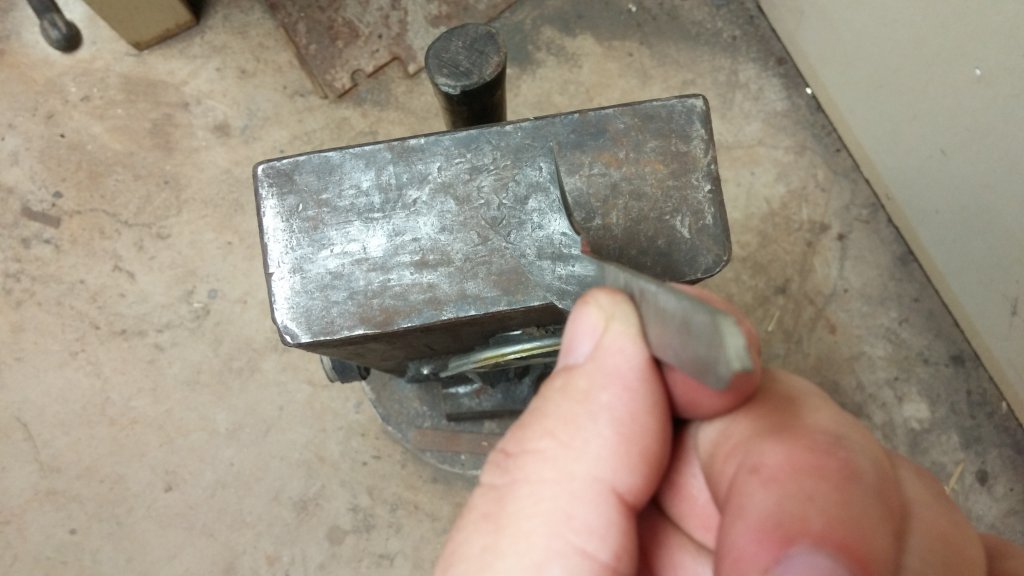

    I posted this just for Jason lol. My 155mm Predator camo utility knife :p.
  14. Toothpick
    I would be predator bait for sure. I was looking at that pic thinking "what is going on here?...he welded a rod to a slab of metal?...what the heck is he making?"
    Then read the comment. :Dave
