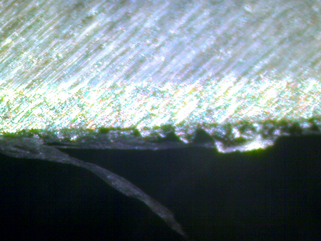

    First pic is no edge at all, just the finishing scratches from 150 grit sandpaper. The edge is about 1/1000 of an inch wide at this point measured with calipers.

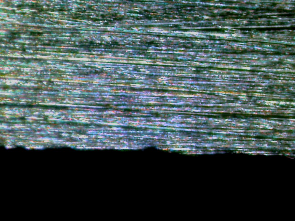

    Second pic is me forming a burr and then flipping it. The dark spot is where the metal has started to roll up, and the light edge is the burr facing the camera. My fingers can easily catch on this burr. Time to refine it.

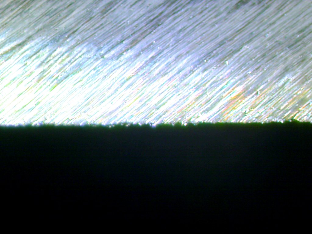

    I've now refined the burr on the 120 grit dmt. My fingers can't feel it, and the knife feels very toothy. You can notice that there is a wire edge still attached. Thankfully, there are more stones to come.

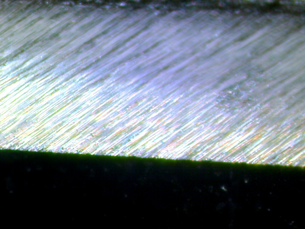

    I've now built a burr, flipped it, and refined it on a 600 grit splash and go. There' definitely a wire edge, with a large portion about to be ripped off. My fingers can feel refinement in the edge, and I cannot feel a burr at this point. The edge feels toothy, though not as toothy as the 120 grit, but I am unable to feel the wire edge with my fingertips. I was caught off guard by this one, but I moved on with my normal progression with how it was feeling to me.

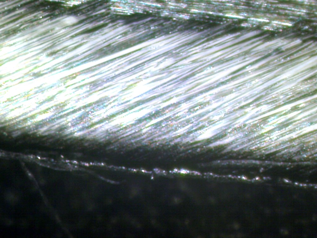

    I jump to a 6k diamond ceramic at this point, and have gone through the build a burr, flip, and refine. At this point, there are only micro-burrs, and while the edge is fairly smooth, it does bite into the pads of my fingers.

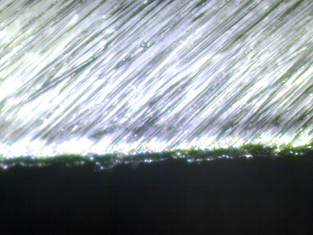

    Last, is after I've stropped on leather with chromium oxide, and light cuts through hard felt. No detectable burr, consistent scratch pattern, and it's cutting well, though I still need to go through a session to make sure the edge isn't too thin, and will handle a little abuse.
    I hope you enjoyed today's episode of I think I know what I'm doing! All done freehand at about 12 degrees per side on AEB-L steel @~62 hrc.
