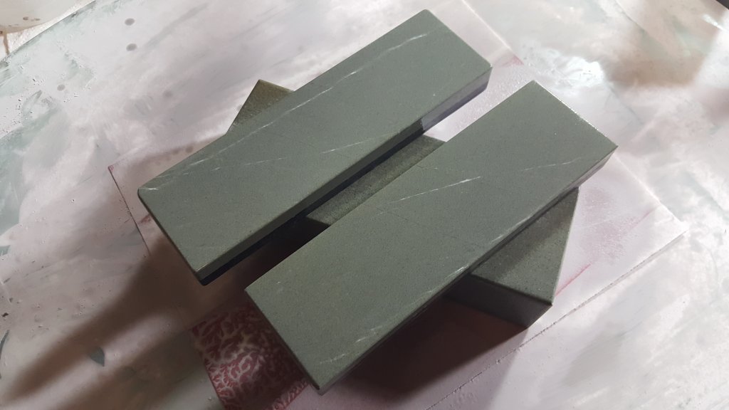

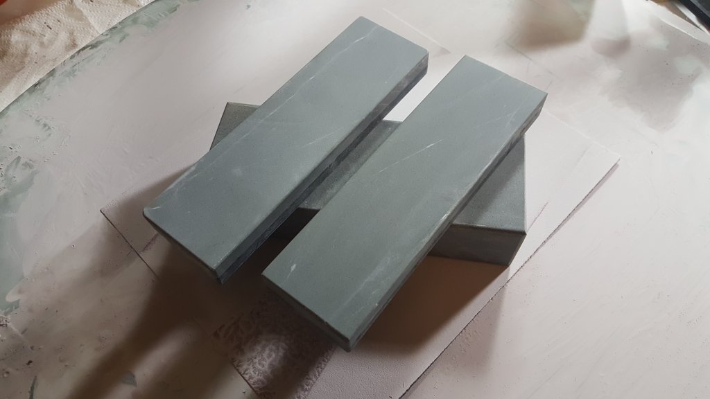

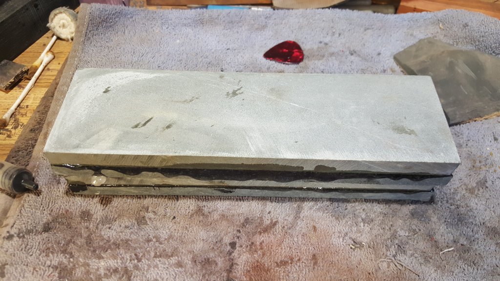

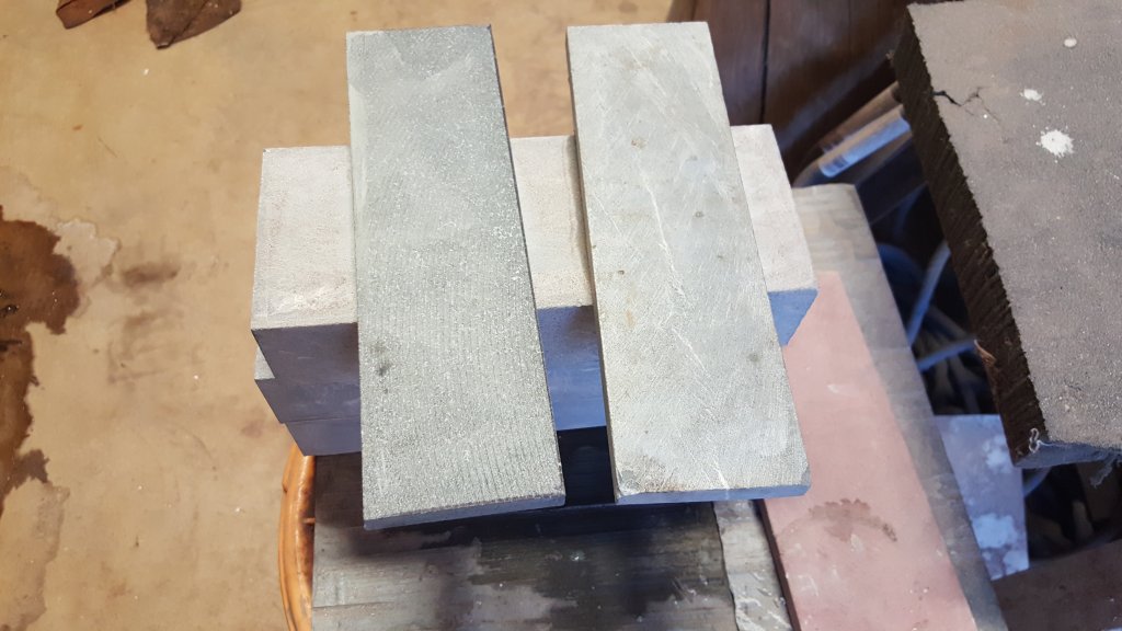

    Half inch thick cut stones on the right, granite on the left.
    The surfaces to be epoxied together.

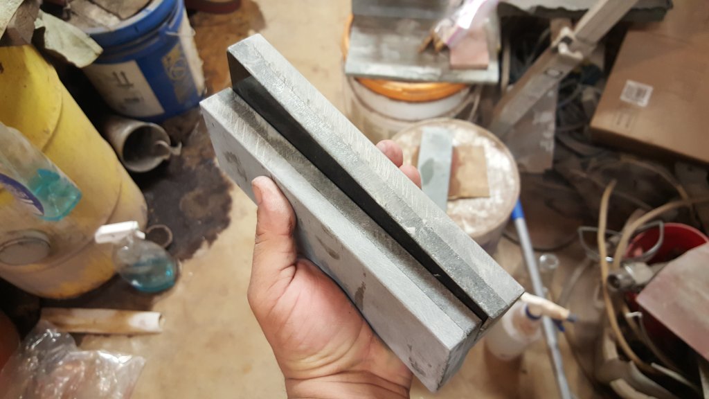

    In epoxy. I have to keep them clamped for at least 15 minutes each, then they have to sit for about a half hour before I can work with them.
    Two of the pairs epoxied. You can see that the tiles and the stone don't align perfectly. I have to cut the tile a bit oversize to make sure it clamps properly. I've tried it a couple of other ways but I don't have the ability to cut the tile to the slightly oblong shapes of the stones with any precision. Better to make a larger 'bed', and trim it after.
    Once the epoxy cures up I have to cut the tiles down, then work them as much as possible on the grinder using old belts. They DESTROY new belts in seconds. The idea is of course an acceptably smooth joint. This does NOT go quickly. I thought these stones were hard...but I'd never worked with granite.

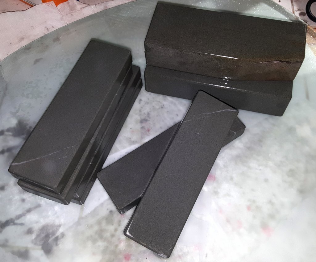

    Finished product, dry...sitting on the extra large stones for scale.
    And wet.
    I have two of these remaining for sale at $40, and two more cut after that that can be finished at the same price. I don't think I'll be making more after, as the 2hrs plus total in labor for cutting, fitting, squaring, flattening, and conditioning the stones...plus epoxy and tile costs make them not really worth making.

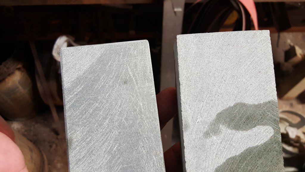

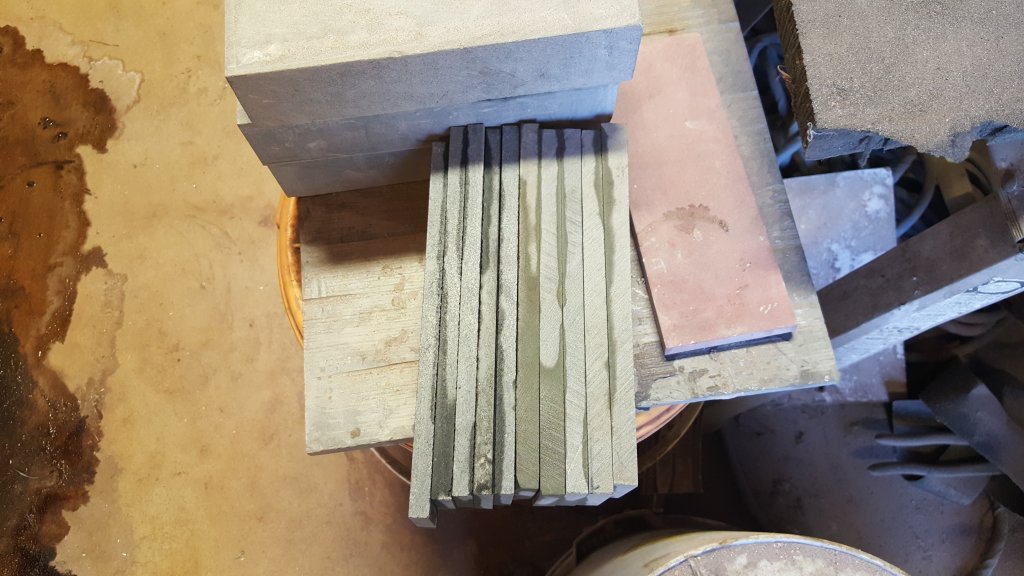

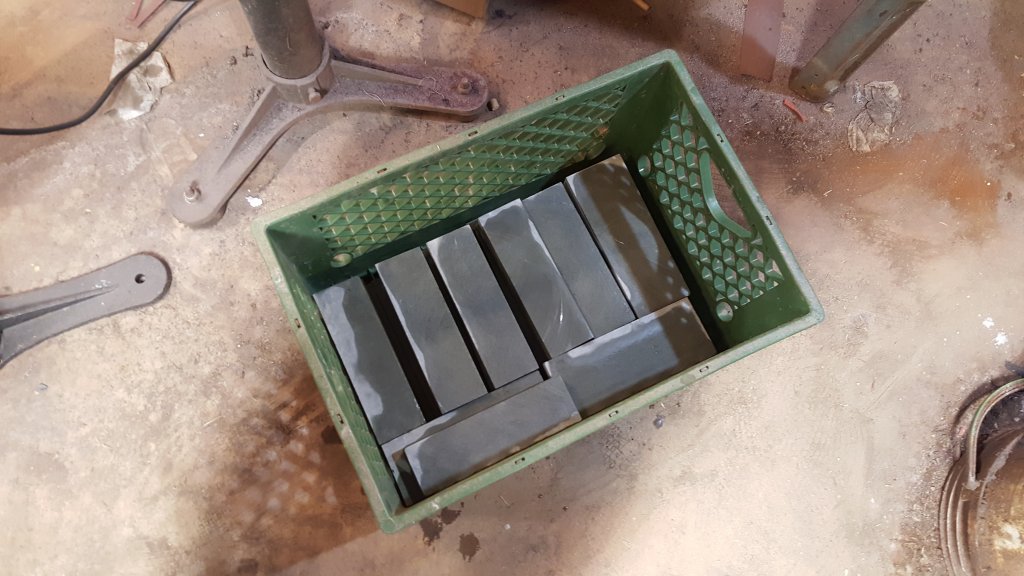

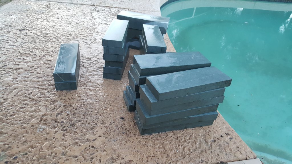

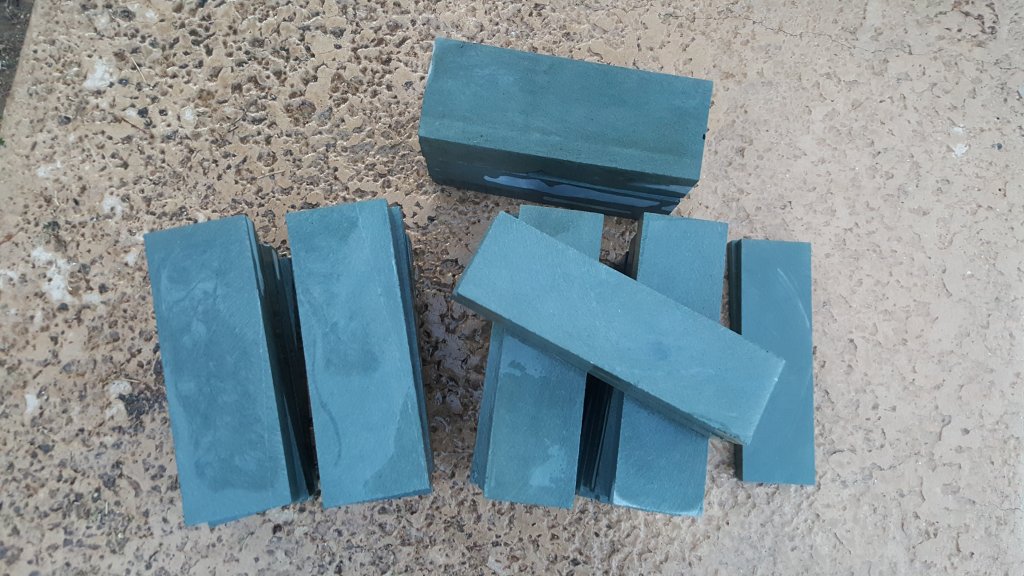

  20. Oops lol, forgot some pictures:
    Right after cutting them. I took these so you could see the size difference from the top and sides. In the top picture the mid sized (almost 3" wide) are the closest, standard in the middle, and the XL farthest. In the bottom picture the ones on the bottom right are the standard, bottom left are the next size up, and top are the big, thick stones.
    It might not look like it, but that's an easy 60lbs plus of rocks lol.

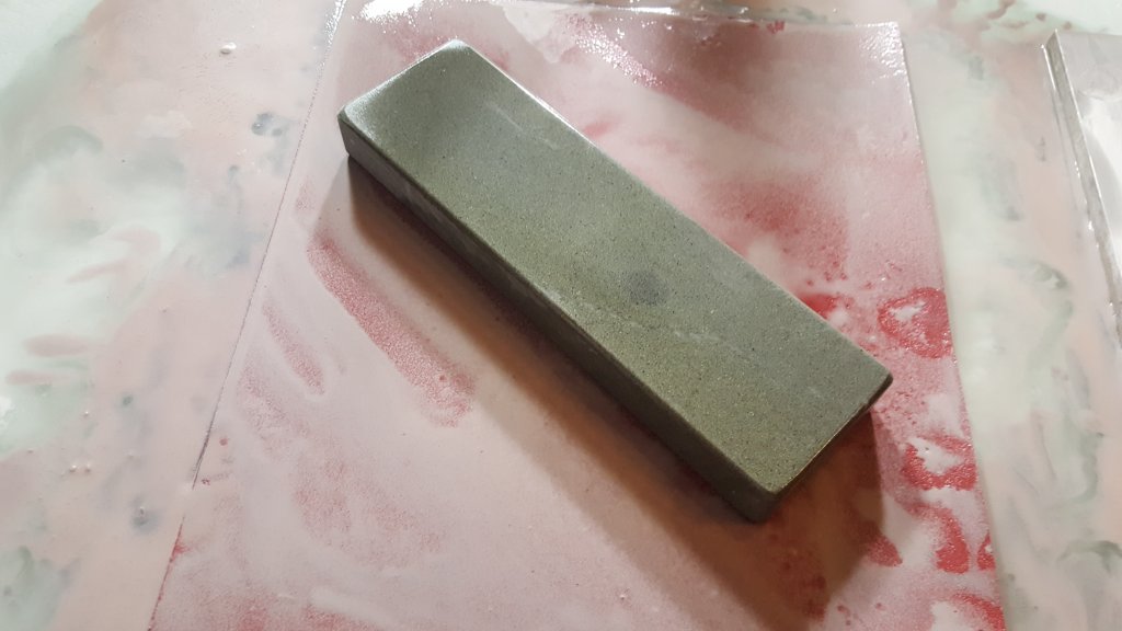

    On the right is how they come off the saw. The left is what they look like after I take a dull belt to all the corners.
    And this is after 1-1.5hrs of flattening on 120 grit paper and loose silicon carbide lol.
