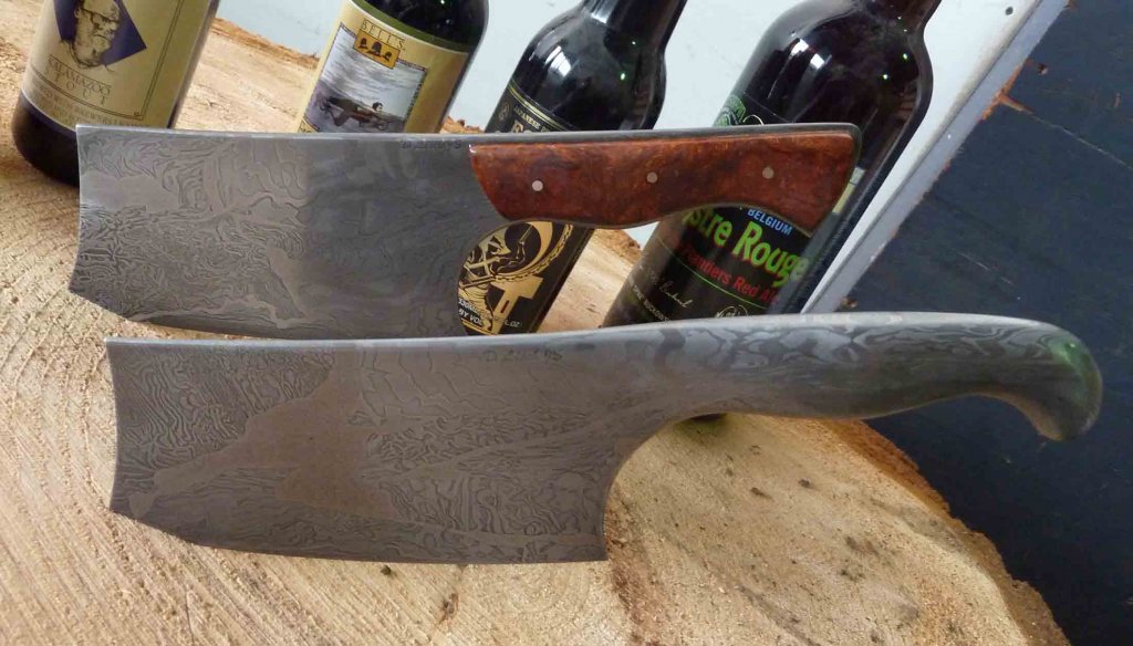

  6. clverpic1.jpg I am still trying to get my head around whats makes a good cleaver i made these two last year a frind wanted one as a grift for his wife so I made two and I think they are more like vegetable cleavers then heavy use cleavers but he like it. next time I make one I make it a bit thicker and perhaps a bit bigger. these where made using scraps bits of damascus put in a can with 4800kc powder

    They look very interesting, Mr. Lisch. I'm not certain my hand would like the large choil radius, as the typical grip is more of a pinch grip with one or two fingers on the blade. A more abrupt angle there gives the grip a better "lock" and may be more agile and controllable. I'd reduce the corner radius to about finger-size, and keep the juncture between blade and tang somewhere >3.5mm thick so a little rounding of the choil feels cozy. Your handles seem more ideal for a hammer grip, which I've seen in heavy choppers, but not really on thinner blades.
    This is more for veg cleavers; I don't know much about heavier styles. Actually, I don't know much about veggie cleavers either...but maybe I'm right by accident.
  8. Thank's I think you may be right about the radius and I never even thought that it might be held in a pinch grip. when I make the next one i will keep that in mind

    They look really cool, David. Just add your flair to a "traditional Chinese cleaver", and you'll be well on your way. With a cleaver, it's more of an extended pinch grip, with a finger (or two) running down the blade face, and the thumb on the opposite side. I'm not cleaver expert, but I'm planning on giving them another try, just so I know my product/potential product base even better than I already do.
