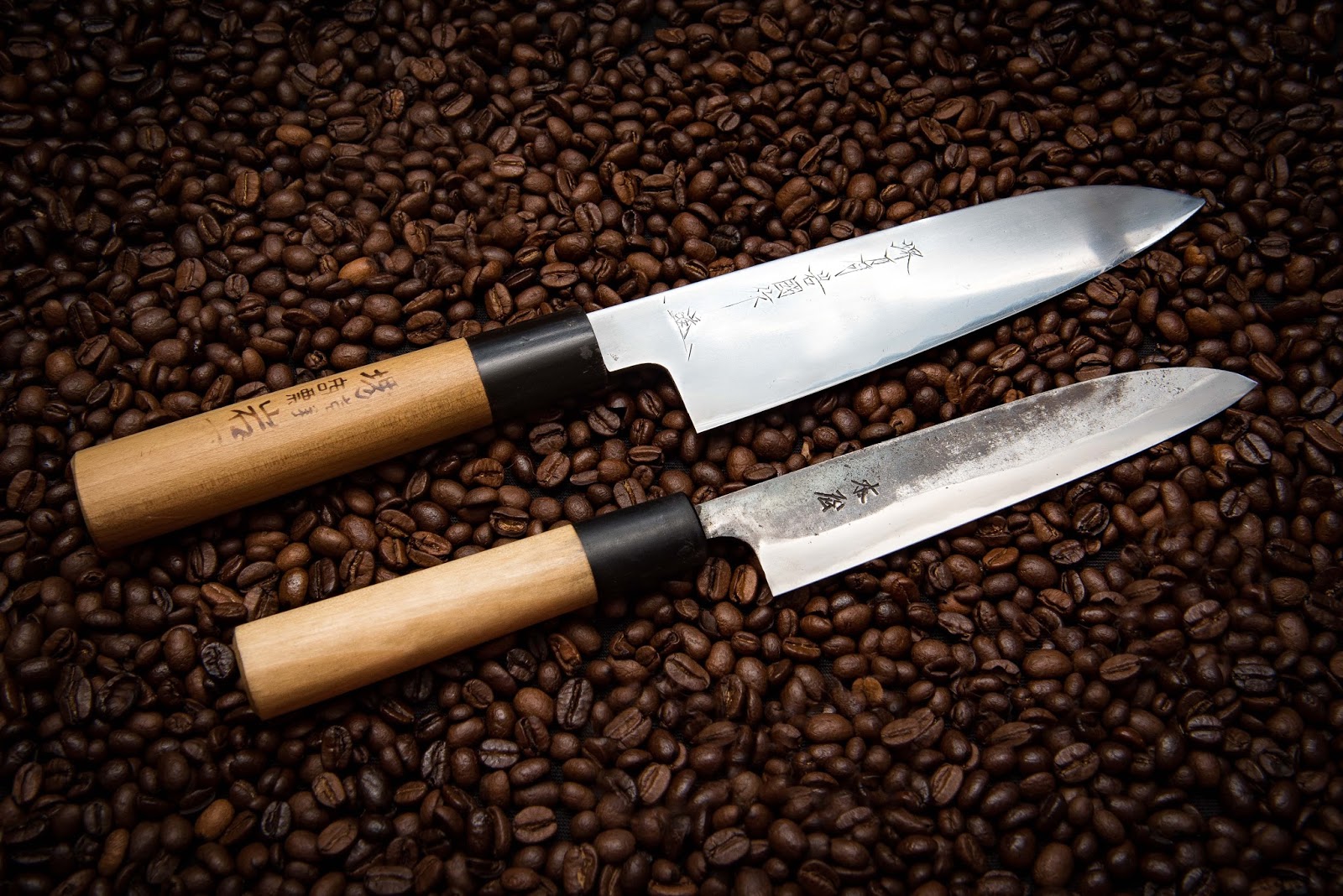

    I did some research and asked some people on the KitchenKnifeFora.com forums and again they appear to be very helpful. The bigger knife, Santoku 180mm, is a Sakai Toji Iwakuni. It is made of Yasuki steel by Izumiriki Seisakusho. I've never heard of that maker before.
    I still don't know what kind of steel is this knife made of, because Yasuki steel can refer to Shirogami, Aogami and Aogami Super. This is what I have found on the internet. (Source: http://japan-blades.com/how-to)
    Hitachi Metals Ltd. is one of top manufactures of high grade metal products and materials, electronics devices, high grade functional components and equipment. The company is well known as a manufacture of its “Yasuki Hagane” YSS (Yasuki Speciality Steel) for cutlery industries.
    Yasuki Hagane steel has been produced in their plant in Shimane prefecture in Japan where the high quality iron sand has been produced for making traditional Japanese swords since ancient times. These are three main premium grade high carbon steels (Shirogami, Aogami and Aogami Super) that have been used for making Japanese made field & kitchen knives. Hitachi metal is also known as the manufacture of high grade premium stainless steel, ATS-34 and ZDP-189.
    ZDP-189 is the highest performing steel in the knife industry today.''
    So all I know at the moment is that it is a carbon steel and it could be white, blue or super blue steel.

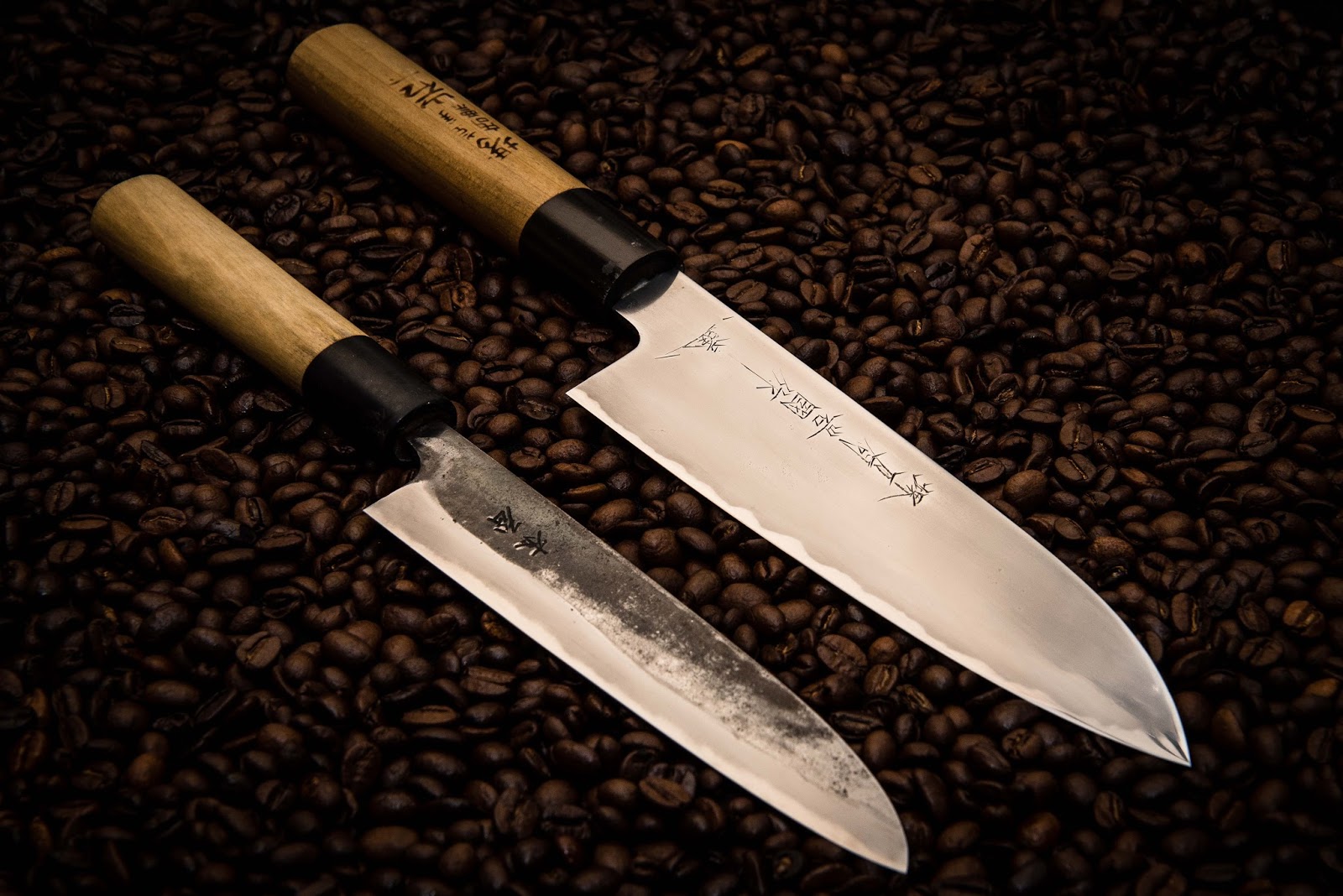

    The other knife is a small petty with ''kurouchi'' finish. I've been informed that it is ''Kiya'', but I didn't find anything about this knife on the internet. I've found other products from this maker, but nothing similar to that blade.

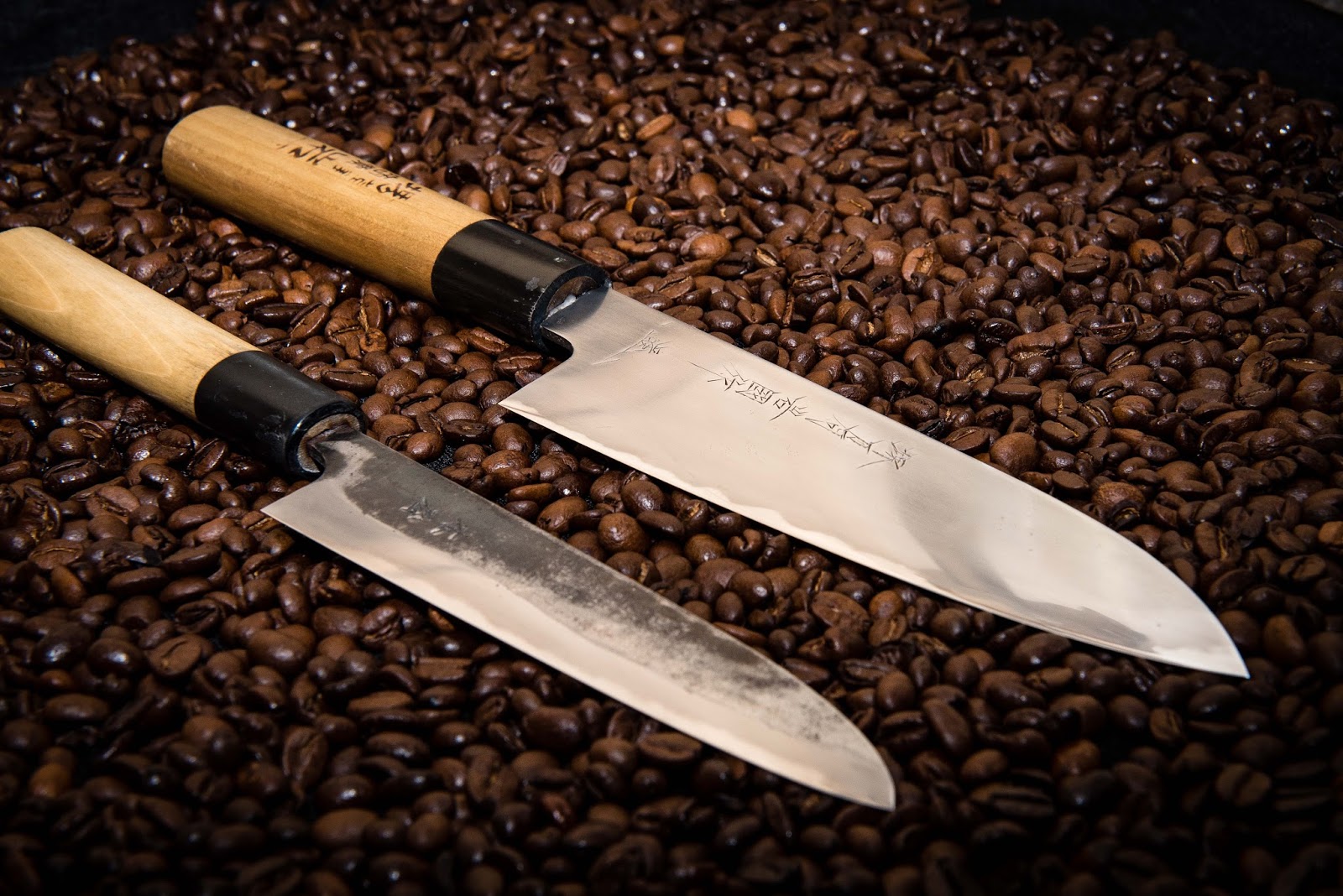

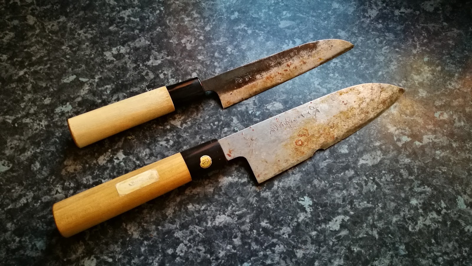

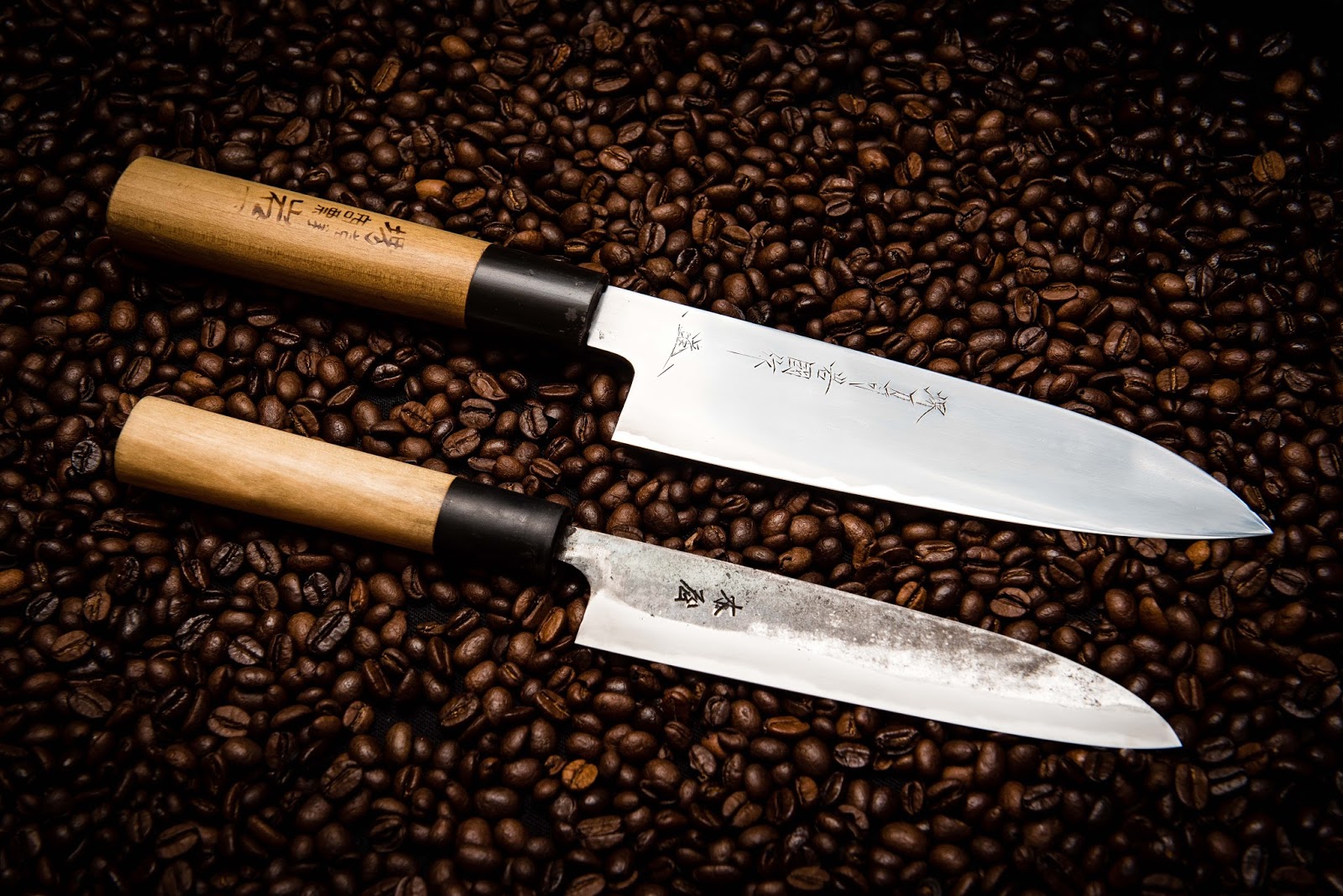

    So before we start I took some pictures, so take a look.

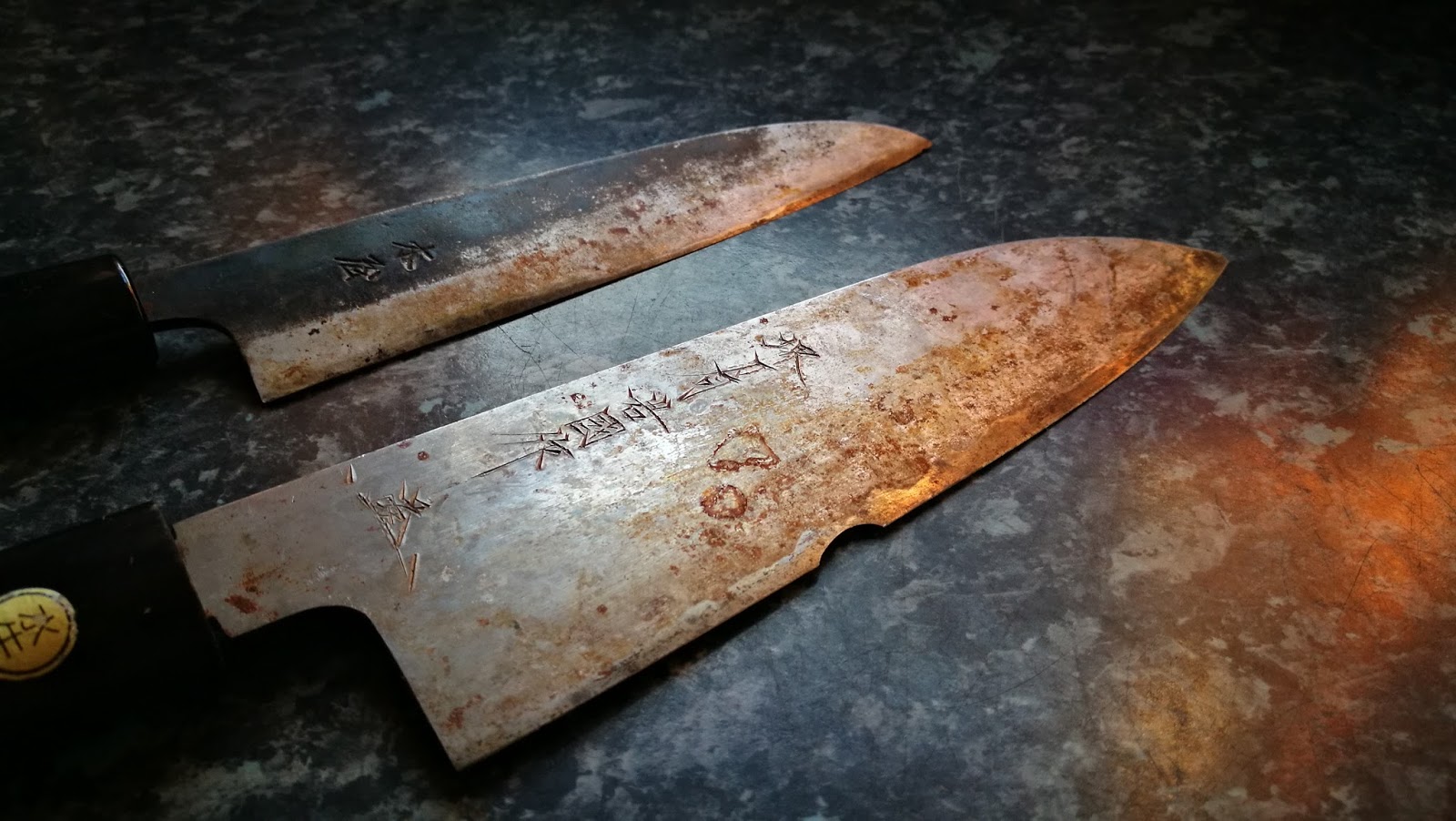

    Both knives together:

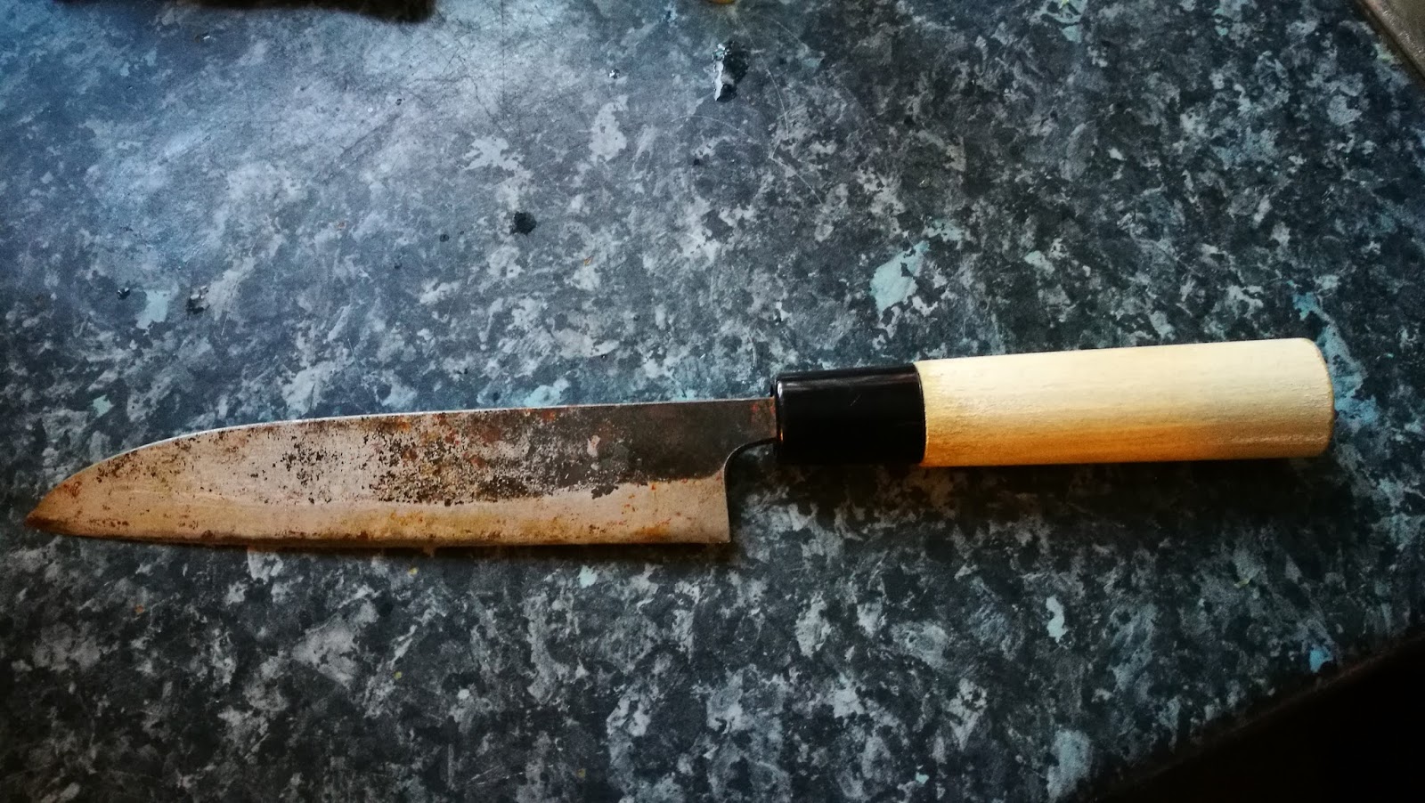

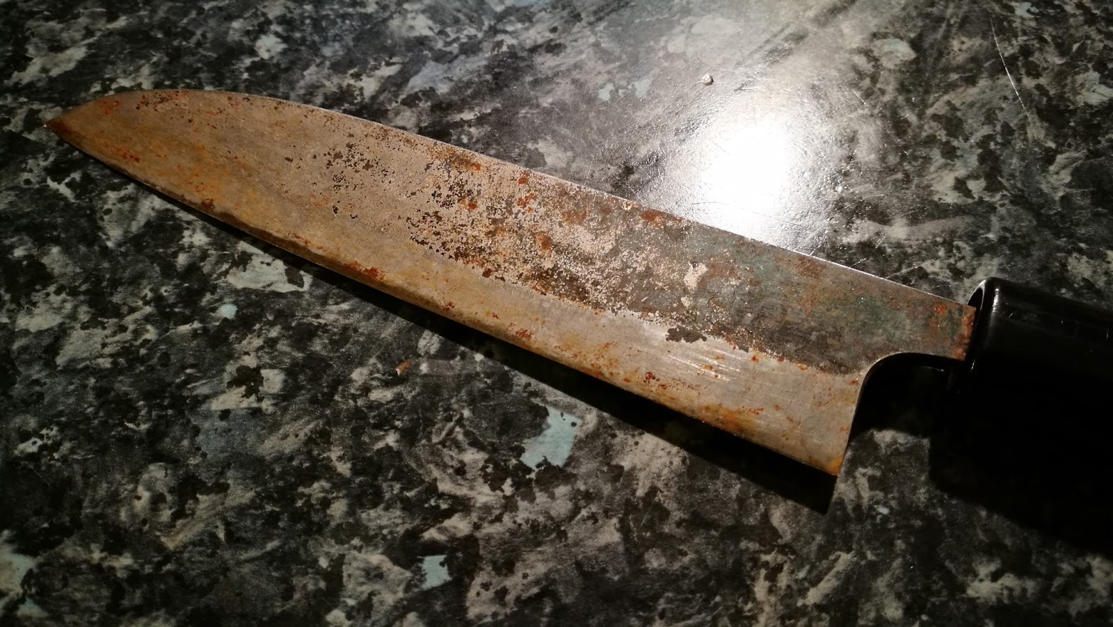

    So let's start from the smaller one. This one should be easier to repair. To be honest, I was only asked to sharpen it, but I did much more. So from what you can see on the pictures it is heavy rusted. There is a kanji on the right side. This knife is quite thick, but I've stropped it and I was amazed that it was actually sharp and that it was cutting potatoes quite well. I will have to ask it's owner who and when sharpened it. There was also a small chip near the tip.
    Here you can see quite thick grind of the blade:

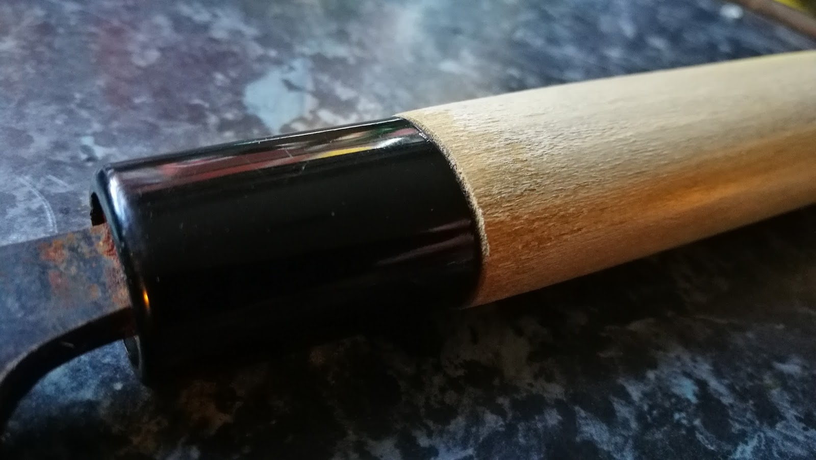

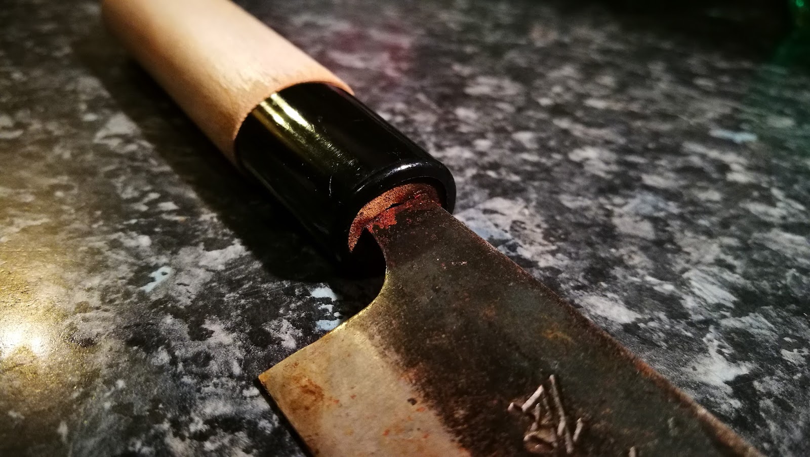

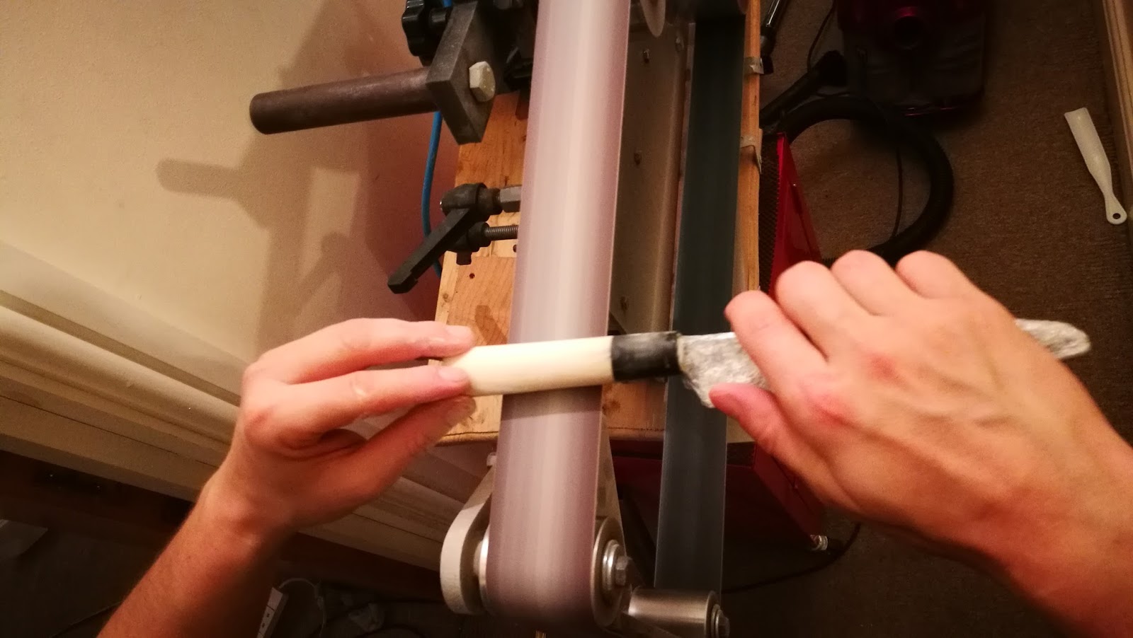

    The handle was of a very bad quality. There was a ridge between the wooden part and the collar.
    It wasn't obvious at the beginning, but after further examination I have found out that collar was separated from the wooden part. Probably it wasn't even glued. I wanted to remove the handle with my usual method of banging the wooden board against the handle with the hammer, but even after very strong blows with the hammer it didn't come out. I assume that it is glued in or it sits there and it's stuck. It's strange because usually traditional Japanese handles are burned in to the handle with the red hot tang of the knife for snug fit. I had to repair it with a handle attached to the knife which made everything more complicated.
    So first thing first, I have started my work from gluing back the collar to the handle with super glue.

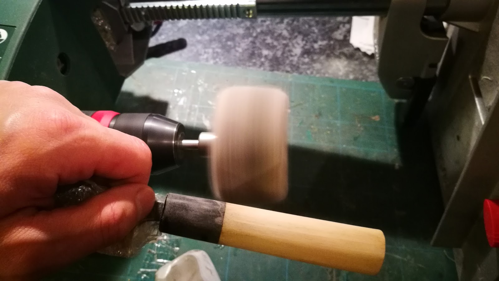

    Then, when it dried out, I have used my belt grinder to remove glue remains and to smoothen out the ridge between the collar and wood.
    At the moment the highest belt grit I own is 320, then somehow I had to bring back the polish. I have used buffing wheels and some compounds.
    This is how it looks at this stage. Obviously later I've applied few coats of Danish Oil and finished everything with Renaissance Wax.

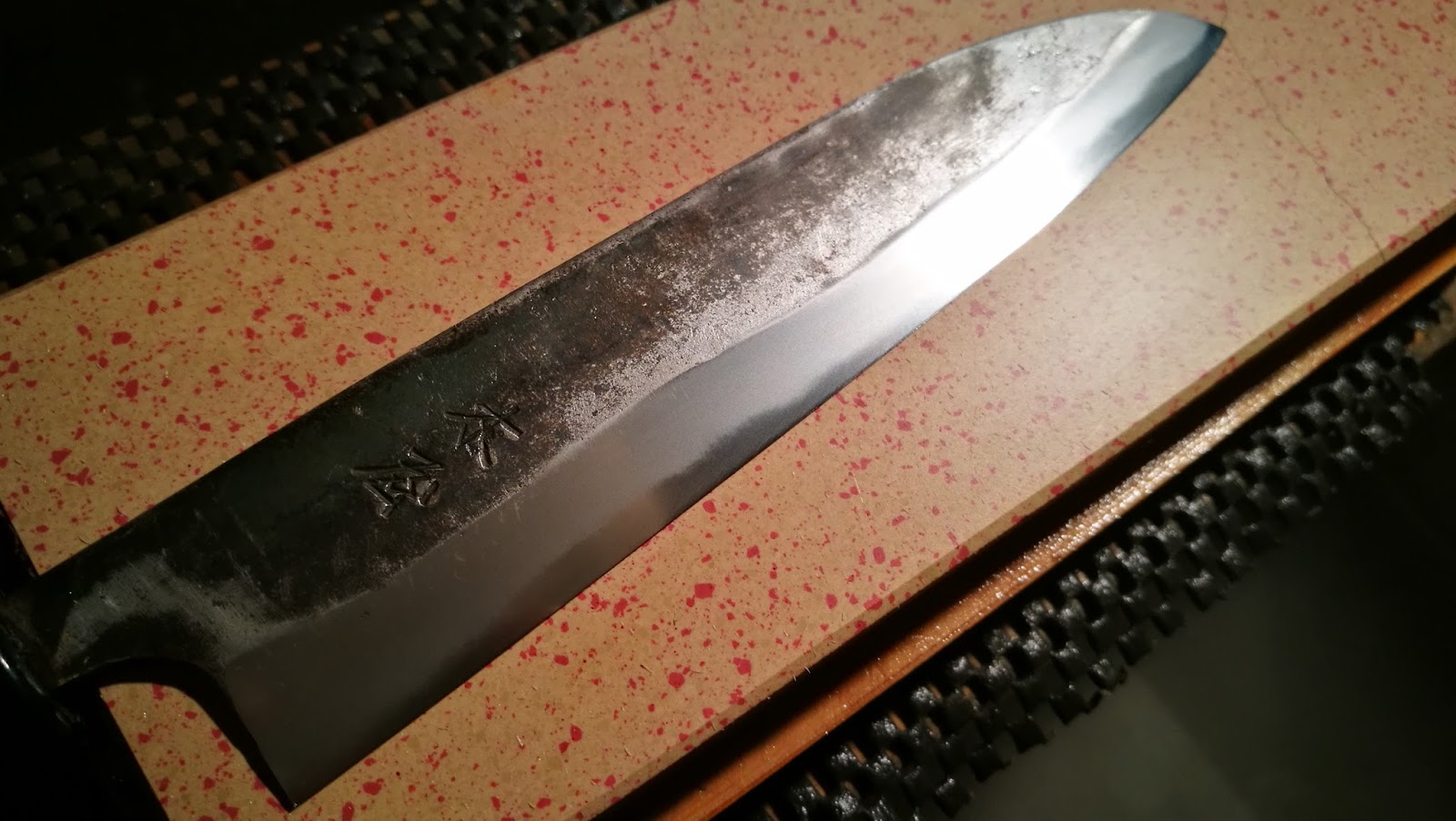

    Now it's time to repair the chip. As usual, I have started from low grit stone. In this case it was JNS 300. It didn't take me a lot of time to find out that the grind on this knife is very good. Obviously, shinogi line is not straight at all, but I think that it was never meant to be that way.
    So, I continued my work on the stones through JNS 300, JNS 800 and then JNS 6000 and finish you can see below is from JNS6k which is laying under the knife on the photo below. I totally love the way this brick is behaving as a polisher especially that it's a synthetic stone.

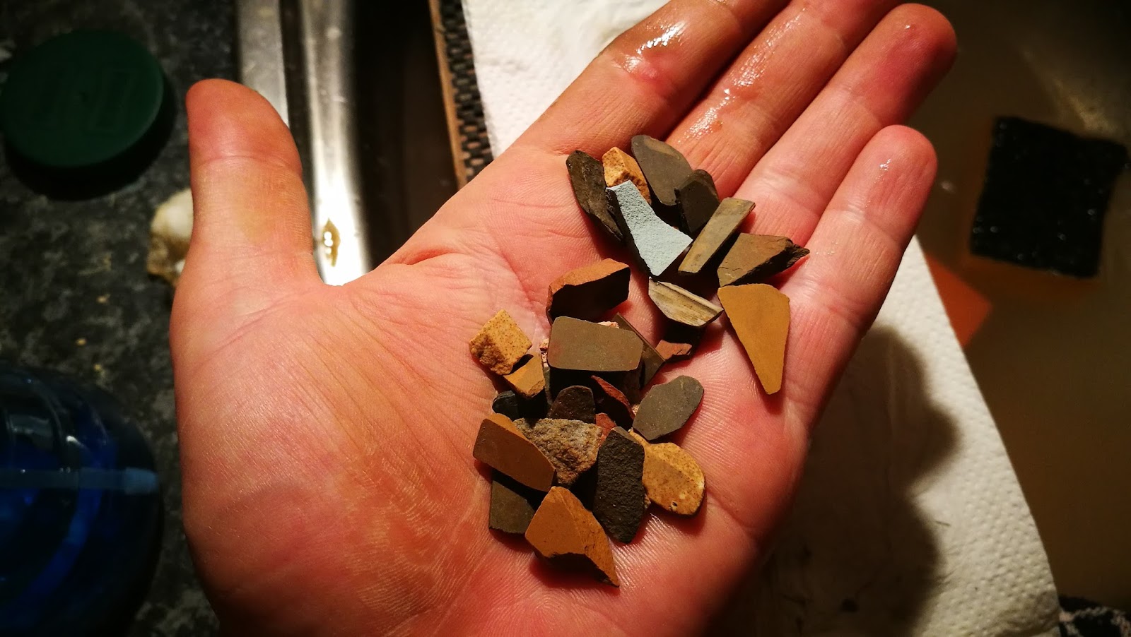

    To finish it I have tried to use different kind of fingerstones coming mostly from natural stones, but you would be surprised how well a fingerstone from JNS6k is polishing that blade (and others).

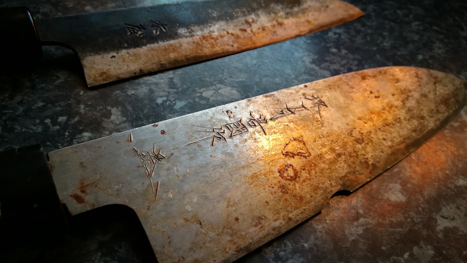

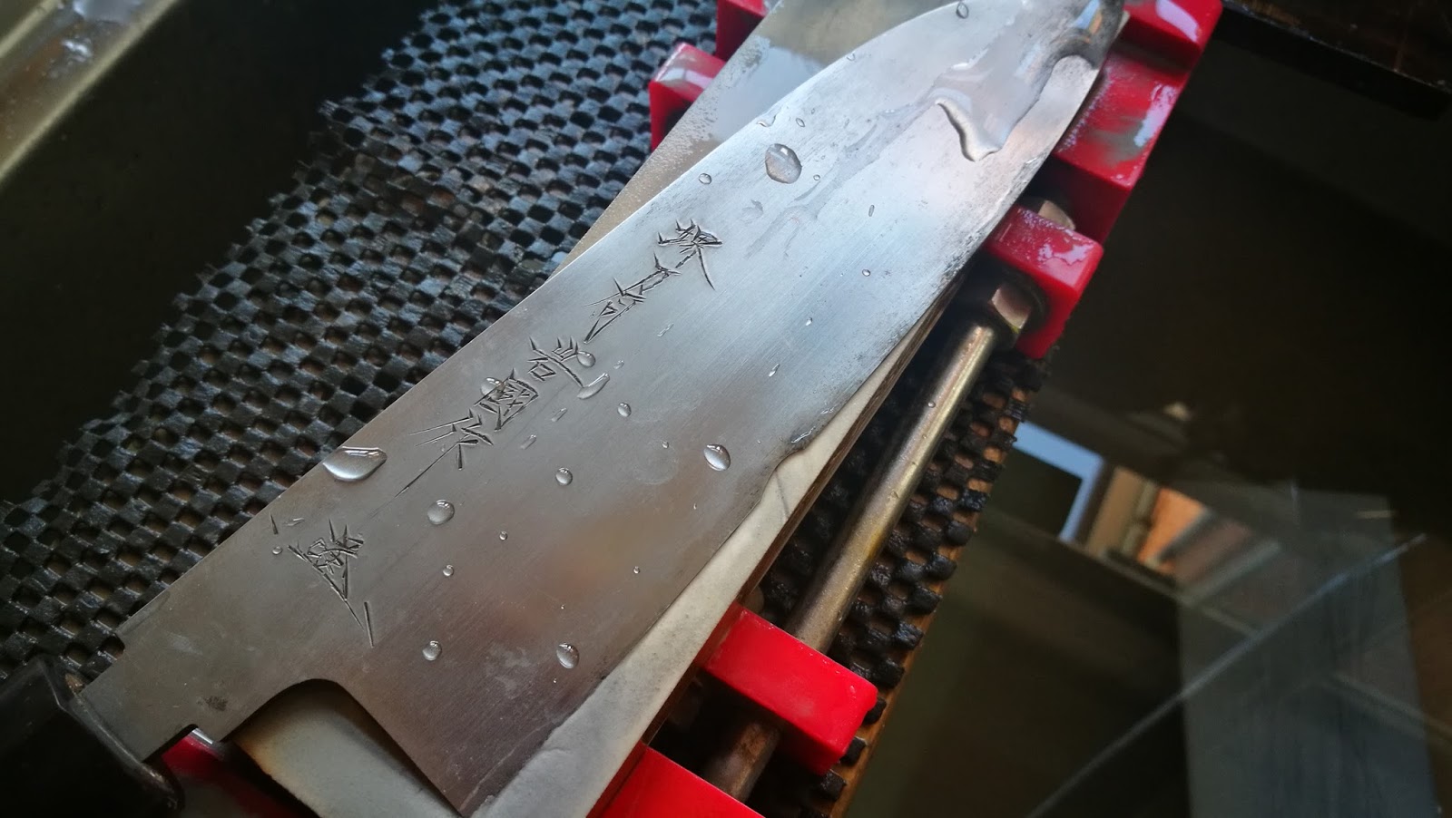

    So now it was a time for the main meal - Sakai Toji Iwakuni 180mm Santoku.

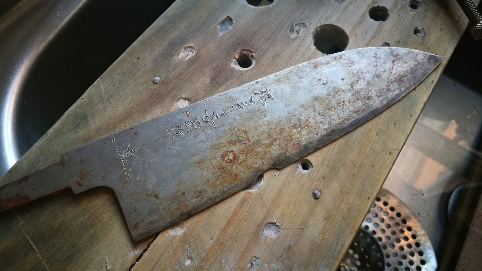

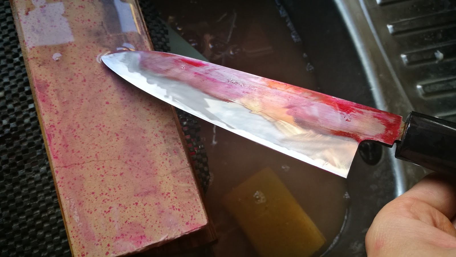

    First thing that is striking the eye is a huge chip in the middle of the blade. Obviously the whole blade was covered in the rust.

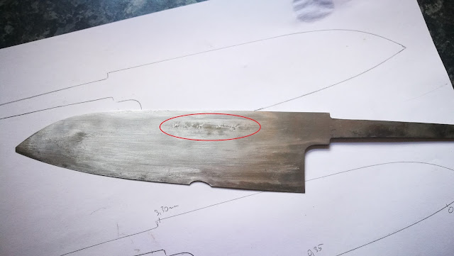

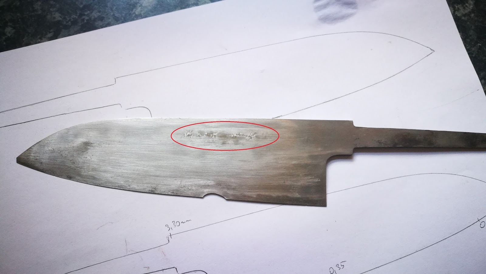

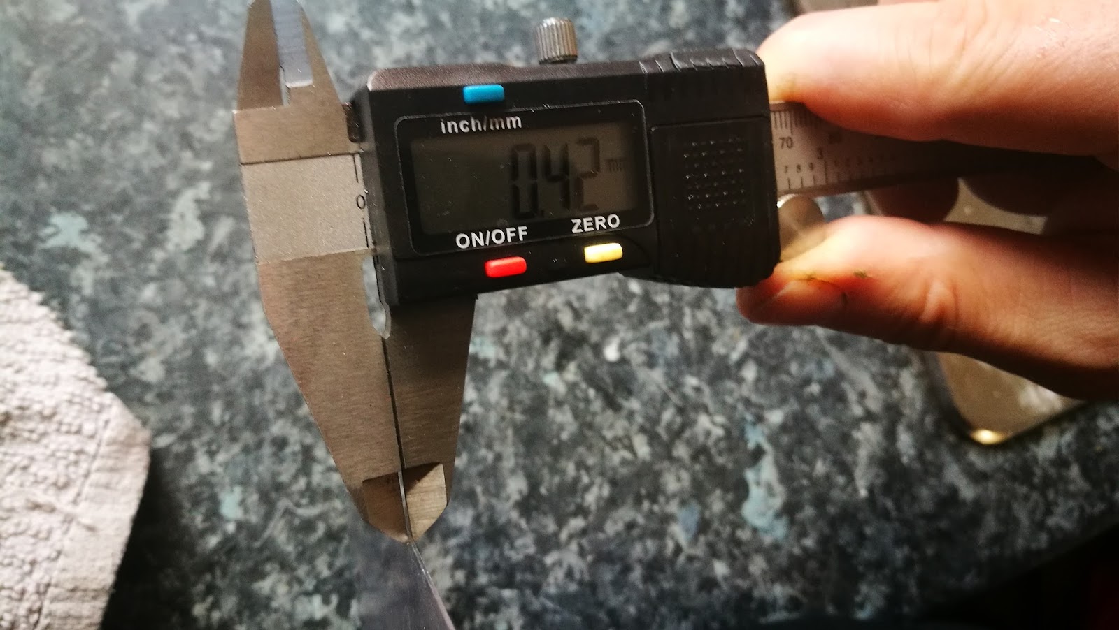

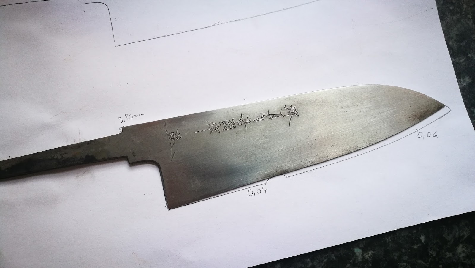

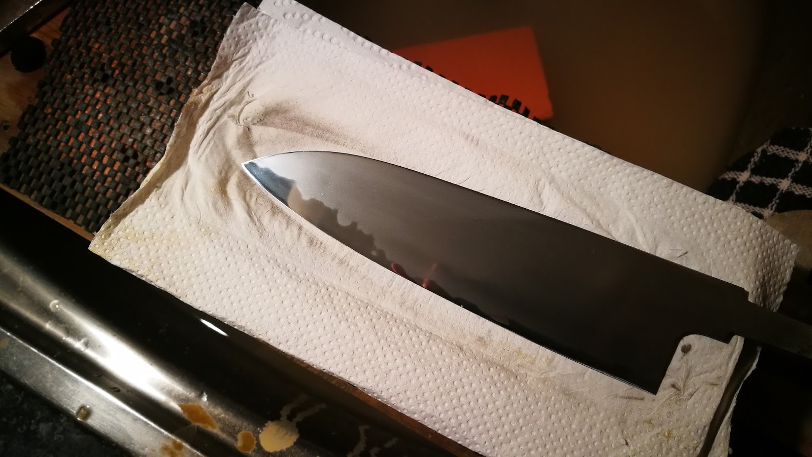

    So I have removed the handle and laid the blade on the A4 sheet of paper to draw the outline of the blade. I usually don't that, but this time I wanted to plan my next steps. I also took some thickness measurements.

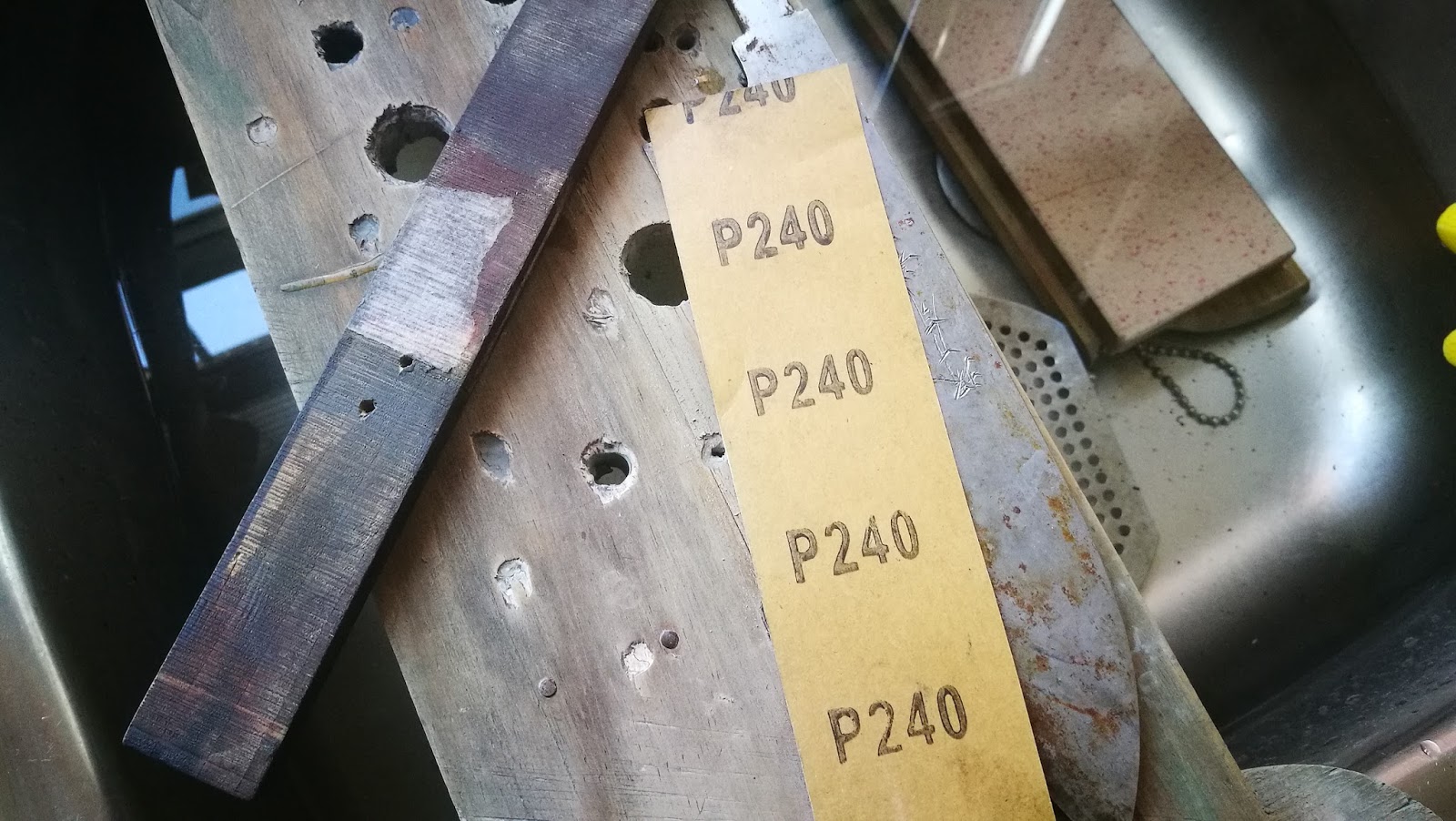

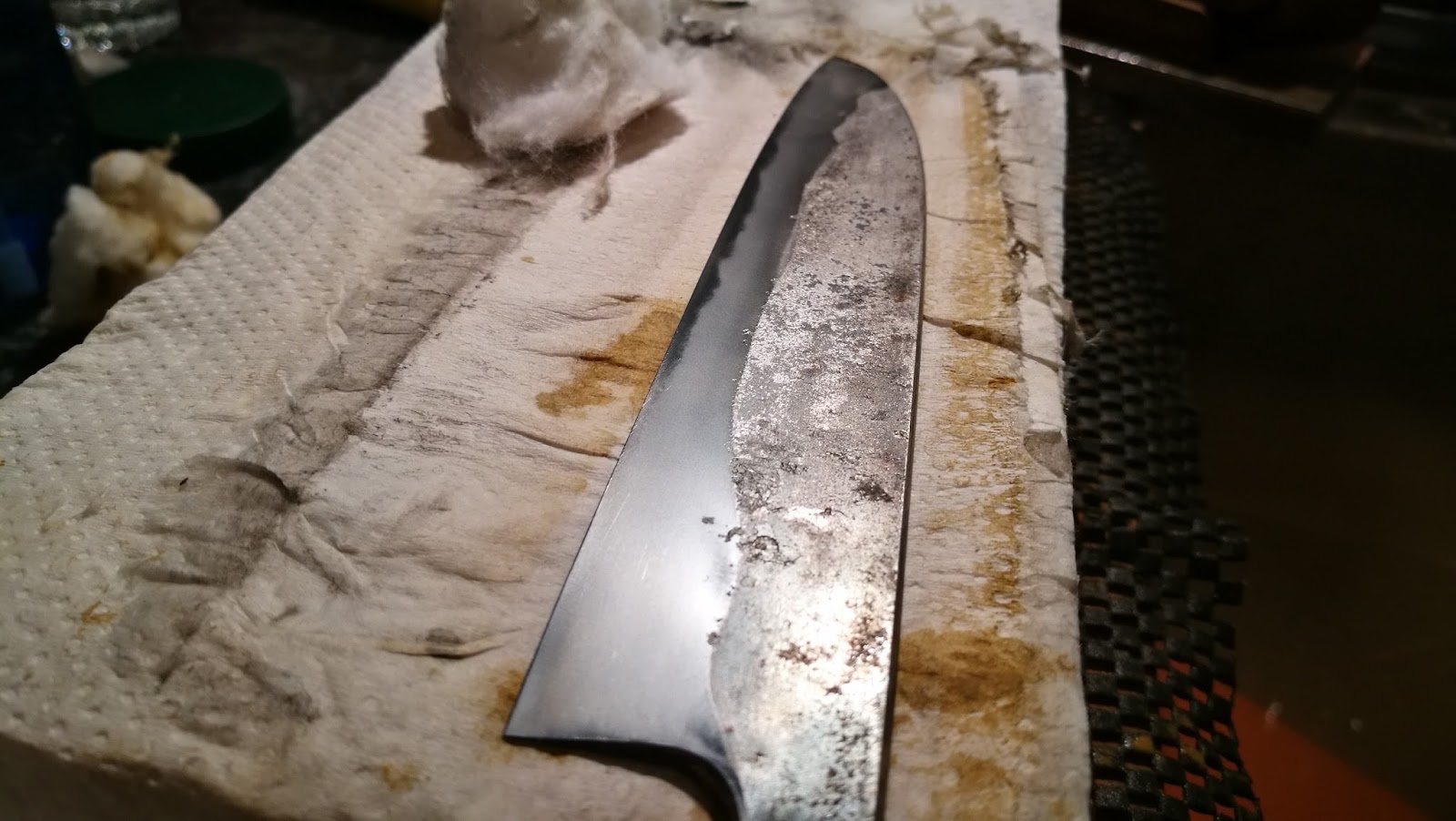

    I was suspecting another problem which could occur, so I started from cleaning the blade from rust with 240 sand paper. You can go lower than that, but I wasn't bothered.
    Here it is, whole naked:D
    I have circled in red, huge low spot with some pitting after rust. I already know that this will cause me a problem in the future.
    I've tried to mark a new cutting edge on the drawing. This is what I have planned to reproduce on the blade. I didn't wanted to touch heel of the blade. The blade can be pointy in the front, but it's always better to have taller blade near the heel.

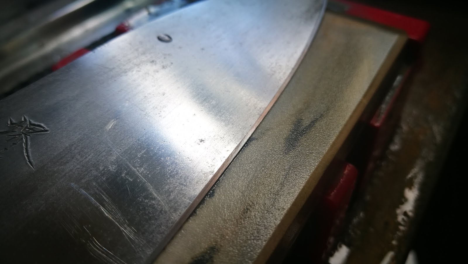

    I could do that quite quick on the belt grinder, but I wanted to do everything on the stones. I was cutting the stone like one is cutting the bread.
    In the middle of work:

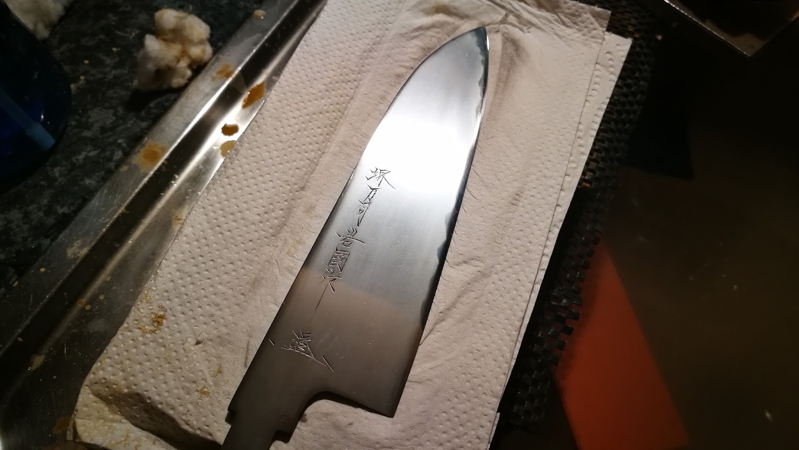

    Here you can see almost finished work. I have managed to follow my plan.

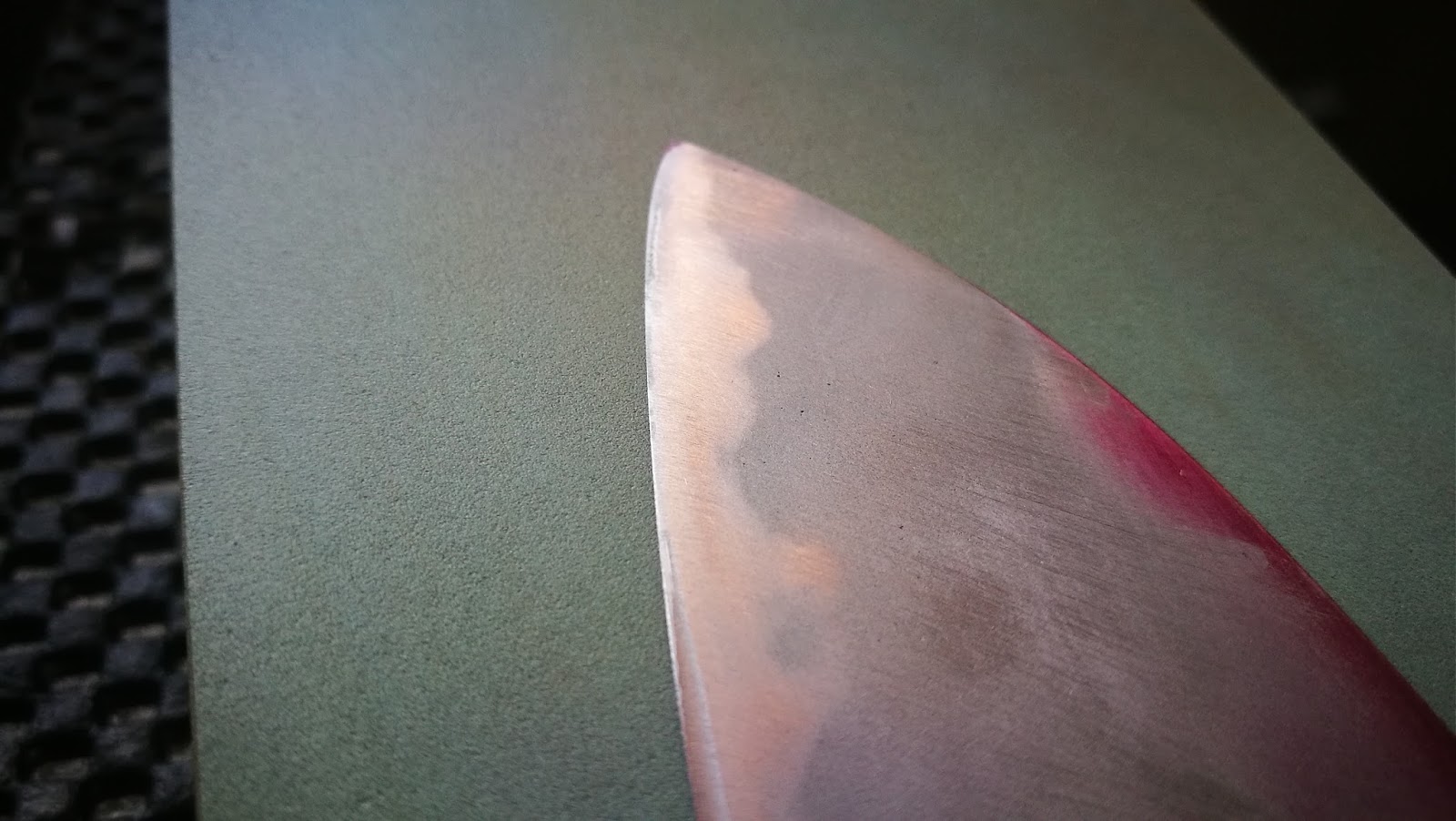

    As you can see on that picture the blade became very thick. The small chip is still visible, but it will fade away in the next step.

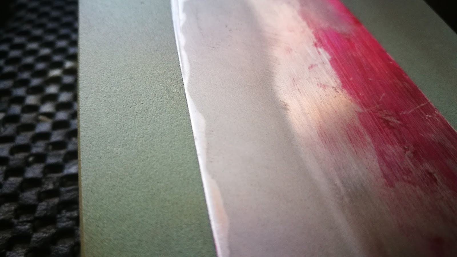

    Below you can see the new edge. I have settled a new bevel only as a reference. It would be a big mistake to leave it as it is, because now, this knife is too thick behind the edge and it won't cut good.
    It's time for the next step - thinning..

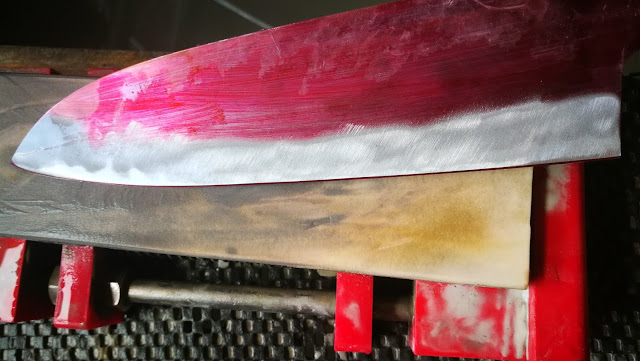

    To do that I took the coarsest stone in my collection. I don't exactly now what is that but it is rough as hell, it's feedback is very unpleasant and it drinks more water than me on the hangover. I believe that it could be Cerax circa 120 grit grit or similar. I just didn't want to waste time.

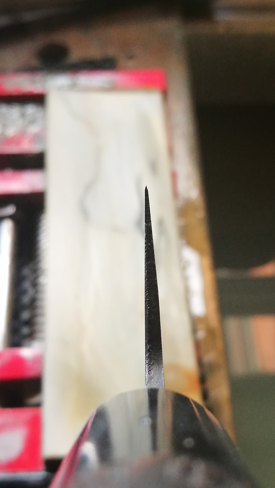

    Another serious problem which appeared after repairing that chip was that I had to grind a lot of metal which caused Hagane (steel) to be not exposed anymore and only Jigane (iron clading) to be seen. That is wrong because we can't sharpen iron. Thinning is a great solution for that, but the question is how far can we go there? I went as far as I thought is needed. Thinning is a good thing, but once metal is taken away, it cannot be brought back.
    Fortunately, the grind on that knife was leading me.

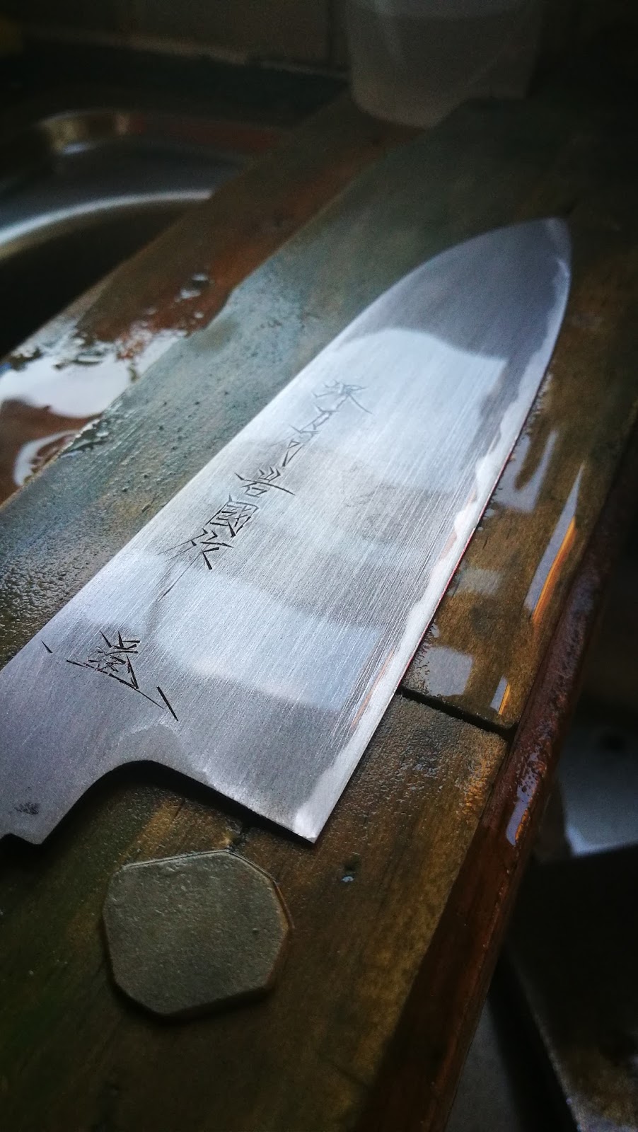

    From time to time, I was putting pressure towards the edge to make convex on the blade road.The principle is same as sharpening Hamaguriba on the single bevel knives. It's about the pressure and it's placement.
    Here it is after 300 grit stone. If somebody ask me then it is a JNS 300 prototype. I am not sure how many people in the world own a stone like that, but I am one of them. I really like that stone. It's huge, about size of JNS800, it's a thirsty soaker and it's damn good.
    Here you can exactly see how close is the iron to the steel. I had to lift it even higher, because after few sharpening session someone would hit the iron.

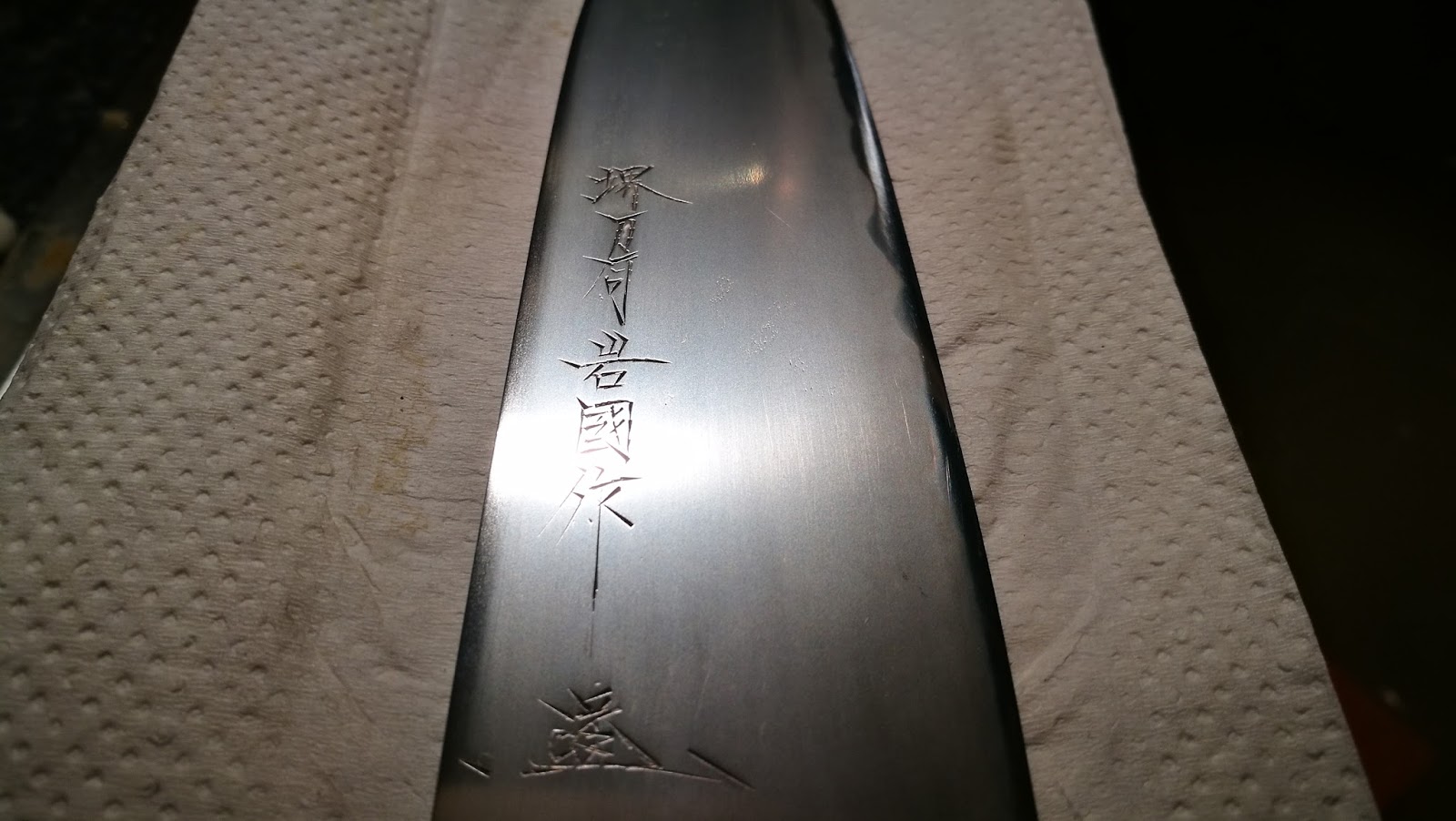

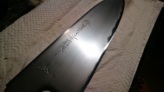

    I wanted to refinish it on the stones. I really don't like to work with sanding paper, because it's taking ages and I believe that stone finish is better than sanding paper one. My way of doing that is to lay a knife perpendicularly to the stones and to grind in the same direction. This way, vertical scratches will be made on the blade.
    Vertical scratches on the whole surface of the blade.
    Of course everything has it's pros and cons. Do you remember big low spot I was talking before? Now it will be very visible. Of course, one of the solutions is to grind the whole blade to even it out, but as I said before there is no practical reason to do that. It (low spot) won't affect cutting performance.

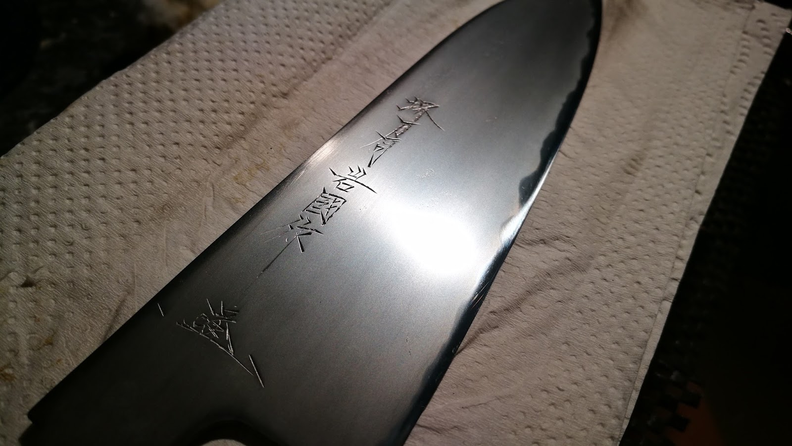

    I have used coarse fingerstone (I believe that it is made of JNS300) to polish it along the length of the blade.
    It's starting to look good.
    And then I continued the same with JNS800, Red Aoto, JNS 6000 and finished everything with Takshima fingerstones.

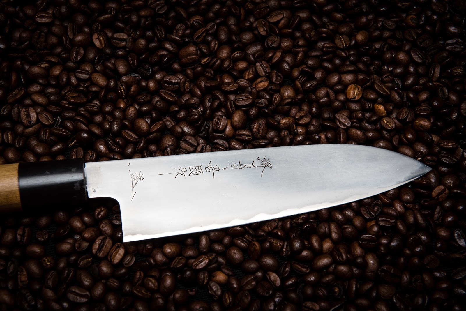

    How do you like it? I am pleased with the finish like that.
    JNS 6000 when used properly, or best as a fingerstone, can give you very nice mirror polish. Unfortunately, it is very hard to take a photo it.
