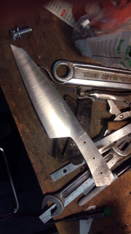

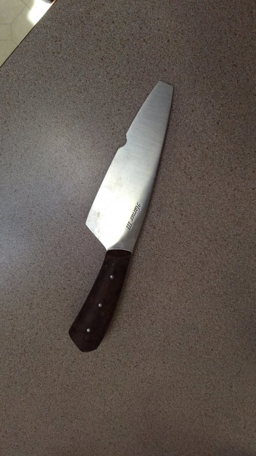

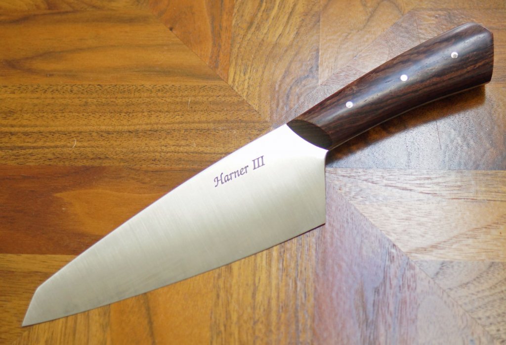

    jsut a quick blade fix up
    16904689_1857094687895539_4771099407962332089_o.jpg 16991555_1857094774562197_9083886976592798577_o.jpg DSC09086sm.jpg
  2. Great! Now it's a K-tip. One question Butch, how do you take the western handle with pins out without breaking it? Or did you make a new one altogether?
  3. butch
    because i use pins and not stepped or domed screws i can center punch the pin and with a pin driver carefuly drive the pins out most the time i cna get them out ok ) then i have to hammer the scales off cause of the epoxy dependingon the wood and how much side load i have to put on the scales. scales on this one jsut were not good to be reused so the walnut burl is gone in place now is cocobolo. my WA handles on the other hand must be sawed off and are completely trash once removed
