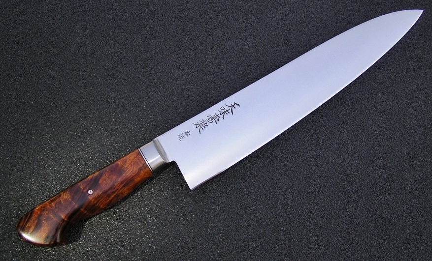

    Here's a 240mm Hiromoto Honyaki that I just finished up working on.
    The blade was initially pretty rough finished. I started by re-sanding and polishing to a "high satin" similar to what I do to my own knives. As you turn the blade in the light you can see the hamon now. I also rounded the spine and choil for comfort.
    A conversion from full tang to hidden tang was done and then an AZ Ironwood block installed in place of the pakkawood scales. A couple of spacers were added between the bolster and wood for accent as well as a copper/nickel silver mosaic pin installed.
    The ironwood is some of the very best I've worked with, and oddly it's some of the least expensive! I'm not complaining mind you. The handle has been treated with 12 coats of my varnish finish.
    This knife is headed off to OZ, and hopefully, to a happy new customer. [​IMG]

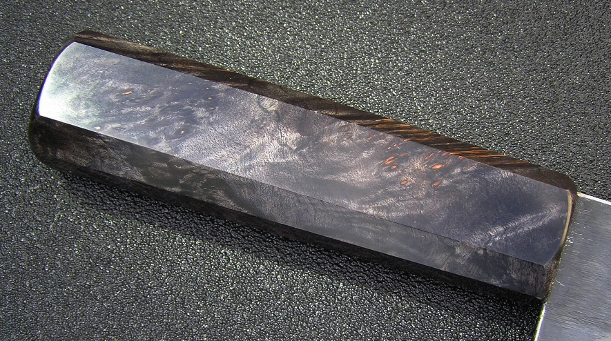

    Here we have a brand new Watanabe (suminagashi?) suji with a handle made out of ancient bog oak (carbon dated at 3400 yrs old!) paired with streaked blond buffalo horn. A simple handle, looks very similar to a Japanese ebony handle, a clean design by the knife's owner.
    The bog oak is some of the oddest wood I've worked with. This particular block was VERY hard - like a rock, it was like shaping glass! It's strange to be wet sanding at 2500x and feeling grit (like little pieces of sand - minerals?) falling out of the block and rolling around under the wood. [​IMG] Very little scratching happened though - again - odd. I believe what you see in the pictures as little shiny flecks are these minerals in the wood.
    I took the liberty to fill the heavy open grain with drying oil prior to finish sanding and applying the finishing coats but the handle had a glass like surface before I even put any oil on it, I just made it more even.
    Picture taking of this handle proved to be the biggest challenge of all, see for yourself... [​IMG]

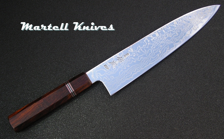

    Here we have a 240 mm Sukenari ZDP189 damascus clad gyuto with a brand new handle made out of desert ironwood and an 11 spacer stack of copper, nickel silver, & G10 spacers.
    What do you think?
    Martell_Knives2.JPG Martell_Knives7.JPG Martell_Knives11.JPG Martell_Knives12.JPG Martell_Knives13.JPG Martell_Knives15.JPG Martell_Knives16.JPG Martell_Knives19.JPG
