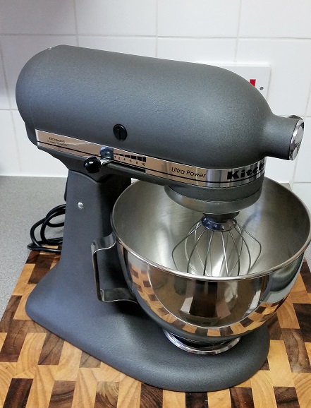

    So on my usual travels around the local pawn shops I found a NOS KitchenAid Ultra Power Mixer, looked great, all boxed and unused.
    A look at the packaging revealed signs that some kind of oil had run onto it, so then I looked even closer at the mixer and could see a very small amount of oil around the seam between the top and bottom of the motor housing, so after pointing this out and getting the price down even better than it was originally, I took it home!

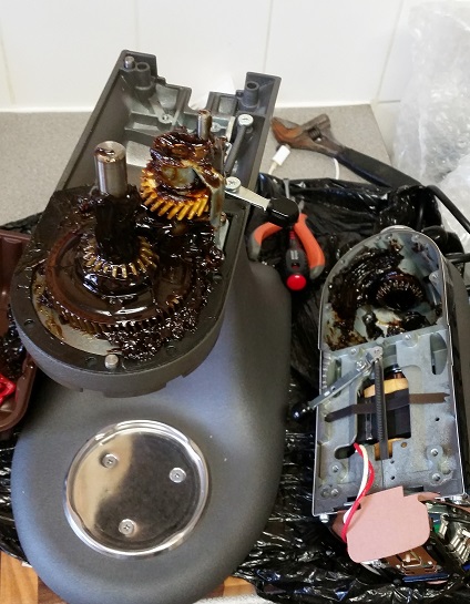

    I guessed it would be the original grease had separated due to lack of use, so started to strip the motor/gear housing down, I had already started by the time I realised you guys might like to see some pics:oops:
    I am sure some of you might have been inside one these before, but here's a few pics and brief description anyway.
    After removing 4 screws under the body and 5 screws and a pin holding the planetary section I was able to separate the motor housing.

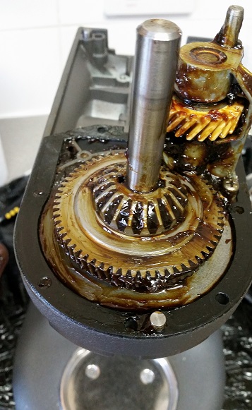

    I was relieved to see the original grease had indeed separated and become a thinner oily mess in places. This is after removing most of the grease.

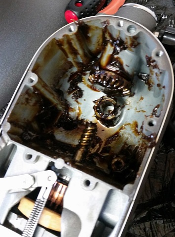

    A lot of the oil had run down into the bottom of the housing, again this is after I had removed the bulk of the grease.
    Cleaned a lot of the grease off and got all the oily stuff removed.
    I was surprised at the amount of grease these things have in them:eek: I tried to put back a similar amount to what I had taken out. Looks a lot, but that's about what was in there!
    The gasket was fine and it was leaking elsewhere anyway, these are just not meant to have thin oily stuff in there, hence the big dollop of grease!
