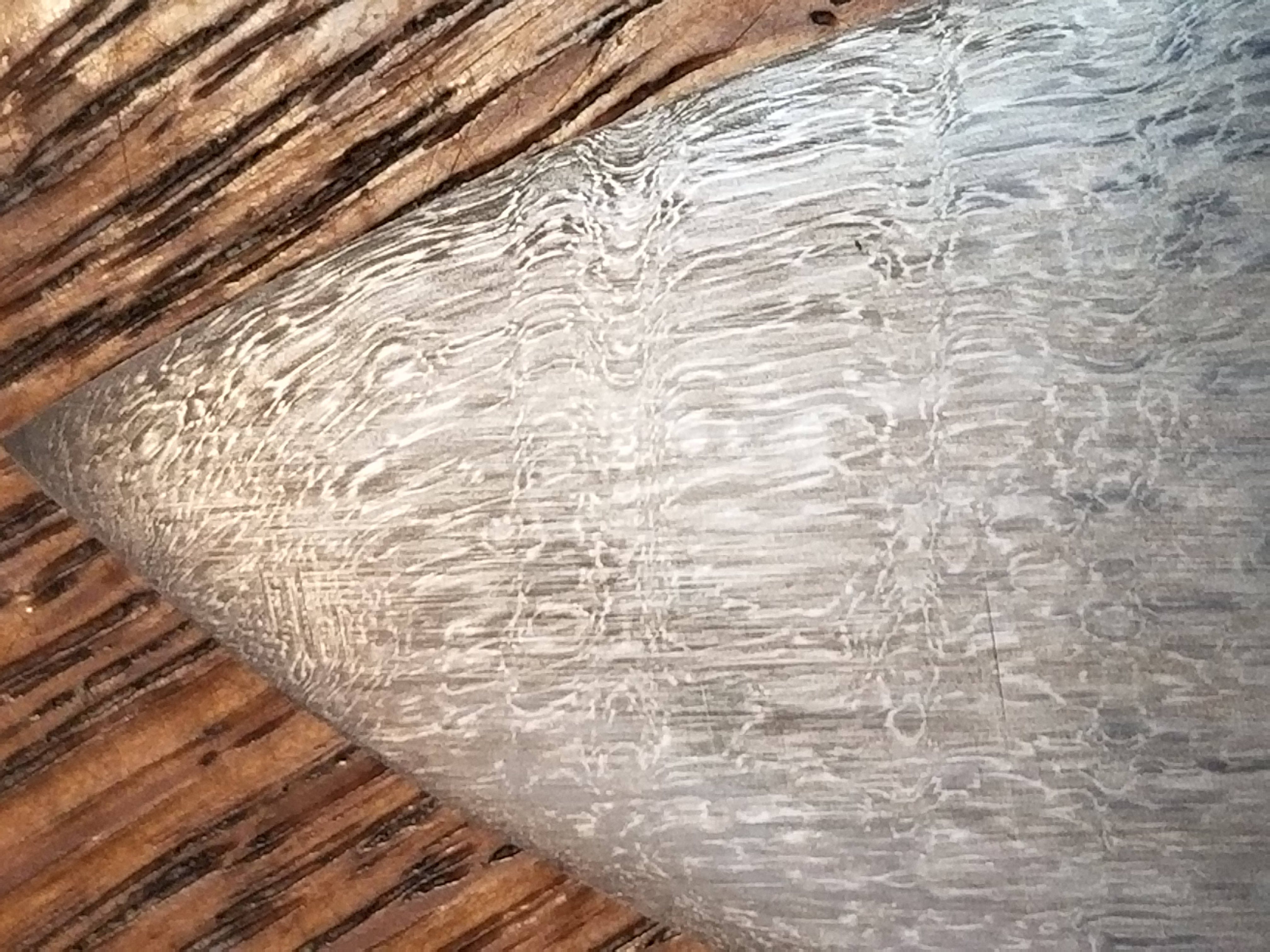

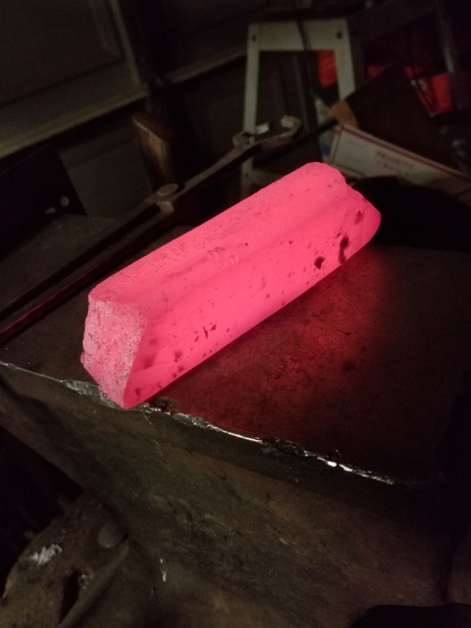

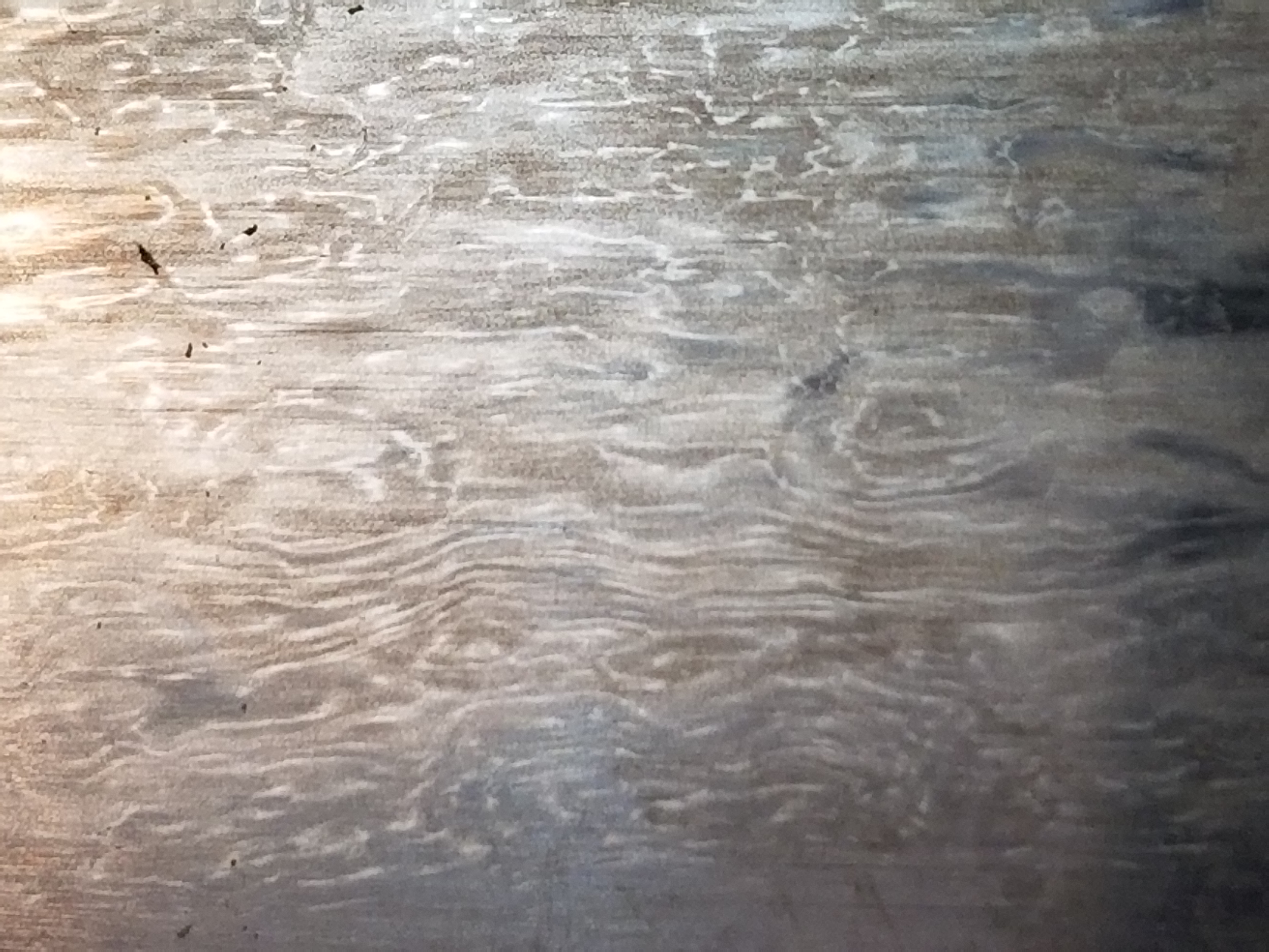

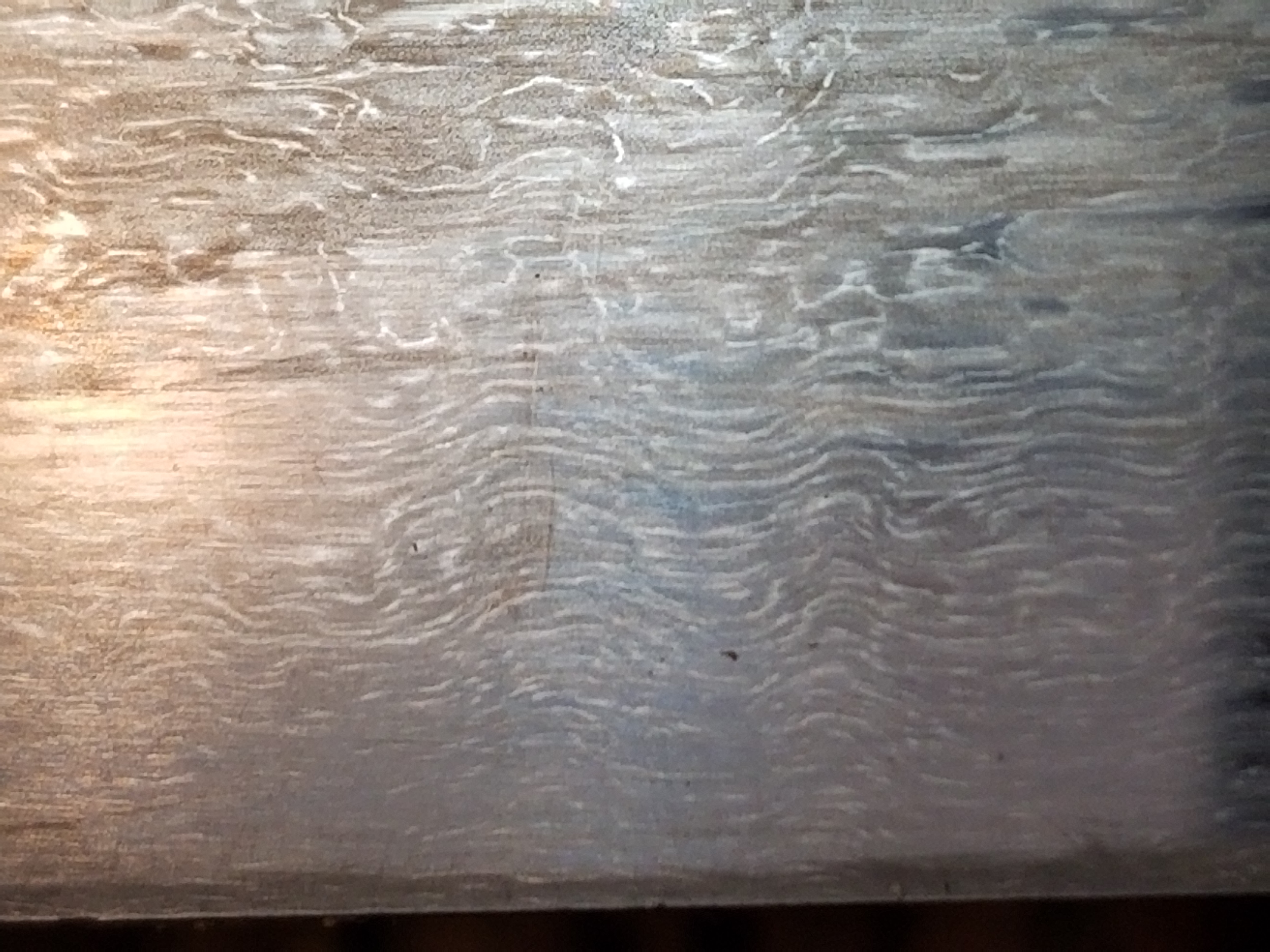

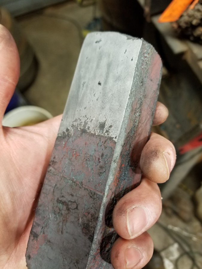

  1. I have been a busy bee. Unfortunately metal research and practice takes time away from knife making. It serves the act of in the end, but theres usually a long time of figuring things out when developing skills with steel. In my case, steel making. My latest crucible steel ingot made from my orishigane melt material, forged correctly to induce watering pattern of cementite.
    Samples of this ingot, and various steels i make are currently being tested for composition, and viewed under a SEM (scanning electron microscope), to be scrutinized bu engineers to prove or disprove the hypothesis of a few students at a lab.
    My own findings are that the steel is at least 1
    6% C.

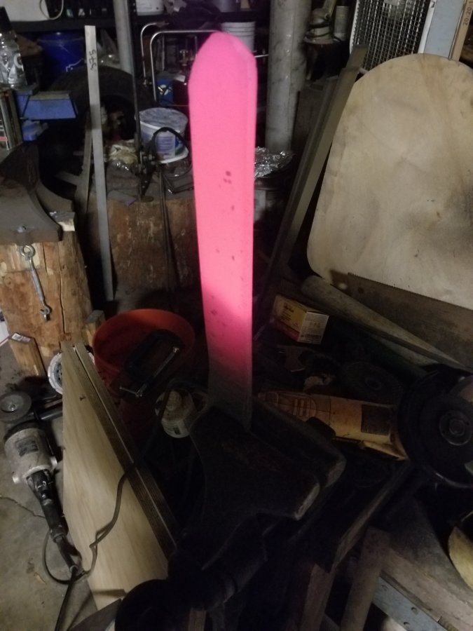

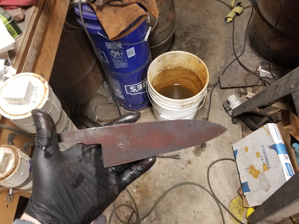

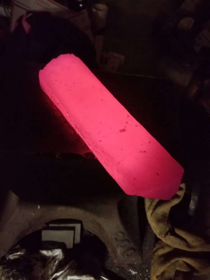

    Also, keep in mind that from start of forging to knife blade took around 40 man hours at heat, with precise control of temperatures at all times, with precise blows from the power hammer. Any deviation from small temp. Windows or strength of forging can result in broken and cracked steel, or no pattern at all.
  2. [​IMG]
    That is some love in the forge!
    40 hrs at heat seems so long... but the proof is in the hand.
  4. For any other material this is true. For crucible steel, it is simply part of the process. Cant really go any faster, lol.
