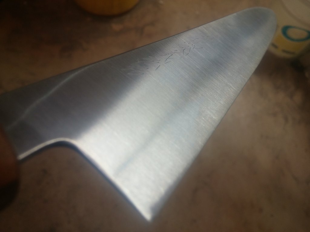

  5. CrisAnderson27
    Butch has that stuff down for sure. I've used the scotch brite belts, though I never thought to load it with compound. Butch, which belt do you prefer to finish with? I have the medium and fine...need to pick up an ultra fine still. The medium is pretty freaking coarse in its own right.
    This is the machine finish I was able to get with just the fine belt (maroon color), after the wet norax. Also note I was more 'blending' the very deep factory scratches, versus removing them and/or applying a completely new finish as I would with a new knife or a 100% refinish.

  7. CrisAnderson27
    Yep! I think that's the 'fine' one, if it's the supergrit brand. They only sell coarse, medium, and fine. If you get the 3m brand you can get up to ultra fine. I need to order a set of their own brand. It'd be awesome if it fell in between the 3m ones in effective grit. right now, the fine grit one won't remove the medium grit one's scratches.
