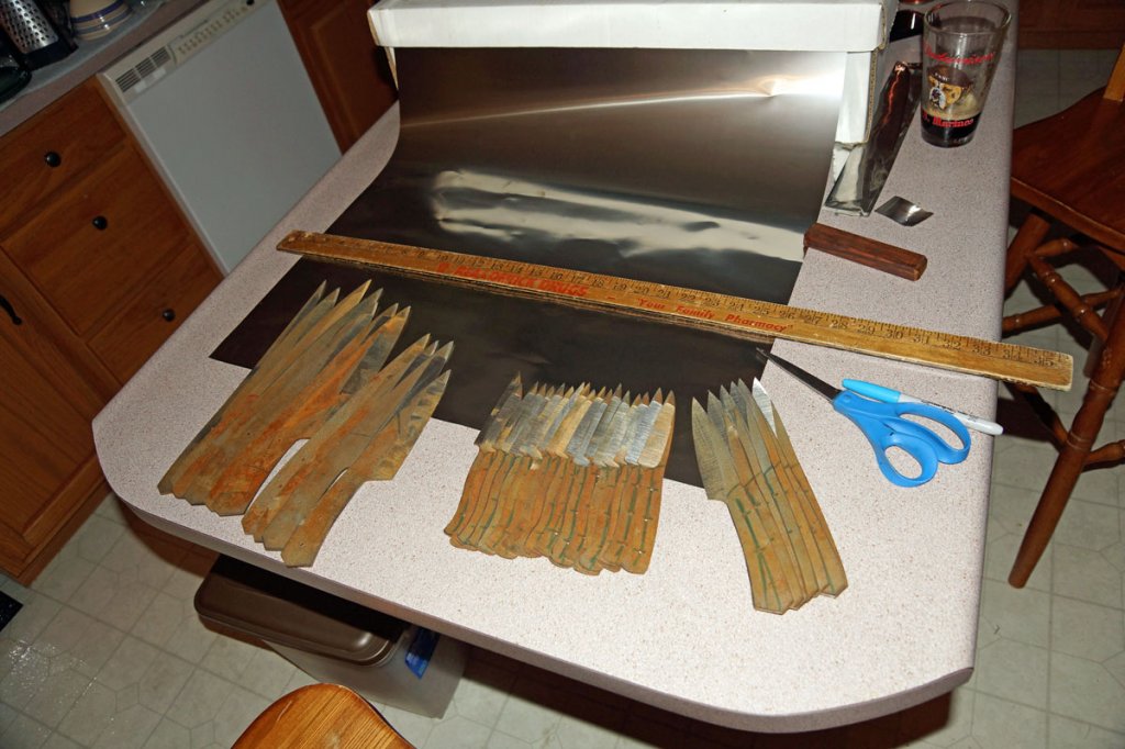

    eye doig much better. last night while wrappingmore blades for heat treat found out my roll of foil is empty so its reorder time (i order SS foil 20"x100' ) you can use that stuff up faster then you think
  13. butch
    local tool and die shop tossed me a bone and let me buy 6 feet of foil but that still didnt cover all the knives i had ready for HT. it did i think get all the line and mini chefs in the kiln (4 batches heat treated since last night ) all blades are in LN right now and in the morning i will start tempering. i hope to get a few of the progress pics loaded tonight

    lefty next i ll have to have a folder on my site for you to load your pics to for ease of posting. i have a few more pics but they are on my phone and not all that great. all the frosty blades in the picture above are in the kiln at 400f for the next 2 hours. i will be pulling them all out and letting them get to room temp then back in the kiln at 400 for another 2 hours. next week when i get back from a bit of time off i l be grinding full speed ahead.
