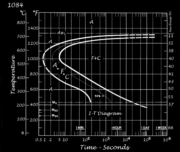

  4. Being eutectoid it's going to heat treat pretty simply. What are you using for a quenchant? And what 'goo' did you use for your W2 lol? Pictures of both would be awesome, just so I can see how your layout was etc.
    Honestly, it's going to heat treat a lot like W2 to some extent.
    Tempering Temperature and resultant Rockwell Hardness
    °C - °F - HRC
    149 - 300 - 65
    177 - 350 - 63-64
    204 - 400 - 60-61
    232 - 450 - 57-58
    260 - 500 - 55-56
    288 - 550 - 53-54
    316 - 600 - 52-53
    343 - 650 - 50
    ^^^^^ is pretty much everything you need to know. Heat to 1450°F-1500°F, let soak about 5 minutes (not necessary with this steel, but I like to make sure everything is in solution), quench into canola oil.
