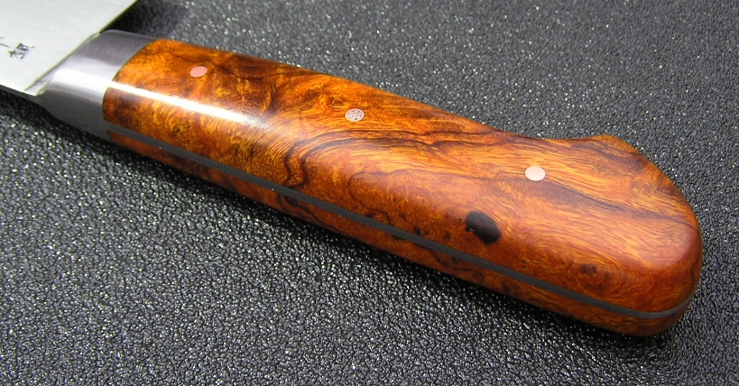

    It's blade has been thinned, spine/choil rounded, & etched for effect. The handle has been converted from full tang western to hidden tang hybrid wa. The wood used is Ipe burl.
    This knife gave me fits! From the wood (Ipe - never again!) to the etching, nothing went easy. In fact this Hiromoto took more than twice the amount of labor than the next worse one ever done. I can't say that I'm happy with the wood, its just not really that nice, but the blade finish I ended up with is the finest I've ever done on one of these knives. The scratch pattern is tight (running horizontal), is bright, and slick as snot....what else could you want? [​IMG]
    I hope that the owner has more fun using it than I did working on it! LOL Still I'm grateful for the work and the experience, I learned a new trick or two on this one.
    What do you guys think?

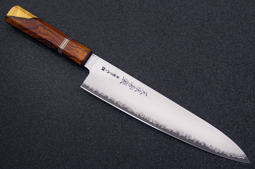

    Here's another Hiromoto AS that's just been through the spa treatment except this one had some additional work done to it. :cool:
    This knife belongs to an old friend from back in the KF days. It's always both nice and a bit stressing to work on a friend's knife because my expectations go even higher than they should and I almost never meet them but in this case I exceeded what I hoped to accomplish so I'm actually happy for once...LOL
    The knife came to me as a metal bolstered western configuration that I was tasked to convert to a bolster-less octagonal wa configuration so I ground off the old handle and metal bolster and made a new handle for it.
    The wood was supplied by the customer, it's desert ironwood with sap wood. He asked me to include as much sapwood as possible and I worked to do this as best as I could. He wanted a metal spacer stack so I put together an 11 piece stack consisting of copper, nickel silver, and G10 spacers. I really love this handle a lot, it's one of my favorites that I've done.
    I hope you like it as much Jay! :)
