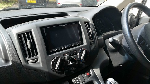

    First I removed the head unit and replaced it with a Pioneer Avic-F70DAB unit, nice bit of kit, Sat Nav, Android Auto, Apple CarPlay etc etc.
    The bottom tilts out when you switch it on so it matches the angle of the dash better than in the picture.

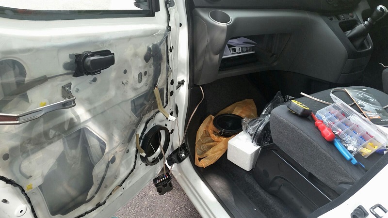

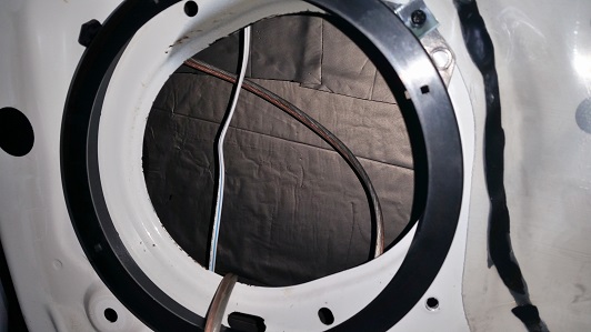

    Next I removed the door speakers, just single 2 way speakers in each door, not a great sound!
    Added some sound deadening in each door

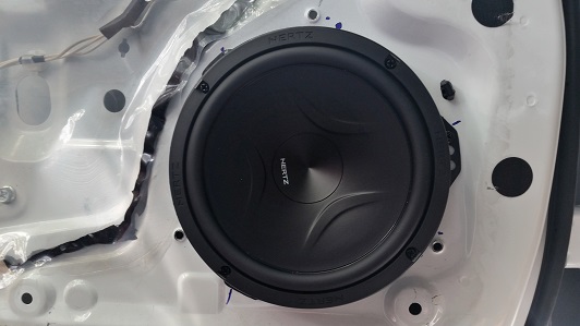

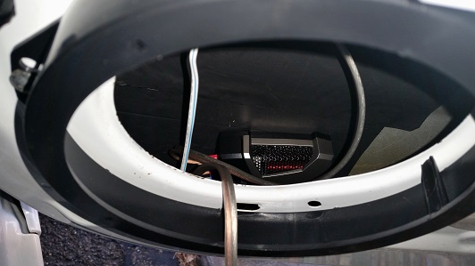

    Then fitted the speaker mounting adapters and wired in the crossover units that came with the speakers.
    Then fitted the main 6.5" speakers, I went for a set of Hertz Energy ESK 165.5 components.
    Had to mount them with the logo sideways to stop the connectors on the back fouling on the door, they wont be visible so no issue there

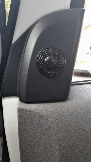

    Then drilled a hole in each internal mirror cover for the tweeters

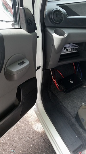

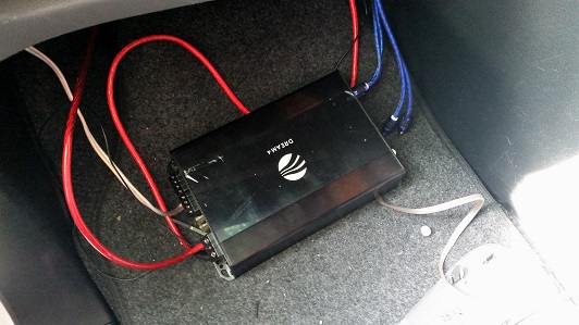

    Next up I wired in the Rainbow 4 channel amp and tested everything before fixing it in place up under the dash out of sight. Nice compact amp, but great sound and decent power, 90w rms per channel for the door speakers and 250w rms bridged for the subwoofer that is going in soon.
    Refitted the door panels after testing it all.
