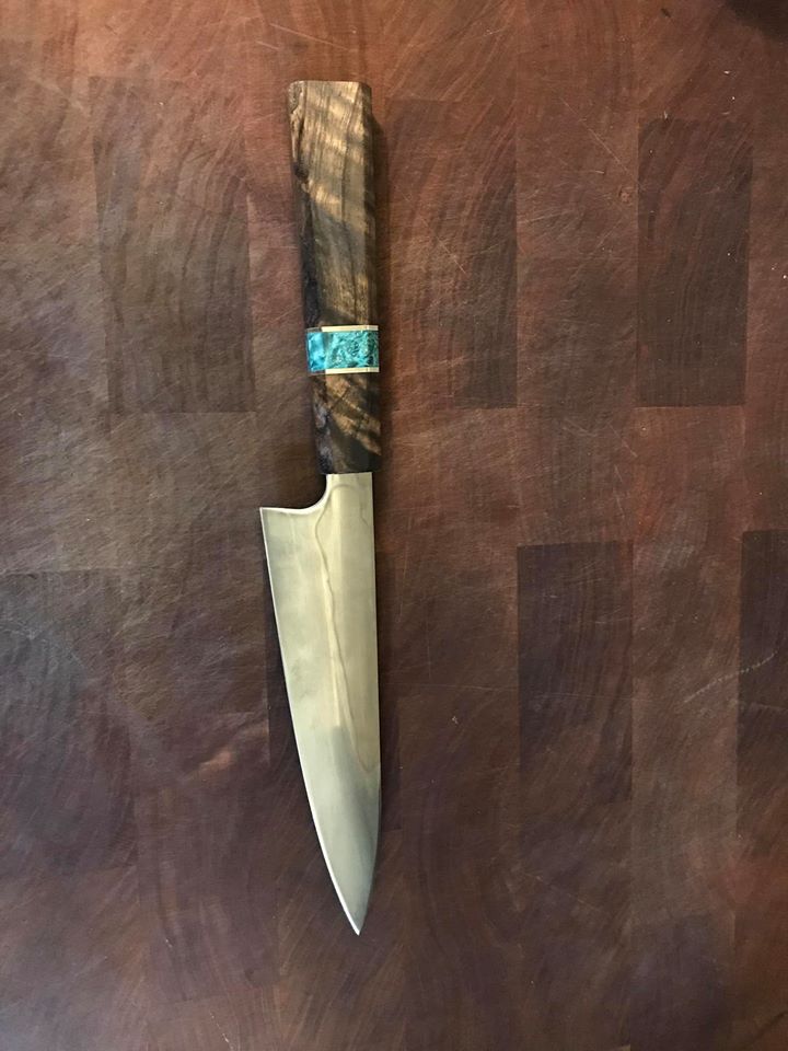

    Was able to heat treat and start grinding on a new knife today. Steel is 26c3 hardened to 65 hrc. Looking forward to finishing and playing with this one. I'll post more pics when it's finished.

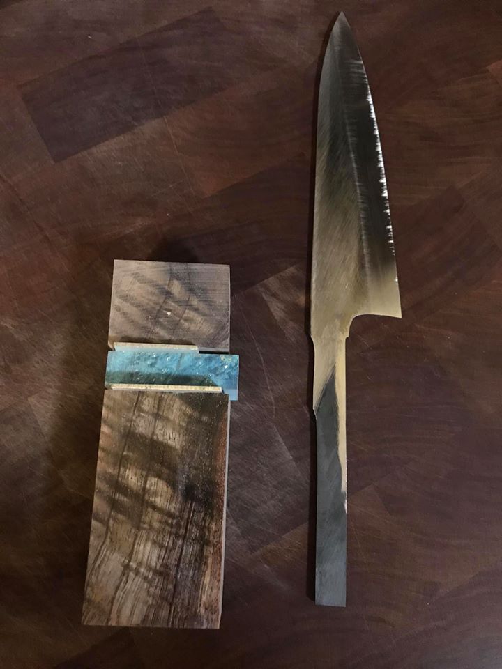

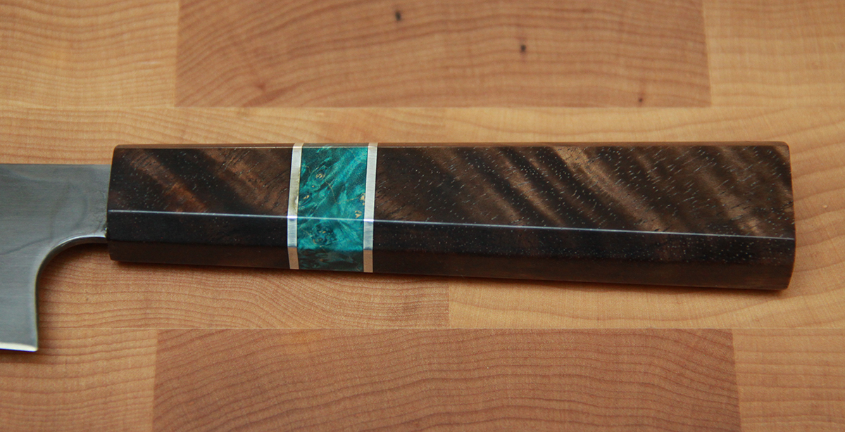

    Just a dry fit right now. Wood is Koa with dyed boxelder burl and nickel silver spacers. Did a five minute sharpening on this one, but will probably take a bit more time tomorrow and sharpen properly before testing out. Felt like a decent edge though. We'll see how it performs. My first "hamon" as well.

    Loving the steel. Haven't noticed any chipping, even with hardness as high as it is. With the extra polish to bring out the hamon, I found that I need to thin even more behind the edge than normal. It's currently in line to see the grinder.

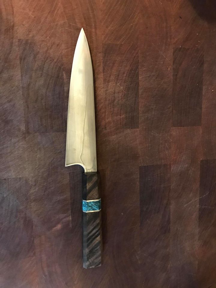

    The steel sharpens beautifully. Gets super hard at quench, and allows for a lot of control tempering to desired hardness. With more work, and knowledge, I should be able to really get some wild hamons, though part of me just wants to harden the whole blank lol.
    I haven't chipped the knife while playing around with it, even though it's hardened to ~65hrc. The edge doesn't last forever, but I wouldn't expect that from this steel either. Thankfully, it's super easy to touch up.

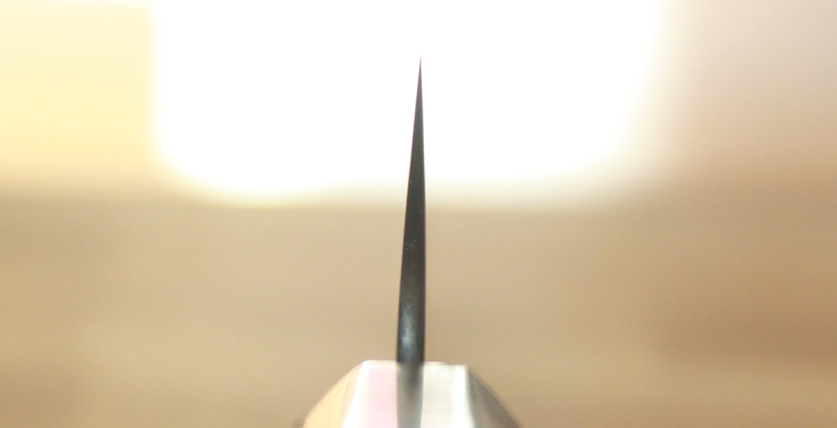

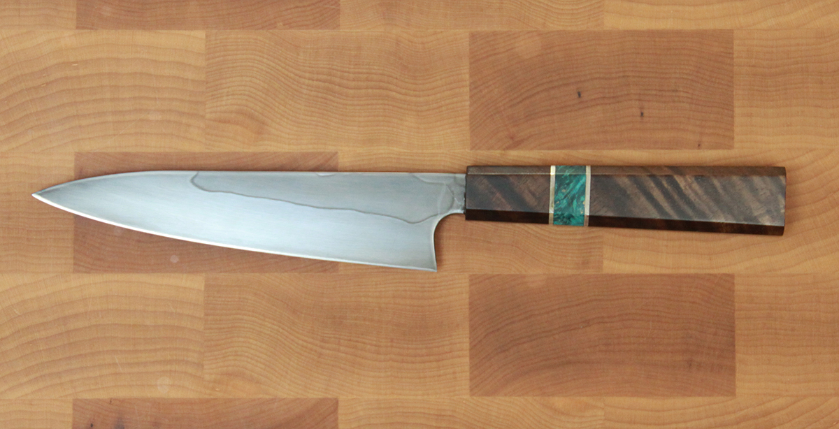

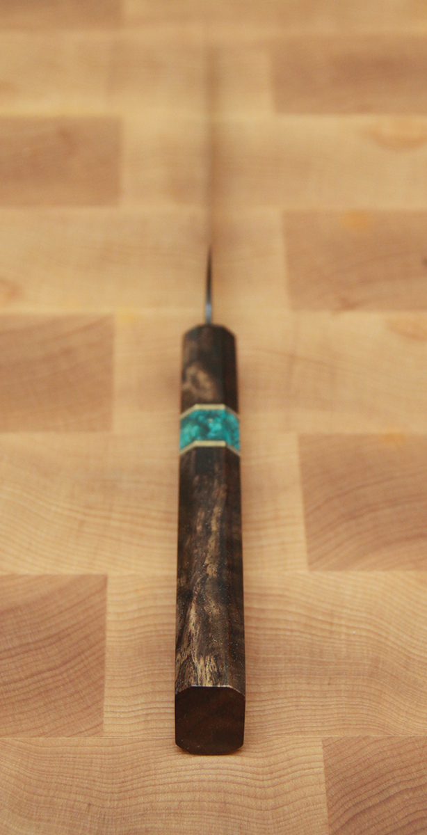

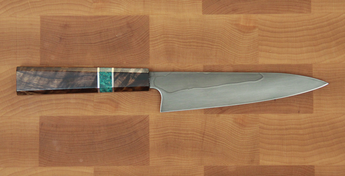

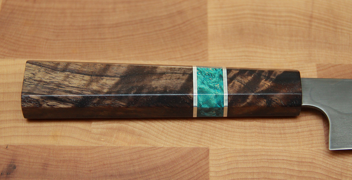

    BTW, it's not a gyuto, but a petty. The blade is 158mm long from heel to tip, and 38mm high at the heel. Just finished thinning, and finishing everything up. My wife found some time to take some real photos for me, so here are some better pics:
