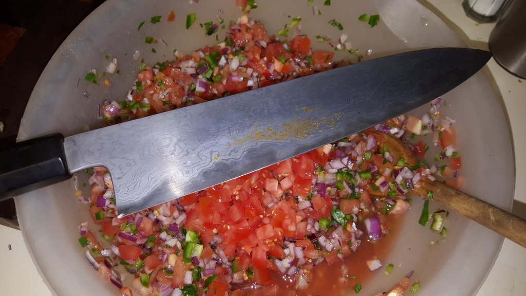

  12. CrisAnderson27
    You mean like this?
    That happened while cutting tomatoes lol. Literally...WHILE cutting tomatoes. Like, two of them lol.

  14. CrisAnderson27
    Fresh pico de gallo lol. Tomatoes, jalepenos, onions, cilantro, lime, and garlic. Whenever I get a knife I've never used in for a rehandle I'll make up a batch to see how it handles highly acidic foods both for edge retention and of course to test the geometry. After that it all goes filed in my mental library of how each brand performs ;).
