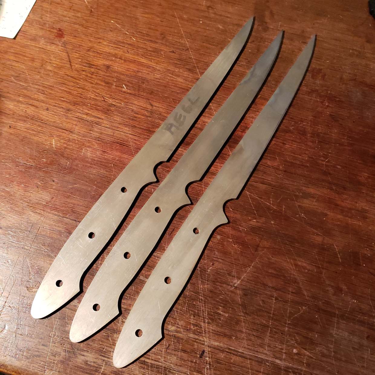

    This is something I am trying. Working up 3 knives at once. So far they are shaped out and refined to near finish dimensions.
    These are all AEBL stainless at 63 rockwell hardness. Length is 180 to 185mm.

    Yep, I had one order, and wanted one myself. So I thought I'd try doing a batch of three and see how it goes.
    One will be ironwood, one oak (for me), and one may be ebony with nickel silver I am thinking, but that could change.

    Work in progress on these fillet knives. Rough grinding done and just started to refine them at 80 grit. They have decent tip flex at this point. 120 then 220 grit to finish refining the geometry and final flex. Then polish with 340.
