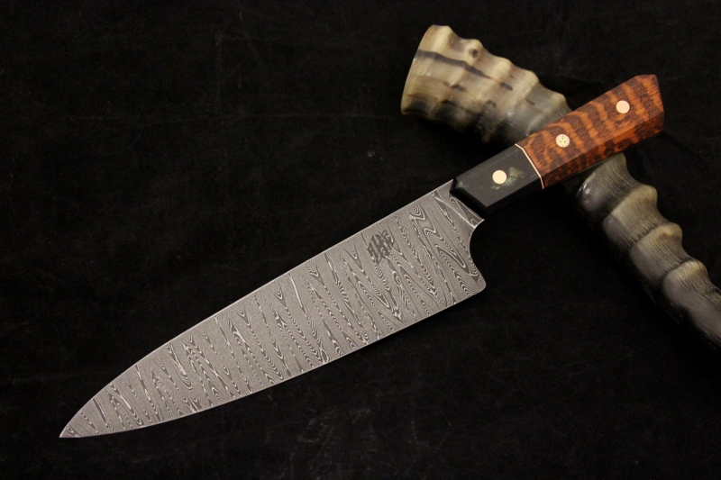

    Hello. I have been testing a couple of different handle shapes as well as blade geometry.. Here are the first 2 completed pieces. This handle is a extension of a design I started on in 2013. At some point in the near future. I plan to do a batch or pre buy of this style Gyuto, in a San Mai Blue#2 core stainless clad. offering it in 2 sizes . 8" and 10"
    These 2 have a RC of 63/64, The grinds are convex.
    Handle style is a modified full tang Wa construction. A nod to Delbert Ealy.
    Specs and prices.
    Specs 8"
    OAL:
    13"~330mm
    Blade: 8 1/8"~205mm tip to heel. Thickness above the heel 2.2mm Tapering to tip. Blade height at heel 52mm tall.
    HHH Damascus, High Carbon steel. Hardened to RC 63. Modified ladder pattern.
    Handle: OAL 4 1/2" ~ 115mm Snake wood and birch burl. Both came from Craig Stevens.
    (here are the specs for the handle. Thickness, height and length
    Height at front 23.5mm tapering to 29mm
    Thickness at front 15mm to 22mm
    Length is 4 1/2" ~ 115mm)
    Pins: Copper
    Liners and spacers: Black G-10 and copper
    Rounded spine and choil.

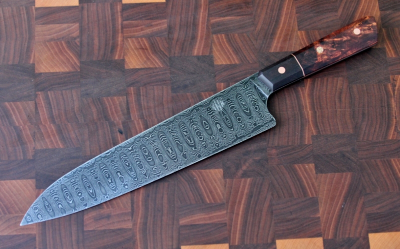

    Specs 10"
    OAL: 15 1/4"~390mm
    Blade: 10"~254mm tip to heel. Thickness above heel 2.5mm Tapering to the tip. Blade height at heel 53.5mm tall.
    HHH Damascus, High Carbon steel. Hardened to RC 63. Tribal pattern
    Handle: OAL 5 1/8"~130mm Honduran Rosewood burl with African Blackwood. Both from Mark Farly at Burl Source.
    The height at the front is 23.5mm tapering to the back at 28mm
    The thickness is front 15mm tapering to 22mm
    Length is 5 1/8" or 130mm)
    Pins: Copper
    Leather Saya with copper stitching. Hand sewn and hand tooled with a lion. I did not get images of the saya and knife together. I will gladly send or post images per request.

    I snapped a few images in natural light on my walnut board. The colors are a little closer to true. Also shows the Saya that comes with the 10" chef.

    Mikey, Im happy to talk about this geometry. I think I sorta muddied the waters a little in my post, Because as I was telling you about these 2 knives. I also was trying to talk about a future project in the san mai knives I am working on.. So I will try to explain these 2 knives And save the San Mai "work horse" knives for another post. :D
    The 8" is the one that I made the most change to the blade itself. first off, The tip location is higher then my "standard" Resulting in more belly throughout the cutting edge. Secondly, the tip itself is has a different shape. More pointy.. I guess would be one way to describe. Where many of the chef knives I make the tip is not as pointy. Even these 2 blades side by side. Its easy to see the difference Both in tip location/height and tip shape.
    The 10" I went the other direction with the tip. and lowered it ever so slightly. This results in a flatter edge profile. Also the tip is more akin to my standard gyuto on this 10" I love the way this 10" knife feels and cuts. But overall. The profile and tip and geometry are very similar to my standard. With a grind thats R hand bias and more convexity to the blade faces.
    Overall. Some changes are so subtle and almost impossible to "see" .. Unless you have 2 or more blades side by side to compare. And even then. One may cut or fee better then another. Yet looking at them you would be hard pressed to say what is different. At this point in my journey, some changes are so subtle.. Yet make a difference in the performance of the knife.
    As I move forward with the 8" work horse. I am basing the grinds off a Kato. While having the tip position and blade shape, similar to this 8" damascus blade.
