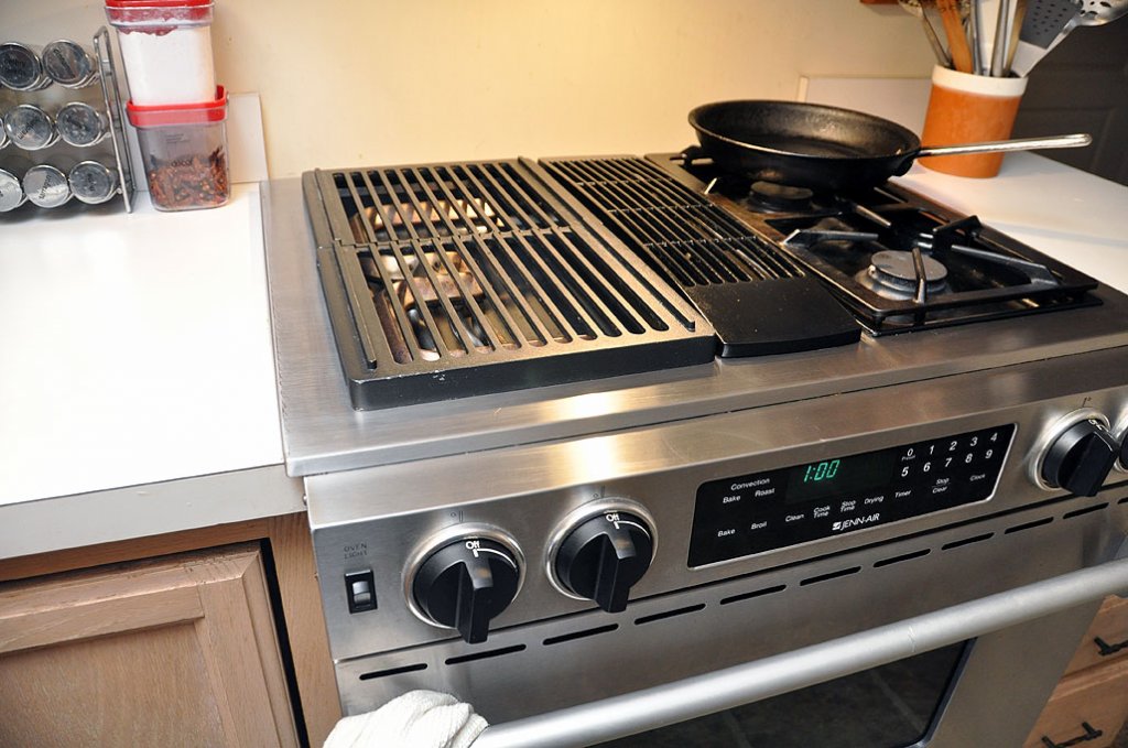

    On the other hand, my parents had a Jenn-Air with the ventilation between the burners, like this one, and it worked very well, except for being a PITA to clean. Thirty-four years without a problem, and still going strong.

    I had the kind pictured above and it worked OK for frying pans, but pretty much sucked for any kind of sauce/stock pot. Where I am currently has the other kind....it works surprisingly well for the back burners.

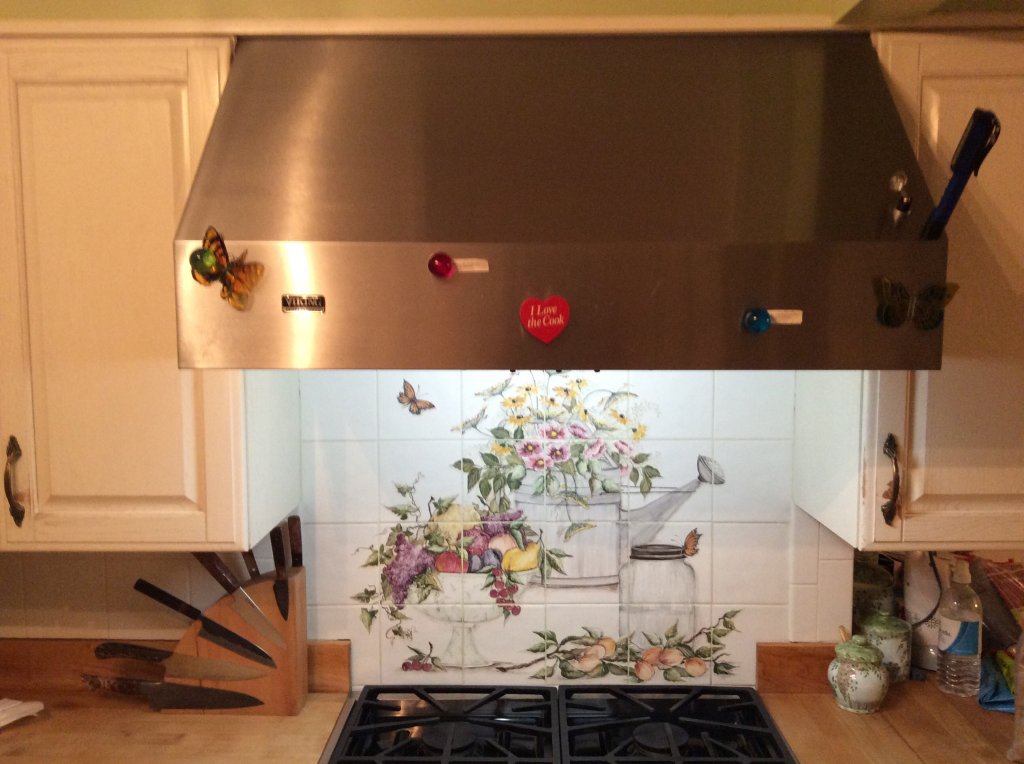

    Small Viking hood. Won't break the bank. We have low ceilings, the previous downdraft stove was like no fan at all. I still cook outside on twin burners as often as possible weather permitting. image.jpg
  5. Downdrafts are next to useless for any quasi-serious cook. We retrofitted a 1200 cfm hood in our house which was originally built with a recirculating fan, (construction turned out to be a nightmare), but it was the best investment I made.
