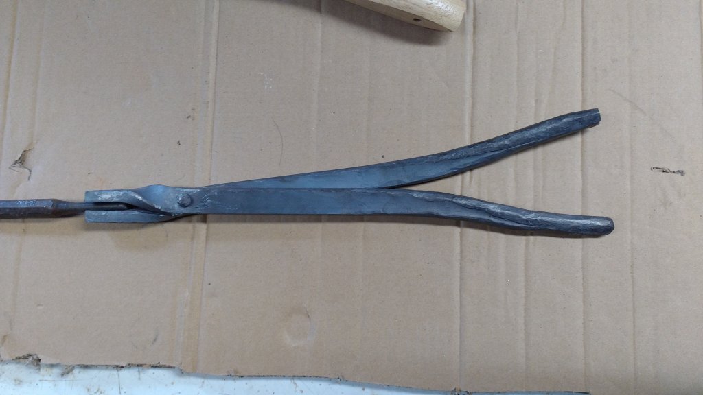

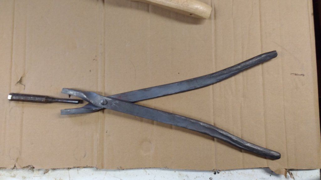

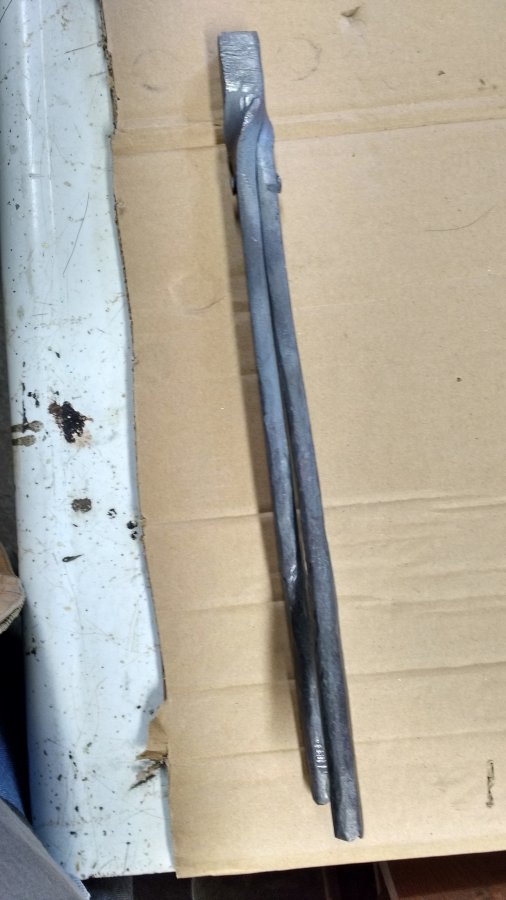

    an inauspicious start. my first set of tongs.
  5. Nice start!
    Hopefully this will be taken as constructive and not derogatory.
    It looks like you either didn't have enough heat, let them cool too much, or didn't roll them enough when you were forming your handles leaving your material fold on itself causing cold shuts.
    Looks like you formed them after pinning?
    Nice job on turning the jaws. Looks very clean and even.
  6. Jim
  7. MotoMike
    your comments are very much appreciated. I've received the same advise from another smith on the UMBA fb page. I was worried about it being too hot, so probably didn't leave them in long enough. the plans called for installing a pin and heating them together for alignment purposes and twisting them with the pin still in. After I twised it, I took the pin out and worked on the reins separately. I think I will remove the rivet and draw them out some more. I don't have any other tongs yet, so working them requires me to hold them with vice grips.

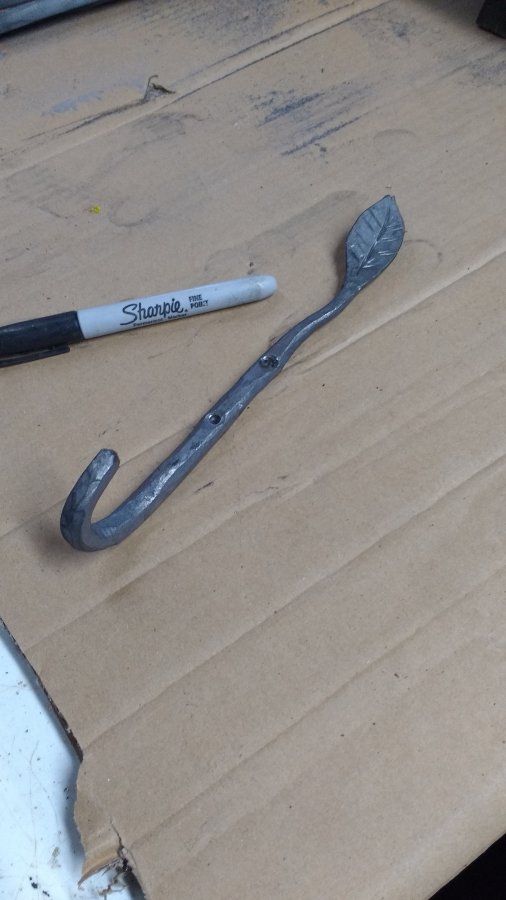

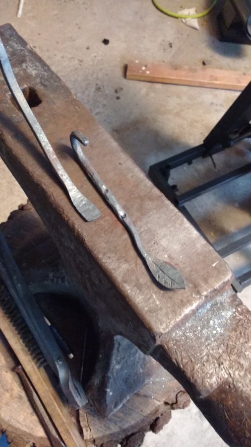

    First attempt at a leaf. Also made a hold down seen in the second picture. rough but I think I can get there.
  13. Looking very good sir!
