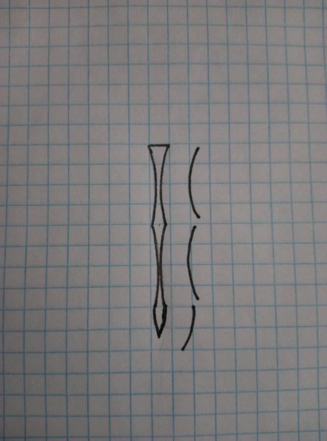

  11. It is thin and I'm sure it will be a good cutter. It actually went a little thinner than I had hoped. It was hard to say how it would actually come out, even though I tried to draw it out on paper.
    I think I am going to work up another one now that I know what I am up against, but I will certainly be testing this one out on some fat carrots and the like to see what it will do.

  15. the geometry is not like a scandi but like on the photo P70925-140830.jpg
  16. That's a pity. Would it be possible that the concavity is not deep enough?

  18. It did get a lot thinner than I intended, so yes, the concave hollow is not as deep as it might have been.
    It's a trade-off between deeper hollows and thin behind the edge.
    I have a 14 inch wheel that would go much deeper. I just need to figure out if this still will allow me to hit the other points (thinness).
  19. You may very well be right Matt.
    I have to experiment though. It helps me to fully understand the nuances. Maybe I get something good, maybe I don't. But I have to try it out.
