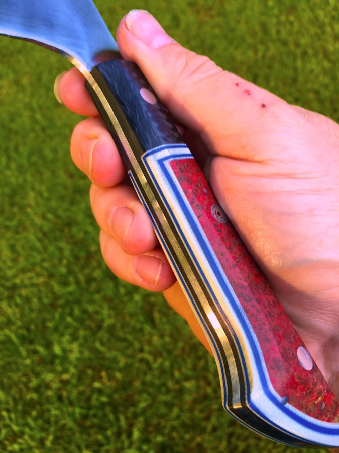

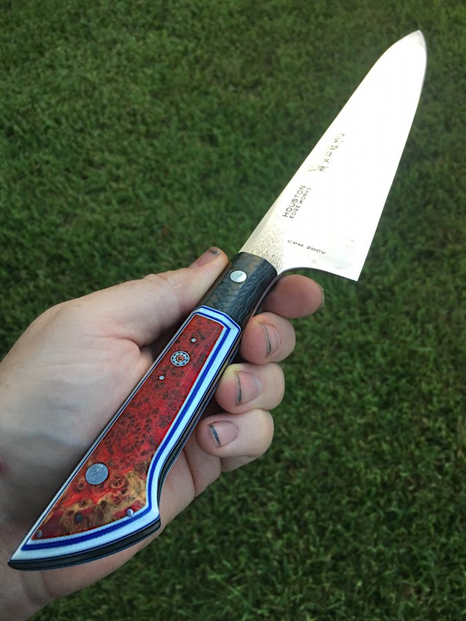

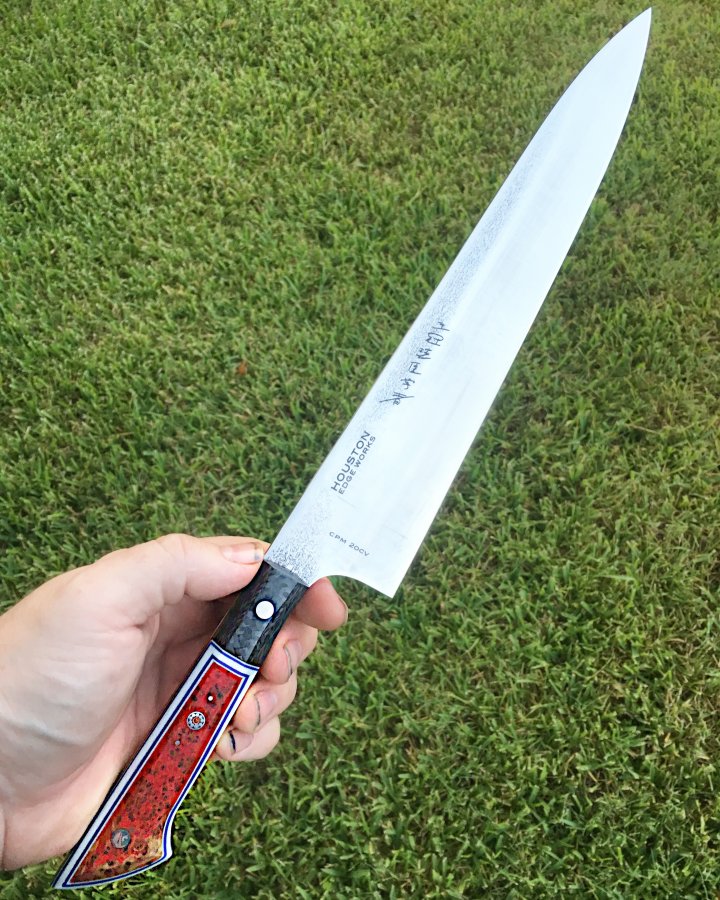

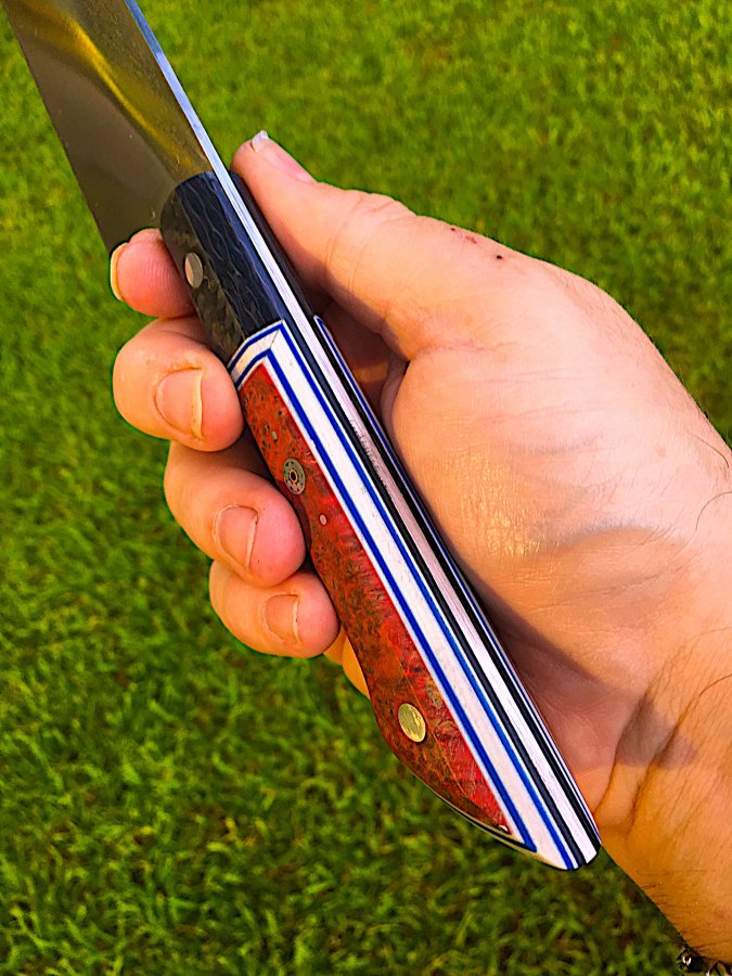

    I'm really liking this profile I've done several times. This one is a 250mm (or maybe 255mm) CPM 20 CV stainless super steel. It's quite a bit more difficult to work with than other premium steels due to the extremely high chromium, vanadium, and tungsten content. But the performance benefit is well worth it. This knife sports an octagonal handle with red dyed black ash Burl, blue and white and black G10 trim and carbon fiber bolsters. 50mm high at the heel. 7 stainless steel pins and a center stainless and copper mosaic pin. It will be available this weekend.
