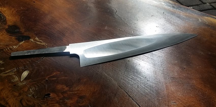

    This is a hollow grind left/right on a convex base, fairly thin.
    The hollow makes this significantly lighter than a standard convex grind, even a thin one.
    It remains rigid though due to the think spine, starting at 3.4 mm with a full distal taper to ~1.7 two inches from the tip. A very interesting study for me. I can't wait to see how it cuts. Food release should be stellar.
    This is pretty much finish ground on the grinder. I am debating finishing it just like this, maybe take it a bit finer grit on the grinder, and just clean it up a bit. The grind isn't quite cosmetically perfect, so may be a tester / pass-around. We'll see...
    I'd be interested to hear what you all think about it.

    I am working on v2 tonight. I've learned a few things that I want to implement. I don't see a need to take that hollow all the way to the heel, nor the tip. Otherwise I like the height of the hollow in theory. Testing will tell....

  6. Mark Brock
    V2 of my hollow on convex grind. I love this!

  10. Do you have a large radius platten or wheel for putting in the hollow.

    I do have a 14 inch wheel, but these were all done with the raduised platen. 36inch.
    I ended up chasing the grind on that last one there a bit too far. It's still a usable gyuto, but it's thin thin!
    The other came out very nice, and that is the first one up for finishing.

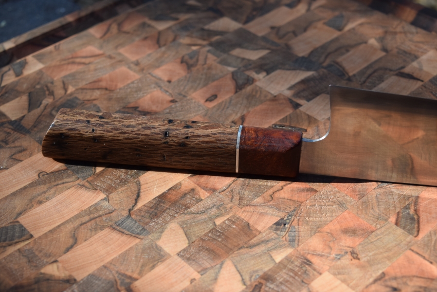

    Finishing this one up. 244 by 54 mm 52100 at 63 rockwell hardness. This is stabilized rayed Oak and Bloodwood with silver ingot spacer.
    I'll give it a test in a day or two.
    Let me know what you think of the grind, and the handle composition if you have a mind to.

    Thanks Rick. I am wondering how that holey oak will be accepted. I like it myself, but I might fill those holes yet. Right now they are raw. And I haven't glued up the handle just yet either.
    I am debating a pass-around on this one.
    I'm not sure if I want to keep it, sell it, or possibly raffle it on IG. Thinking......
