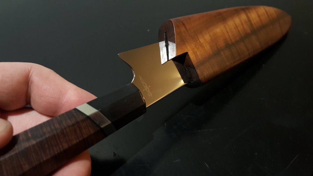

  1. G'day all,
    Slowly getting more and more shop time in now the renovations are starting to wind down a bit. The following blade is one of the latest I have made, and perhaps one of my favourite small knives I have done.
    150mm RWL34 Petty at 63HRC.
    35mm tall at the heel, sporting a mirror polish.
    The spine and choil are also mirror polished and rounded for maximum comfort.
    The handle is octagonal black buffalo horn, Nickle Silver and Ringed Gidgee.
    The Saya is a felt lined Ringed Gidgee which is also friction fit. of a two piece construction.
    This little blade is very thing and convex ground, however enough meat has been left at the spine to provide rigidity. I would have to say it feels like the perfect companion petty in the kitchen.
    I will be making a number of full sized blades, and petty's in this design, or near to with minor adjustments in materials and ratios.

    I have seen this knife in person and it was incredible , the pics don't do justice . Perfect fit and finish

    Thanks brother, after the heat treat and geometry is sorted out, the rest is just aesthetics :D
    Downside is I am not allowed to keep it :( Id be happy to make another one, I will be doing a few for the Sydney knife Show anyway. Maybe some k-tips, maybe some damasteel versions.
