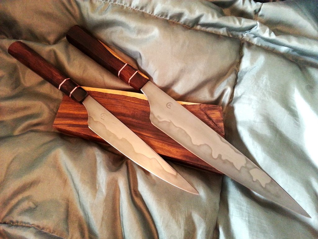

    This is the knife as I received it. She’s a beaut!

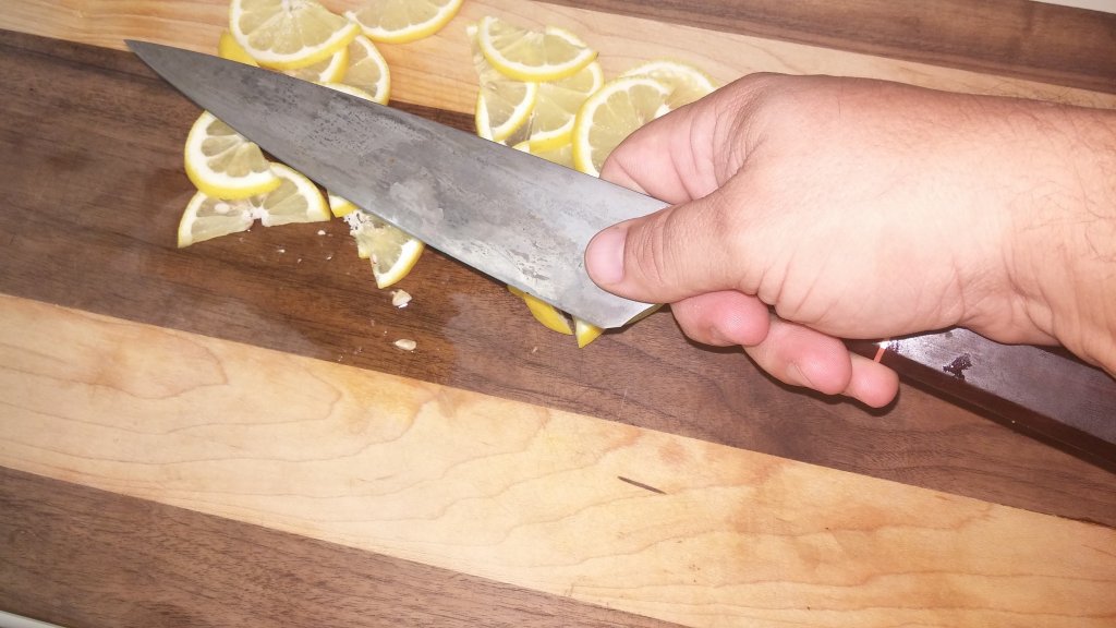

    This is the knife after Memorial day weekend. I put it through the paces in a home kitchen, cutting everything and anything I could get my hands on, including onion, pepper, grapes, strawberries, celery, carrot, tomato, as well as sausage, chicken, etc. Let’s just say the family ate well this weekend, and the knife was well used.
    On receipt, I found the edge to be good. I did not want to do a full sharpening session, so I just stropped on diamond loaded felt. The knife performed well, and responded well to the felt, but was still not quite where I wanted it to be. I did a very quick stropping touch up on Jon at JKI’s 6k diamond plate, and the resulting edge was sublime. The knife gets very sharp – very easily.

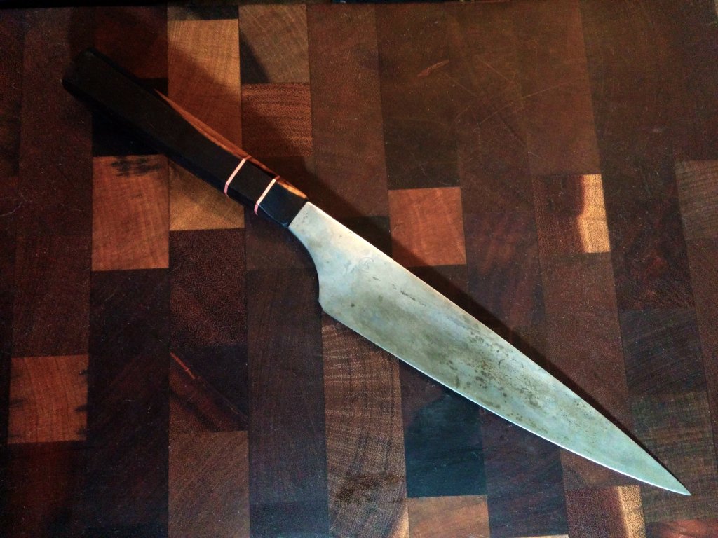

    This is the knife as it sits now after my cleanup. It cleans up really easily using the gear provided, although the patina is not completely erasable without more work. I suspect this knife will only continue to develop more character as it moves across the land. Also, shipping is a pain, as this is a big heavy wooden package to ship!

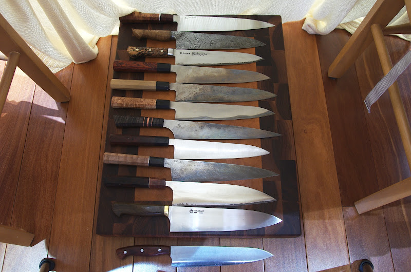

    3) The overall thinness of the blade (see pics below for some spine comparisons – the Fowler is the only gyuto that is remotely similar in blade profile and thickness) did not result in too much flex or instability. In fact, the knife felt quite stable, even on harder items such as the sweet potato. I chalk this up to the relatively low blade height. The combo of thinness and low height ‘just works’.

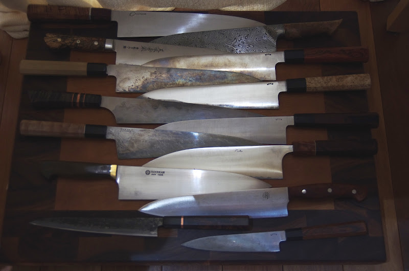

    The photos below illustrate the range of gyutos I use, so you can see where the pass-around falls in relation to some DTs, a couple Markos, a HHH midway, a Fowler, a Carter, a Catchside, a couple Japanese blades, and probably one or two others. Some of the spine shots show how the dang thing is even thinner along the spine than my 210mm Takeda suji(!) and DT ITK 150mm petty(!!).
    Cris, thanks for letting me try out your knife! Your work is already exceptional, and is only going to keep getting better.
    The Vault:
    Finally breeched!!!!!:
    Gyutos for comparison:
    Gyutos, suji and petty for comparison:
    Pared down gyuto collection for comparison, Fowler on far right:
    Spine shot for collection in last photo; Fowler and Mareko are closets in spine thickness/ taper:
    Yeah, but while they are the closest, they are still not in the same league!:
    Dang thing even makes DT 150 petty and takeda 210 suji look fat!
