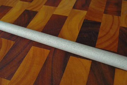

  1. Just need a bit of help finding a way to get a Kyocera honing rod/steel clean, yes I did use it to 'sharpen' my previous knives before I knew any better:eek:
    I am selling it and wanted to brighten it up, I have tried Bar Keepers Friend and that has cleaned it up a bit but not much better, is there any way of cleaning it or are the grey specks now somehow embedded in the ceramic?

    i use a 3m pad with a little soft scrub and water

  10. I use a big pink pencil eraser. Works like a charm, every time.

    3M green scrub pad, comet cleanser
  12. Some coarse diamond lapping film will do the trick pretty quickly. You can use it wet so the ceramic powder doesn't load up the spaces between the diamonds. I'd suggest doing it under running water. Just wrap the lapping film around the rod and polish it lengthwise.

  14. The pink eraser method definitely works. If the ceramic is really loaded, you can use a specialized abrasive eraser called the "Superaser" which goes a step further in cleaning. You can find them on Amazon for a couple of bucks.

    Hmmm, has anyone ever tried dissolving the metal with a mild acid such a vinegar?
  16. Soft scrub or scouring powder and a 3m sponge and a bit if warm water. Easy easy.
