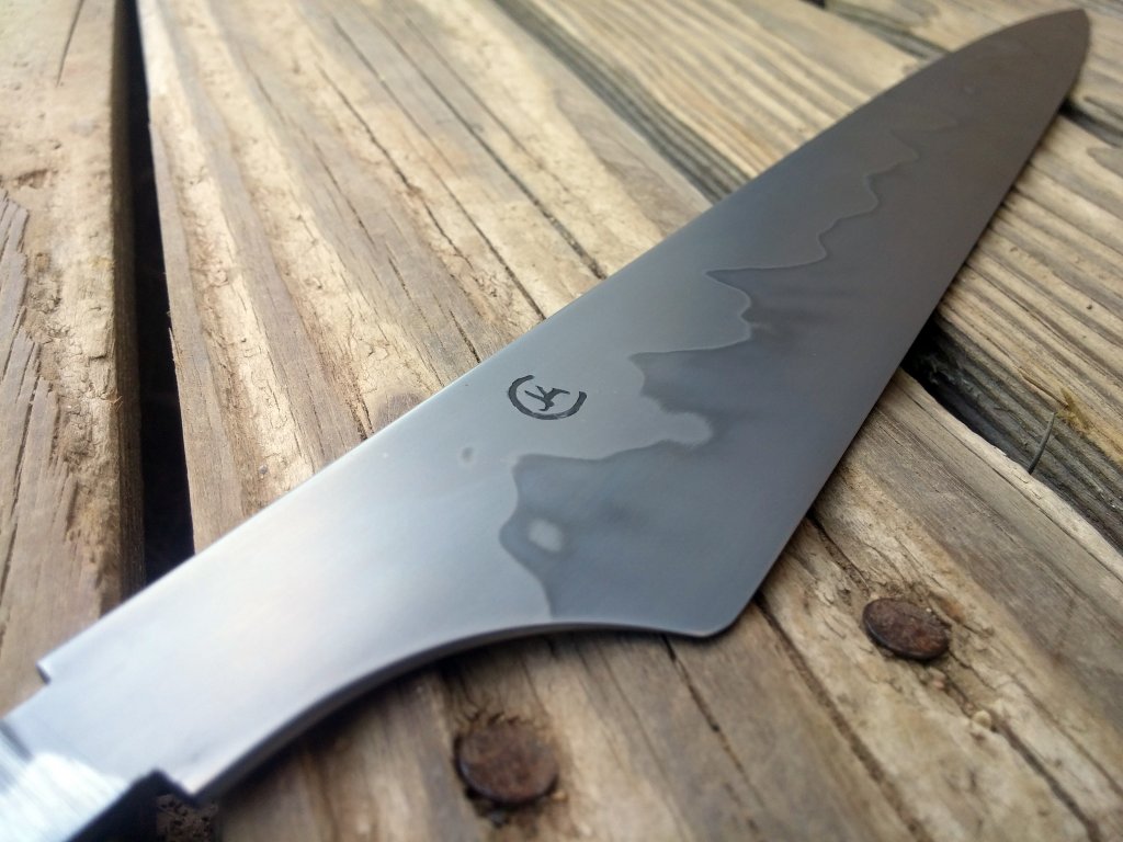

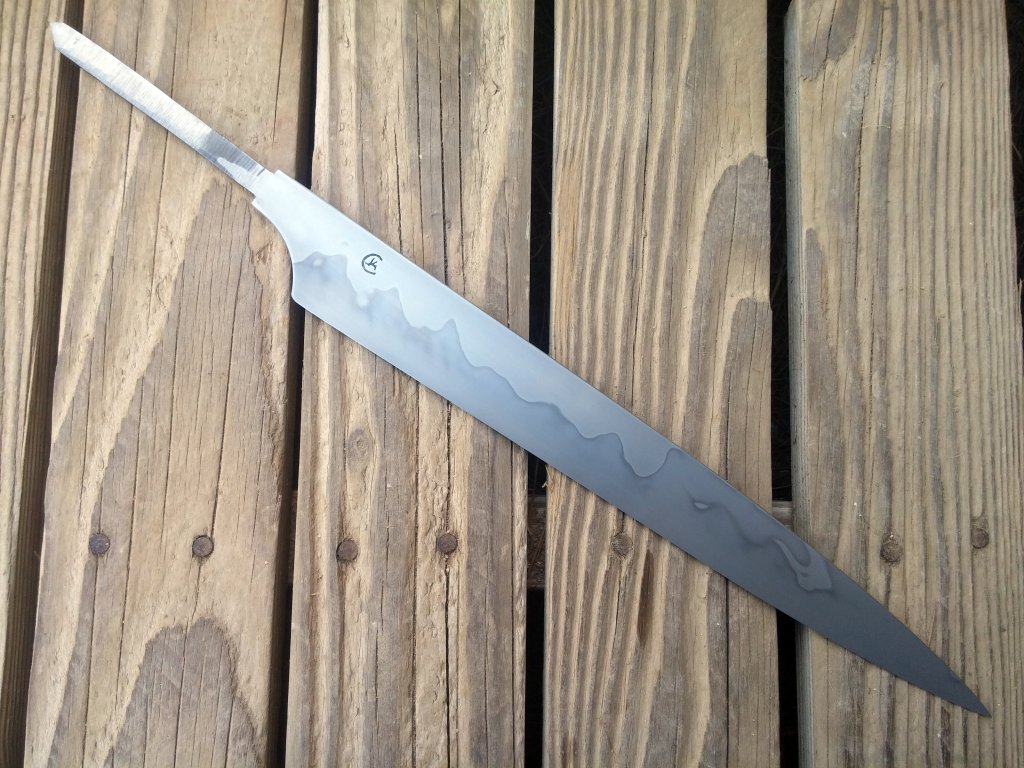

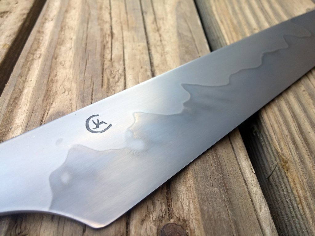

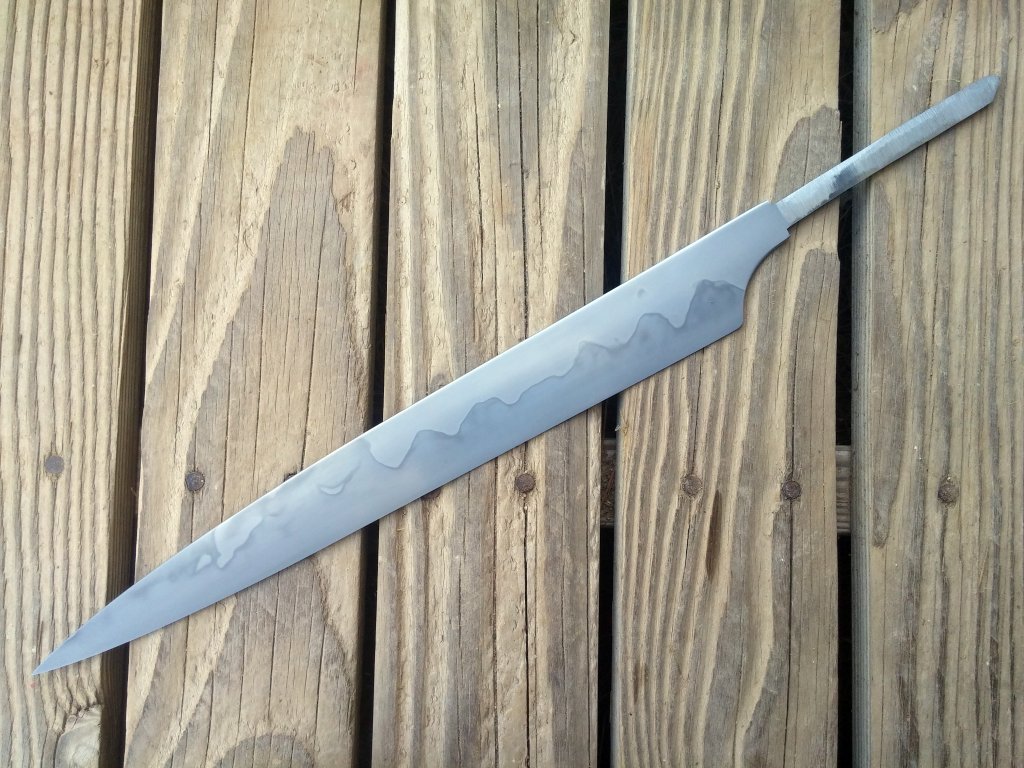

  1. ...to get its own thread :).
    310mm sujihiki collaboration with @mkriggen!!
    20141212_112012.jpg 20141212_112029.jpg 20141212_112056.jpg 20141212_112106.jpg 20141212_112144.jpg
    More pictures to come once Mikey does his handle magic!!

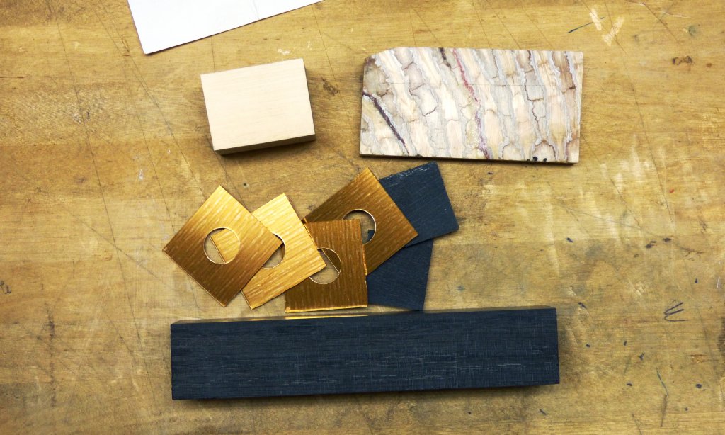

    As Cris was nice enough to pound this thing out for me, I figured I would let you all watch as it blossoms and grows. This might take a while as I intend to make a saya and presentation box for it finished in real urushi lacquer. Of course, first I have to learn how to do urushi lacquer. I'll worry about that after I get a handle on it.
    To match the personality of the blade, I wanted the handle to be kinda barbaric, yet elegant and understated (well, understated for me). While I was waiting for the blade, I put a lot of thought into how I was going to achieve this. All of those thoughts went right out the window the night Randy put some awesome mammoth ivory blocks up for sale. Right after I bought the ivory from Randy I went over to Mark's site and ordered a big hunk of bog oak, because I'd been inspired. I'm calling this my 'Bronze Age Handle'. The only components that are younger then the bronze age are the bronze spacers them self's (I figured that was fair). The body will be ancient bog oak, with mammoth ivory ferrule, mammoth tooth end cap, and two bronze spacers sandwiching a bog oak spacer on each end.

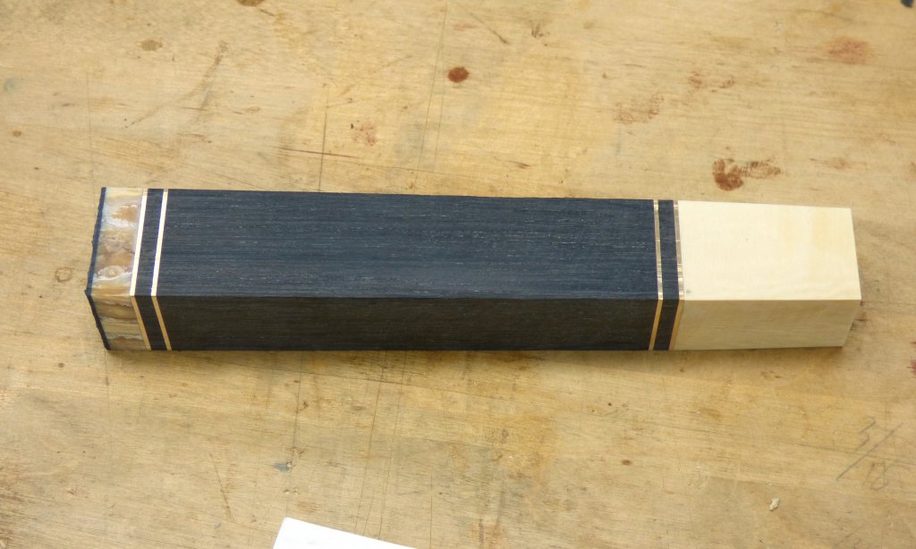

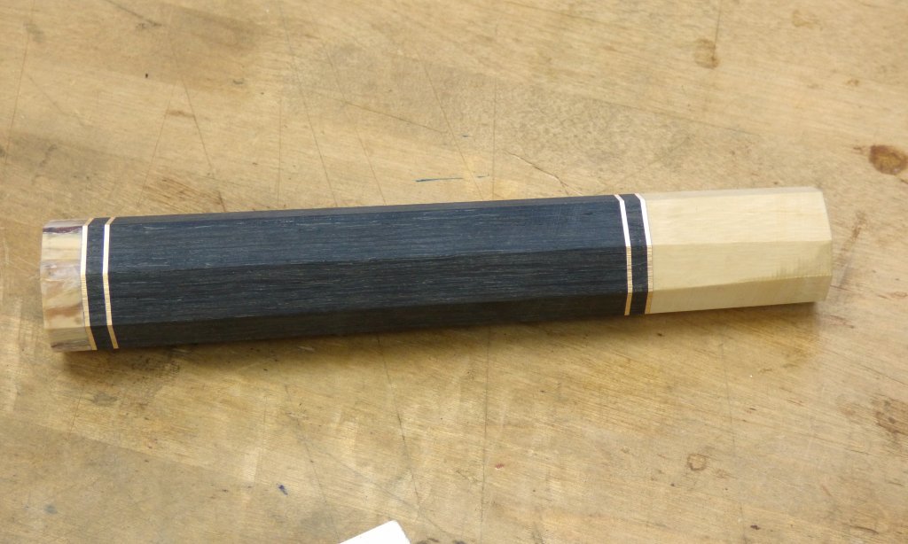

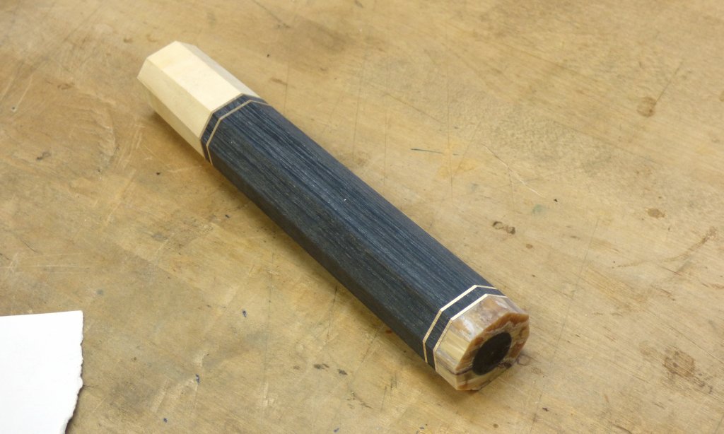

    Made some more progress with this one.
    Glued, squared up, and tapered.
    Shaping complete.
    And dry fitting. I used to wait until the handle was all done before fitting it up, but that was just because I'm not always the sharpest ball in the box. Much better to do this before making every thing shiny:).
    The handle is now at the engravers. Once I get it back the next steps are doing the inlay and lots of sanding.

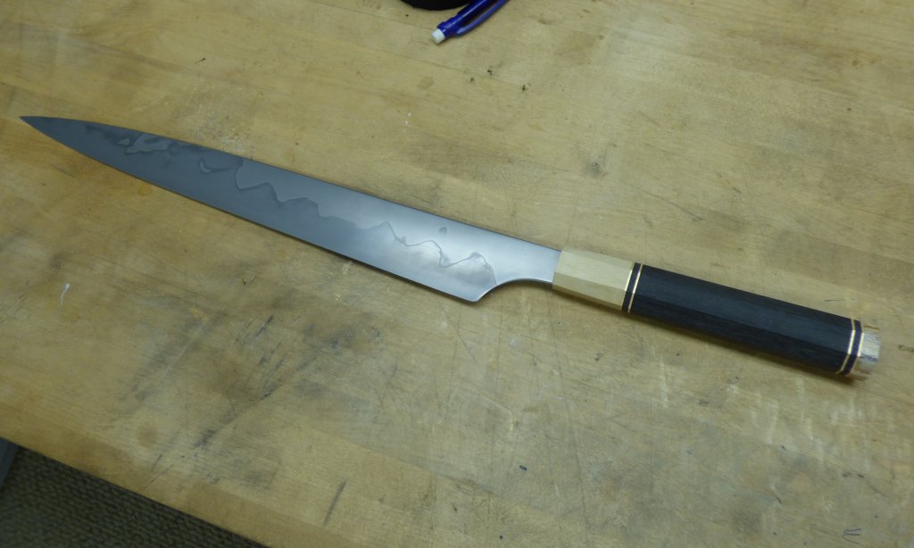

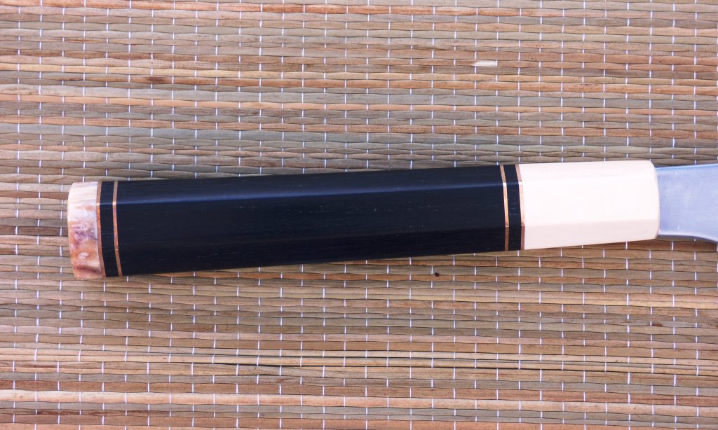

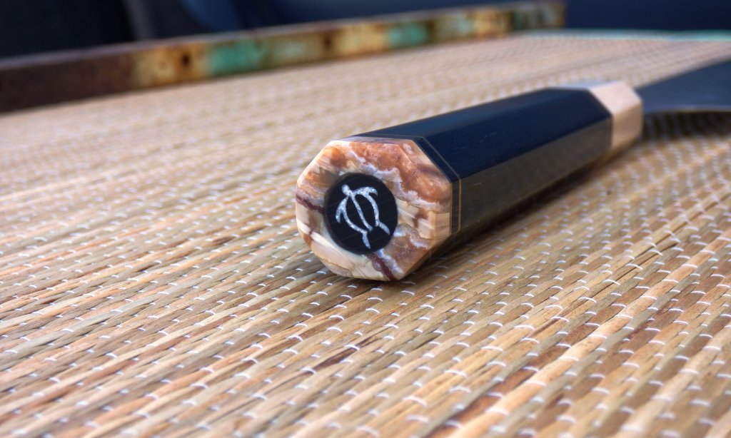

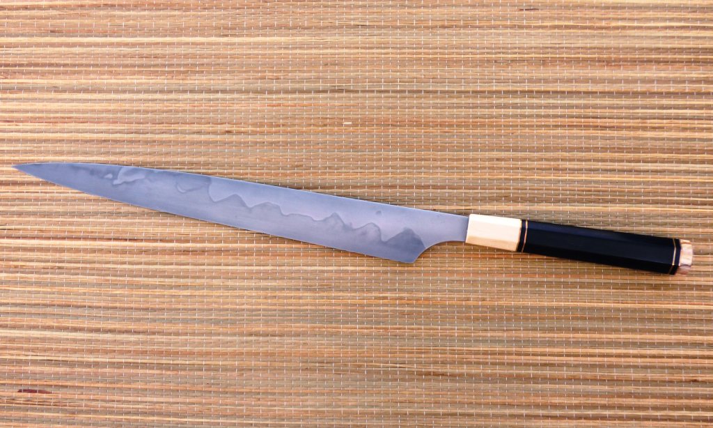

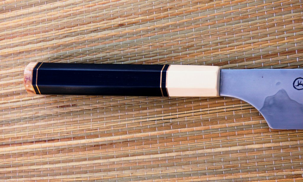

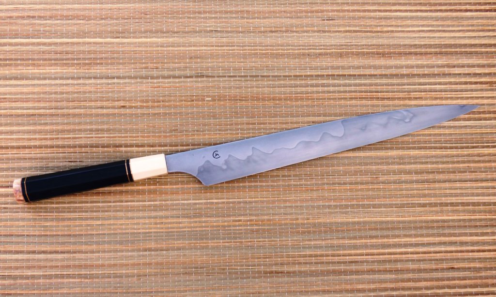

    And here she is...
    Next comes the saya:)
    Be well,
    Mikey
  18. Lefty
    I agree, 100%. This one is perfectly balanced. Beautiful work, Mikey and Cris!
  19. What a beauty... and a work of craftsmanship. Congrats to the new owner and the maker. I applaud you both.
    John emmerling
  20. cheflarge
    What a beautiful, flippin, piece of work!!! Major league props to Cris & Mikey both. I am way jealous! :cool:
