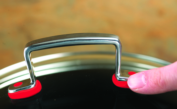

    Ha. I never even heard of that stuff. looks cool. one shot that surprises me is the one where it appears they are gluing a handle to a pan lid. small contact points with a somewhat heavy object.
    are you considering it because it can be cut off when you want to change the handle?

    No this is the image, they mention its heat handling ability, but if they are asserting that it is strong enough to work in this application and will remain there until you cut it off, then I wonder how you could cut it loose if it is down inside the handle. ELWKgONuQR2mT0o2K9fZ.jpg
