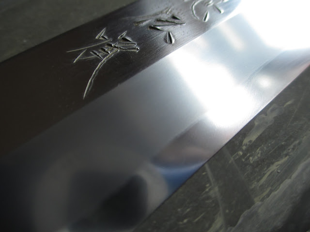

  1. bieniek
    bieniek Founding Member
    The finish youve sweated into your knife.
    Never posted this here before, Ive been doing some polishing in my time.
    Not the best knife to be working on here, just a cheapo Masamoto KK.
    Show me yours!
    And some more of that kind
    Gesshin Hide deba, such a shame this knife belongs to a lame
    And a yoshi petty
    I really enjoy pictures of restorations and polishing jobs and sexy blades. Come on
  2. MattS
    Beautiful! Would love to see another thread on process.

  7. bieniek
    Greg:like
    The thing is.
    When it comes to materials, you dont need much other than some few stones [maybe 4] and some fine sandpaper - lets say grits ranging from 400 to 3000.
    As to the stones, if you have a 1k, 4-8k manmade, and you can get hold of one polishing natural stone, youre set. the rest is patience, time, and fingerstones that can be bought in several places.
    On the Masamoto, I propably spent 100 hours, repolishing it 4 times and thinning and polishing some more. I polished the back side too. Its silly but back then I thought its super important that my blades are mega shiny all the time. Shortly afterwards I sold it all together. Haha
    But it was great lesson. I then managed to get reasonably good finish on the deba in some 7 hours. Heh
    And anyway, I think what you need the most is time. Lots of time.
    Noone showed me and Greg how to polish metals, but you have your goal to have a shiny knife obviously you wouldnt start with the finest grit and finish at the coarsest? :jump

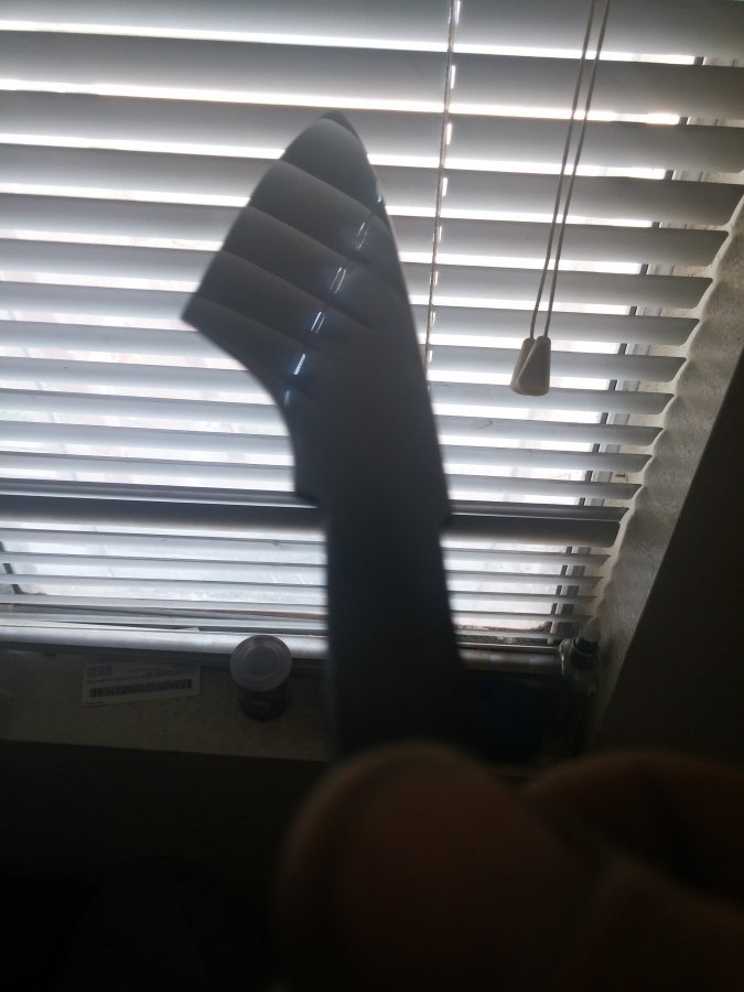

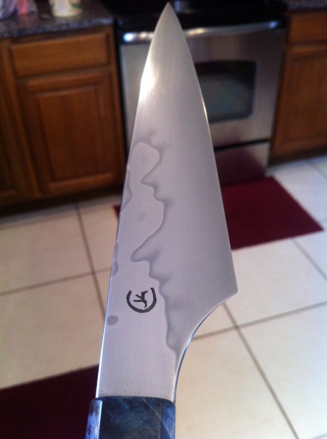

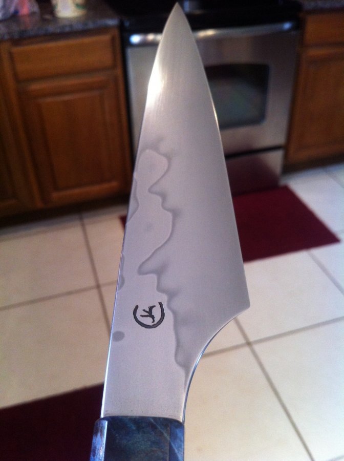

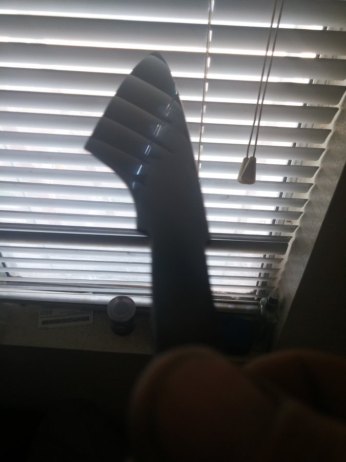

  11. Recent 155mm petty/utility:
    In a dark room you can see the reflection.
    In the light, the polish and etch shows much more clearly.
    I hate hate hate polishing...lol. But I love the end result.
  12. Toothpick
    It looks camouflaged!

  15. I call that my 'Predator' finish :p.
    Thanks bieniek! Things have been very hectic around here...but I miss this place daily and decided to just make the time for it, you know?
    And if you mean my knife looks uniform...thank you for that as well! Every blade is checked against the blinds in a dim room to verify the grind. Something else I learned with swords that transferred over to my kitchen knives I guess, lol.
  16. Toothpick
  17. Lol :). Honestly...it's the same finish as in the second picture...just tipped on an angle and in dimmer light. The gyuto you had in your hands would have looked similar.
  18. Toothpick
  19. For sure.
    Overall Bathon and bienek's finishes are easily as good, or even superior. I get them to a clean hard backed 1500 grit (which invariably leaves streaks) and etch. The acid does a lot of my work for me. Once etched I rub them down with some soft backed 3000g, along with a few other high grit abrasive processes to bring out the hamon. In the end you get a mirror polished blade that looks 'matte' in direct light, but will reflect like a mirror out to about 10' or more when tipped at any angle at all.
  20. bieniek
    I meant the finish now when I read what Ive posted I find it unbelievable you understood anything. I mean the finish is very uniform, and pleasant to the eye. I mean on the other photo. The first picture and the fact the sides of the blade are totally flat is not that important to me. I sure can appreciate the amount of work being put to it but in my world that flatness would be over in two months time.I do my thinning [or most of it] on a grinder you know...
    When I come to think of it now, the shape of the knife is uniform too. There is certain balance to it which me likes. The flow of lines. Personally I dont think choil like that would fit me, and you like to forge very low, but the blade have kind of surreal twist to them, like they are taken out of Alien movie or something.
