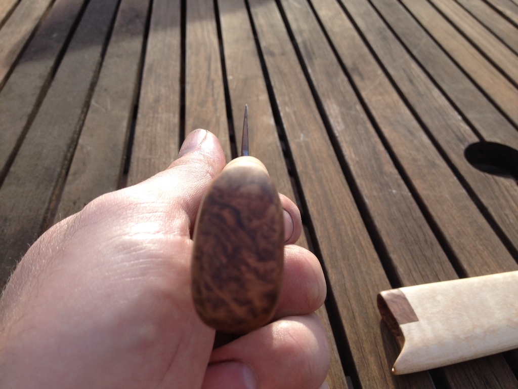

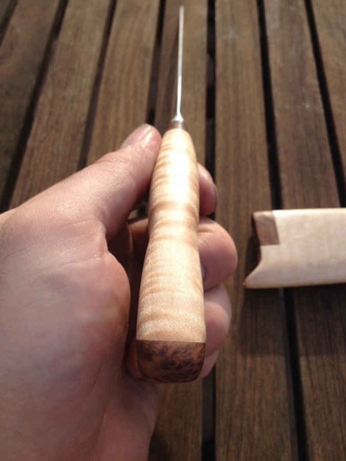

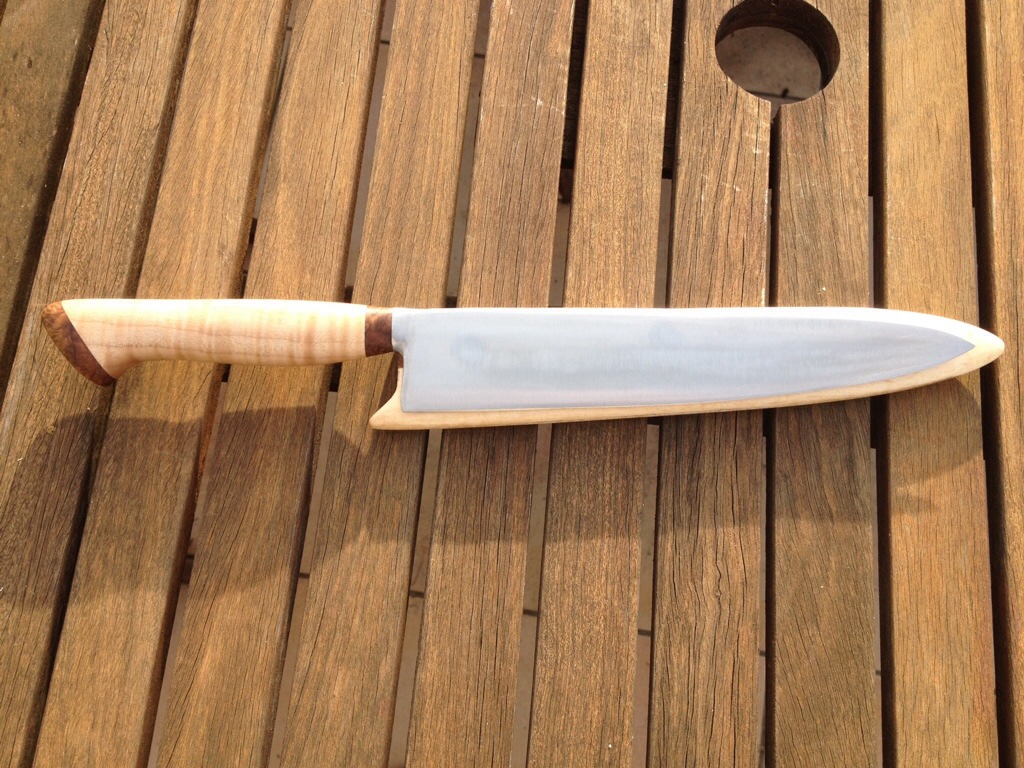

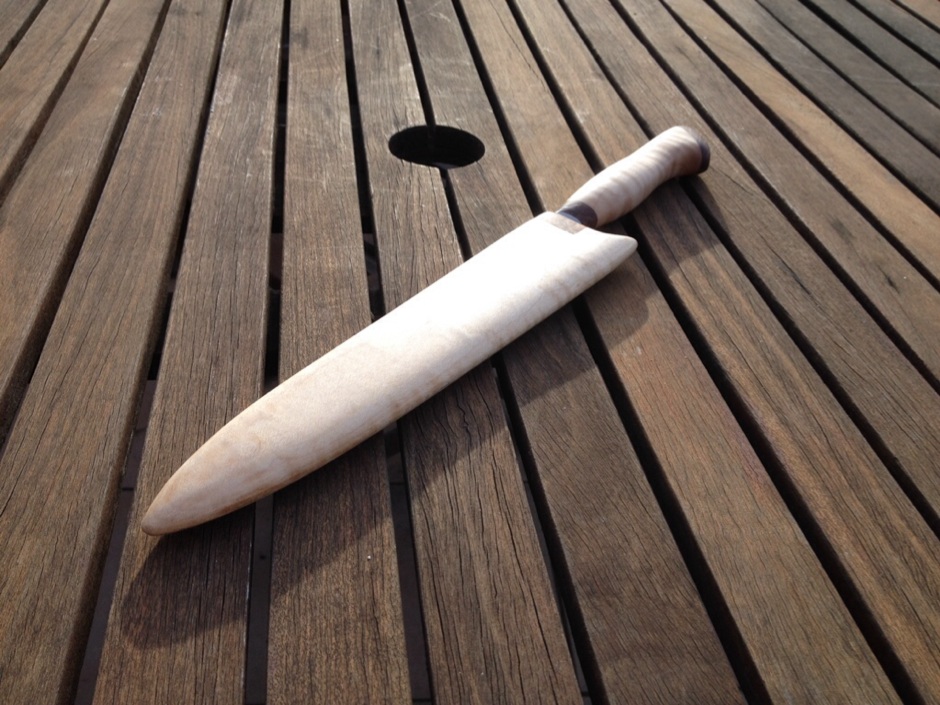

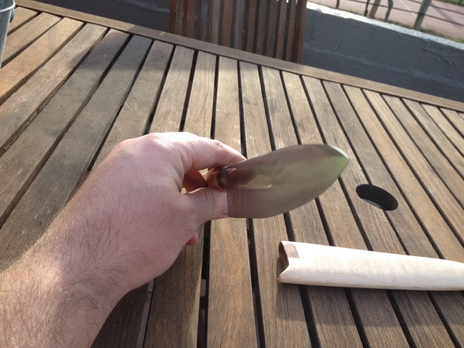

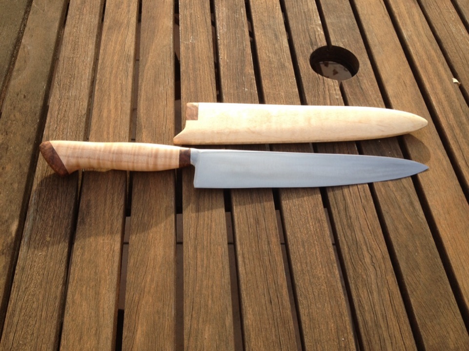

    I wanted to have a sabatier for a long time but their handles and the bolster were a deal breaker for me. Here is my first and very amateur sabatier hidden tang conversion .
    Also my first attempt of making making western handle
    The handle and saya are made from tiger maple and brown mallee burl
    It has many beginners mistake and will end up getting gifted to a friend or so , but overall it was a good learning experience . At the end I ran out of patience and called it a day , I have a gyuto project with western handle, hopefully that will turn out better

    Looks great, I don't see anything wrong with it and like the combo. That little mallee insert in the saya is cool. The handle looks 'organic' in a good way - I imagine it to be quite comfortable.
  3. chefcomesback
    Thank you for your kind words Stefan but knowing that it has imperfections drives me crazy . I have decided to insert the mallee piece since the integral bolster would stick out , I wanted to same wood continue from saya to handle

    Looks great Mert, nice work!!
  6. MotoMike
    very handsome. How is it to use with the new handle?
  7. cheflarge
    Off the hook! I gotta believe that ANY chef would be proud to use that knife, I know I would.
  8. And that's a knife maker right there :) One to watch. Let me know when you start taking orders, if you decide to do so.

    Great job, Mert! It looks comfy and well finished.
  12. Brad Gibson

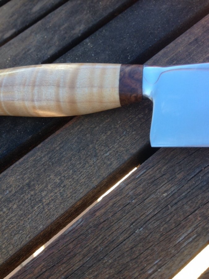

    If it is an integral bolster can we see an upclose set of shots of the bolster and where your handle met? It looks like great work. Keep it up!

    ImageUploadedByTapatalk1399333189.963719.jpg I will be doing some more grinding on fine grits and polish it, then this little guy will be heading to MS , USA

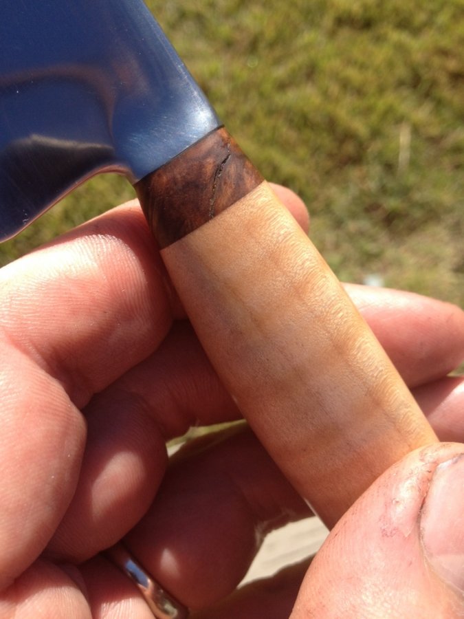

    The picture of a crack in ferrule
  17. apicius9
    Still looks good to me. A buffing wheel with white compound will take out the fine scratches in the transition between bolster and handle. Before that, a drop of CA glue in the small burl crack, sand, repeat as needed. If the crack is wide enough, you can also add a little saw dust from the same wood. With a bit of luck, you won't even see it, especially in burls.
