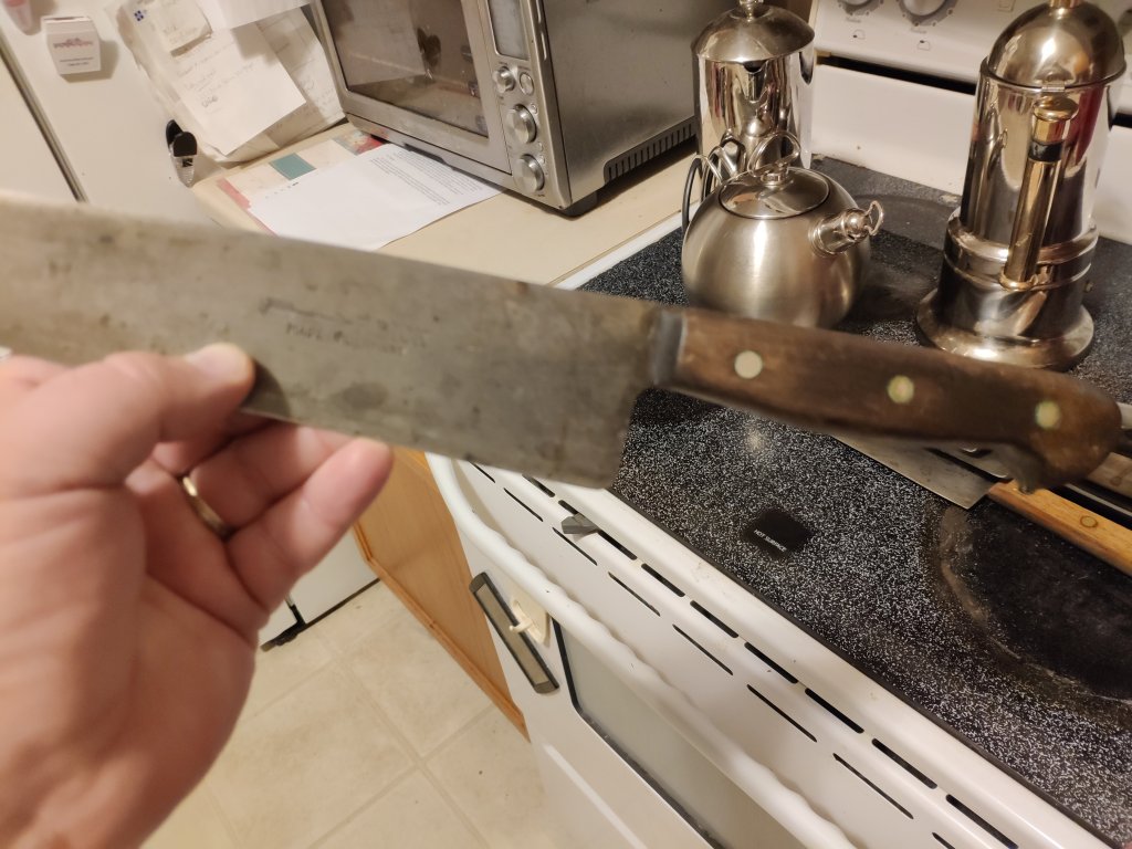

    I've got a collection of vintage knives that I have an end goal of rejuvenating. I don't want to re-handle if I can avoid it. I'd like to keep everything original if possible. I already have one knife where I took the handle off and I ran into the original rivet size seems to be unobatanium. I cannot find anything as large of diameter as the original rivets.
    What would be the best approach for something like this old F Dick chef knife? My thought was very light sanding at fine grit of both the handle and the blade. It's very important to me not to lose the maker's mark (that already happened once from someone else doing me a "favor"). And then polishing or rubbing oil into the handle, new edge and call it good. What do you think? Any pitfalls to be aware of?

  2. marc4pt0
    Only go as coarse of a grit as you need to. Start off with maybe 800. Use wd40 or windex as a lubricant to sand with on the steel only. Not the handle. If that doesn't dig deep enough, drop down to 600.
    For the wood handle, maybe start with 1000 grit

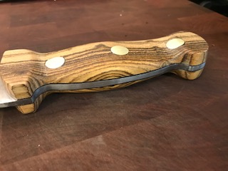

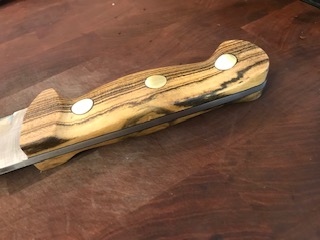

  3. Taylor
