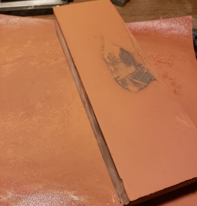

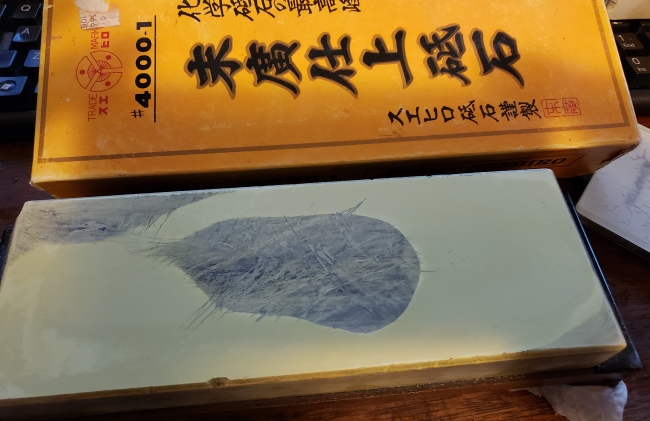

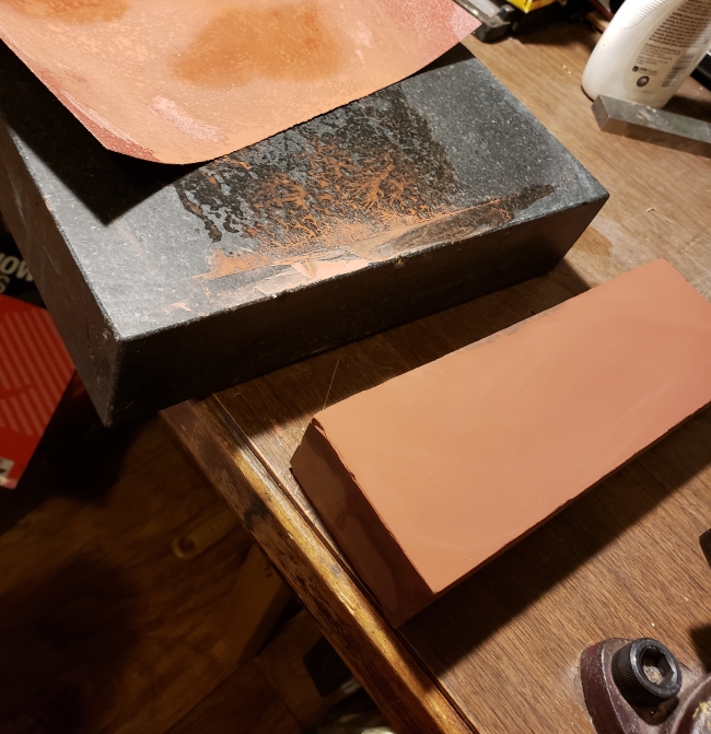

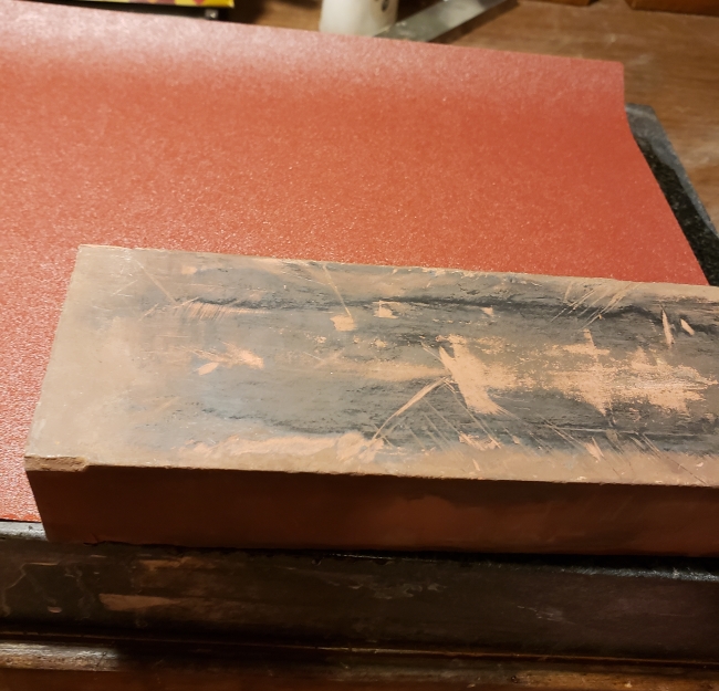

  1. I found a couple of Suehiro stones at a garage sale this weekend. Badly used and abused.
    I usually flatten my stones (take out any dish) with a Shapton glass 320, but these seemed beyond that. They had fairly deep chisel marks as the guy was a wood worker.
    I figured I needed something coarser than the 320 to make any headway in my attempt to resurrect these stones, so I came up with the idea of using my granite plate and some 180 grit paper, wet.
    It actually worked very nicely. Very satisfied with the results, and it was not overly difficult to take out the deep dishes and scratches from these two stones. These are 1200 and 4000 stones.

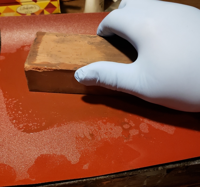

  2. MotoMike
    Look great Mark. wish I had a granite plate. what concern did you have that caused you to glove up for this evolution?
  3. Rick
    Nice job! Next time try doing the "heavy lifting" with a concrete block, and then finish with the wet/dry.
  4. The gloves: It was just really chalky sanding it down. The paper wasn't too bad Rick. It went pretty quick. But good tip.
    I tried these stones out yesterday. Not too impressed. The Shaptons seem much better.

  8. Taylor
    A trick I learned if you're going to use sandpaper on any tile. Glue a large piece of sandpaper to the actual tile. Don't use that piece, but place whatever sandpaper you're going to use over it. The sandpaper underneath will help hold the one above in place, so it doesn't slide around or pop up.
    I've also opted for the disc sander to save on time, though when I'm out and about I carry a 120 grit dmt for flattening on the go. Concrete blocks are great to save on initial flattening, lessening the wear on other stones for cost savings. I'm lucky if I can get a stone to last me a year...
