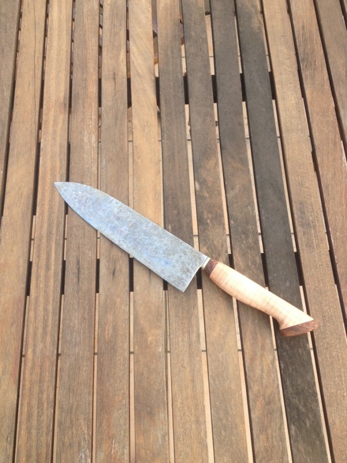

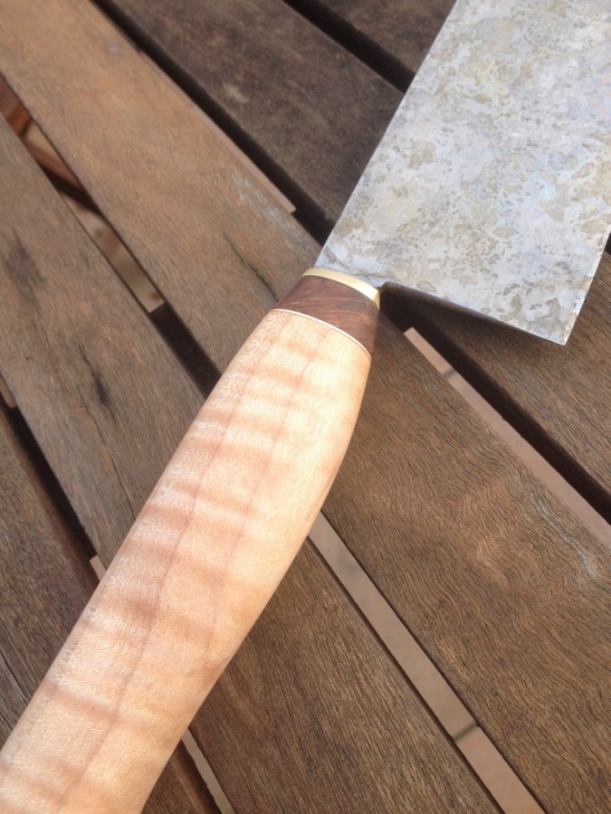

    This is a prototype of a gyuto I was working on. ( the one I almost sold it to a non knife nut )It has a hidden tang western style handle although next lot will be secured with a mosaic pin too in addition . Handle is tiger maple from dream burls and bimble burl with a copper liner and a brass tip.

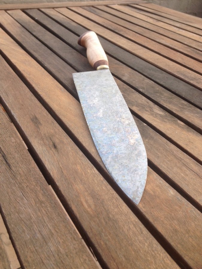

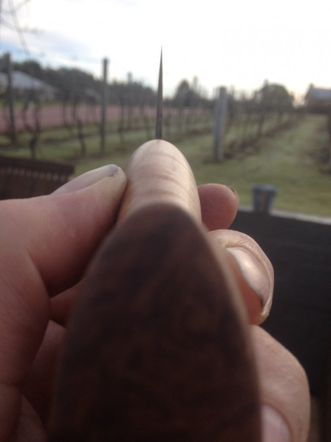

    The blade is made from a simple high carbon steel, around 60-61, with a 216 mm cutting edge and 50 mm tall at the heel . It is quite stiff , 3mm at the spine and more like workhorse category than laser but it is still very thin behind the edge. Overall length 355 mm and weighs 207 grams . Balance point is one inch before handle . It is asymmetric ground for right handed person
    Since it is a practice knife I only have ground it to 120 grit just in case I may have to alter the grind after testing. I put a mustard patina on it make it stable in pro kitchen .
    I suck at this choil shots , hope you can see it is thin behind the edge .

  7. Is it flat ground? How does it actually performs in your tests?
    I like the overall look. Pretty professional. Like a big santoku with nice hidden tang handle.
  8. chefcomesback
    Thank you Anton , the left side is pretty flat and right side more pronounced for easy food release for a right handed person . I am doing 3 more of these knives in a better carbon and stainless steels , they will have a slimmer tip , making it less santoku like. I am usually really hard on my own work but I was really happy with cutting performance , didn't need to alter the grind . I kept looking for things to cut :)
