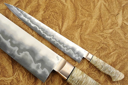

    I think it was Colin's suji when I first saw Bill Burke s work and I remember saving a picture of it and staring for a long time to appreciate the beauty and craftsmanship that went behind it .
    Here is a picture of what I am talking about for the people who haven't seen it before

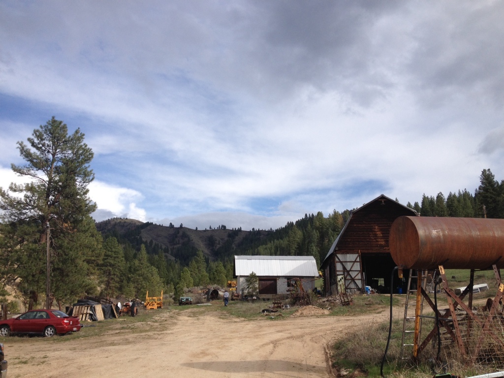

    So , after a year and a bit in knifemaking I came to Boise , Idaho to learn more about forging and San Mai from Bill Burke . I was lucky that he could spend a few days with me before the Seattle knife show . Before I get into shop pictures and some of the stuff we made I wanted to show pictures from outside of his shop . Even the drive through the mountains was great and picturesque with hills, creeks and lakes .

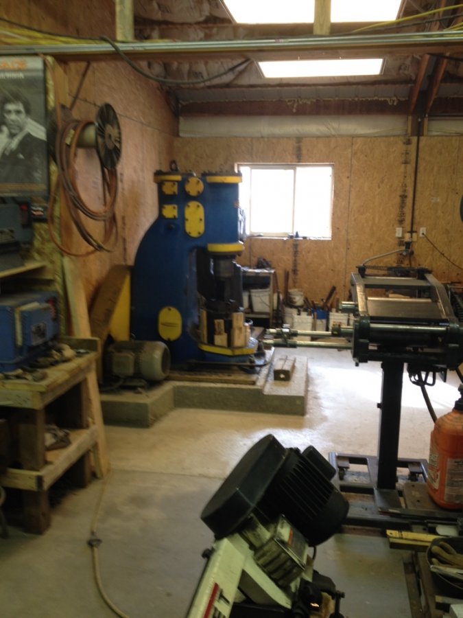

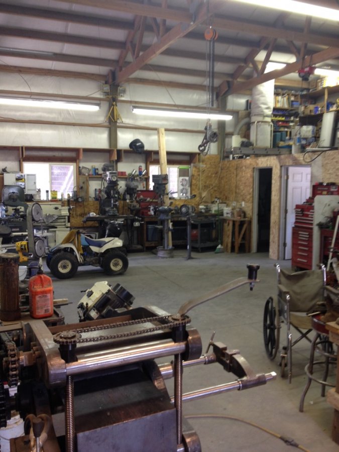

    Now some shop pictures

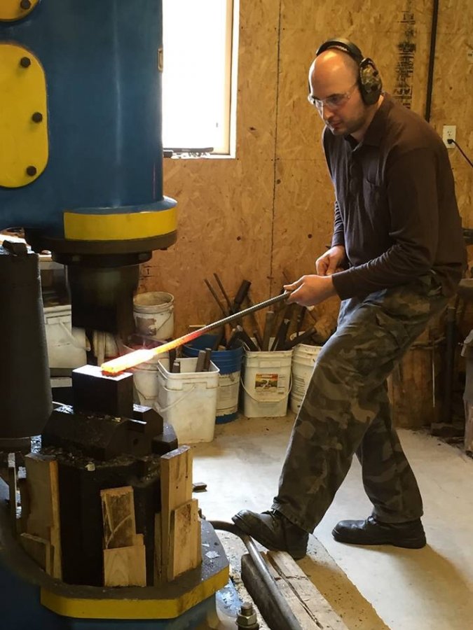

    And this big air hammer , it moves the steel as if it's play dough

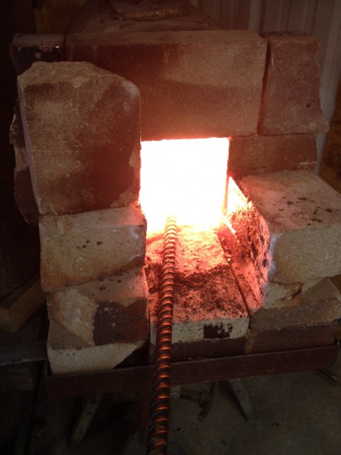

    On the First day we made a random pattern Damascus bar in 1080/15n20 . At First I was over ambitious thinking I could do the whole billet by handforging then after a couple cycles of heating I decided to listen to Bill's advice and use the press and the powerhammer so we can finish the billet and move on to other projects . After we folded the billet to 60 layers , we flattened it using the hot steel roll . I had a small mishap ( made a giant ring :) ) but Bill fixed it before it got out of control .

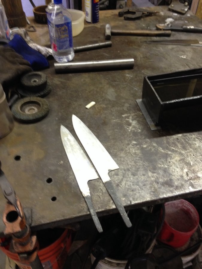

    Next up we did a San mai billet with stainless cladding and 52100 core , after forging the billet into a thinner size we let it cool down and got into forging some gyutos out of 52100

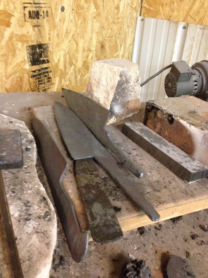

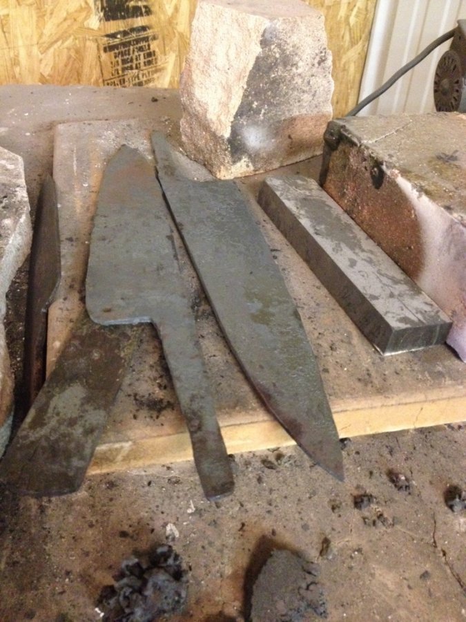

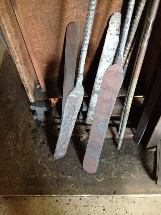

    . We both started with some 52100 and while I was still trying to make it look like a hidden tang knife Bill's full tang knife was at the final shape with distal taper from tip to heel and at the tang with forged bevels in.
    We made couple more knives and in the mean time I got to see some of his custom knives in the works and some knives for the Seattle show .

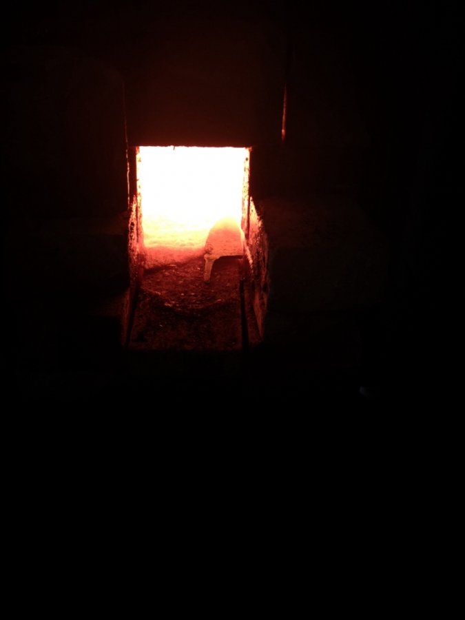

    Next up was the most important part of the knifemaking. We shut the windows and turned off the lights and it was time for heat treating .
    We heat treated the 4 gyutos that we ground earlier that day and talked more about knives and heat treatment . To demonstrate the size of the grain Bill broke a small knife after tempering ,he wasn't happy with the shape of that blade but the grain size was super small , it was an eye opener . After some cold beers we called it a day .

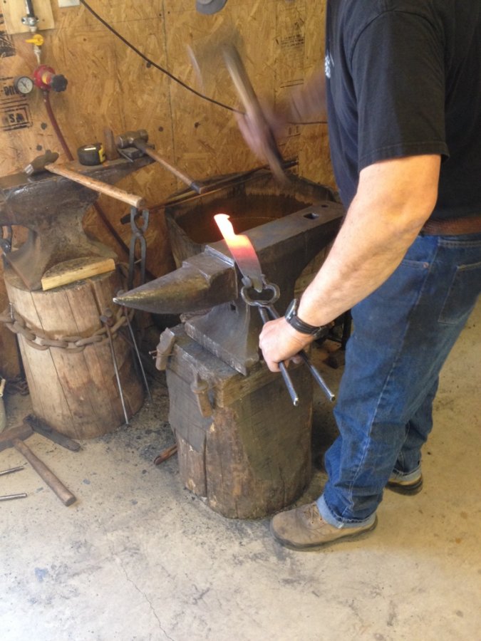

    The last day I was more confident in forging using 2 smaller power hammers and Bill was correcting my bad habits in forging at anvil and hammer . I forged 3 more knives while Bill was working on some knives for the Seattle show . I was requiring his help less in each knife , it felt good to demonstrate that I was actually learning . As you can imagine it is learning the fundamentals right and the rest is muscle memory , I will be forging lot more from now on I can guarantee that .

  15. You look right at home using that massive power hammer, Mert. Very calm and focussed. I think forging knives suits you :)
