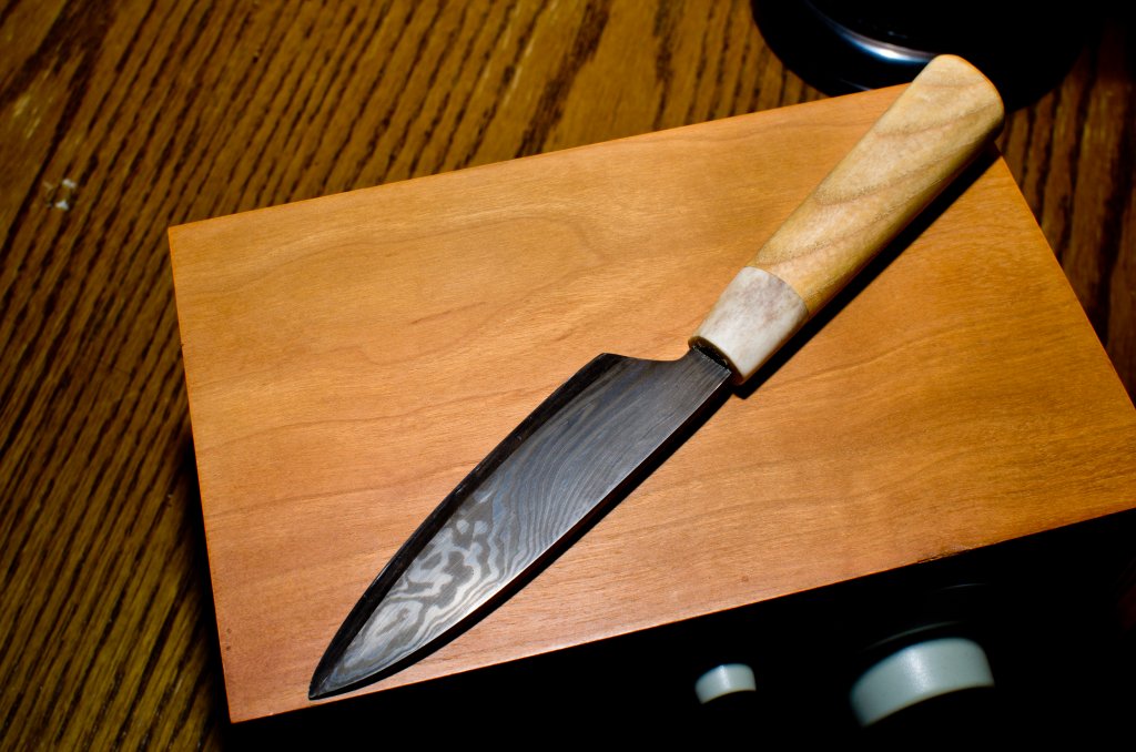

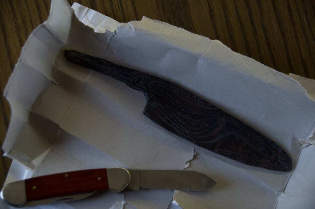

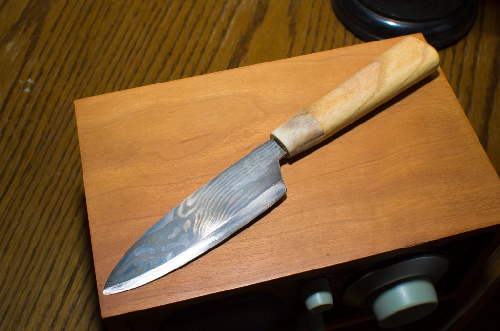

    A forum friend, Bruno, makes razors razors but also knives. He gave me a forged blank he made with the agreement that I posted pics of my progress on his site Wetshaver's Workshop. I would love to take credit for the Damascus forging but that's all Bruno. So in truth, my first kitchen knife is stock removal.
    it is 1095 and 15n20. out of the quench hardness was around 64 and after tempering it down it's about 60. Seen here along side my Case Canoe, when it arrived from Belgium and just after final sharpening. handle is ash and deer antler.

  8. An excellent knife, especially for the first time, ash is an excellent choice for a kitchen knife, but a deer horn because of its porous structure is not well suited for a kitchen knife.
  9. MotoMike
    Thanks for the info Andrei. I have a couple knives with buffalo horn ferrules. been holding up for years. how is the antler different?
  10. Excuse me for criticism, but I do it only for good reasons. The horn of a deer has a porous structure like that of a sponge, moisture enters these pores, which leads to an unpleasant smell and other unpleasant consequences. Buffalo horn, elk horn, walrus tusk and other dense bone are much better suited.

  12. MotoMike
    No offense taken Andrei. no knowledge is bad. The wife seems to like it. If the deer horn ferrule becomes an Issue, I'll just deal with it. I'll know better next time. Thanks again.
