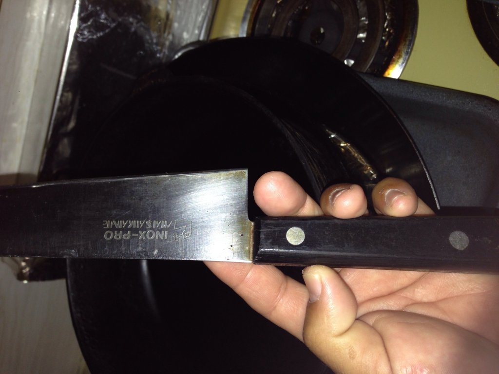

    image.jpg Any advice on how to rehandle and refurbish my 20 year old Masakane? It's an entry level I bought when I was a prep "chef" right out of high school for a local fish market/Hawaiian food joint.

    Simplest is to select handle materials, then drill out the pins. Refinish the blade if desired. Align the handle on the your new material and clamp. Then using the tang as a template drill your holes. If you are using straight pins, its simple. If using corby's you need to plan a little. Insert your pins through the new scales (off the knife) Shape and finish/sand/polish the front of the scales. Epoxy/pin/clamp the scales in place, remove the excess epoxy, and allow to cure. Shape the scales, and finish as desired.

    Thanks! I didn't figure on epoxy between the scales.

    If you search for tutorials for making a "kit" knife, there should be some good info about rehandling a kitchen knife. A kit knife is a blank that is done up and you are adding the handle. Pretty much what you are doing once the handle is removed. A hunting or fillet knife will have a different shape/contour, but it will get you started at least!

    Do not underestimate how great rasps and files are for shaping western handles, a steady bench vise(and steady bench ofc) will take alot of the frustration away for you.
