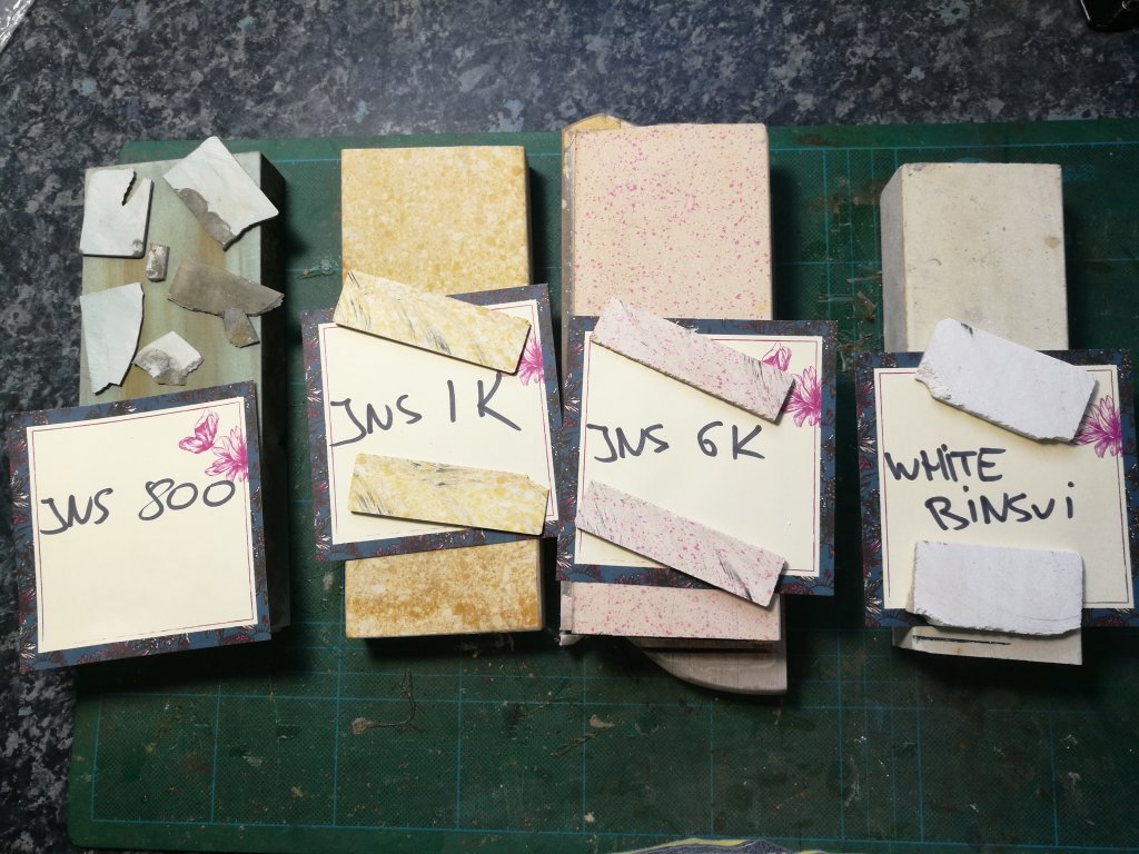

    Hi guys.
    I need to cut the stones into pieces. I have tried bandsaw and regular handsaws with obvious results:D:D:D
    What is the best way to cut a piece of the stone? I was thinking about using Dremel diamond cutting discs. What do you think?

    BathonUk Founding Member
    Thanks, Anton. Now I remember that I have tried angle grinder as well, but with a different disc. I ended up with broken stone. MattS I think that it would be a waste of material because of a thickness of the tile saw.

  12. BathonUk
    Hi guys. Thank you for all answers. I bought a diamond cutting disc and it went into the stones like a butter. Very happy with the result.
