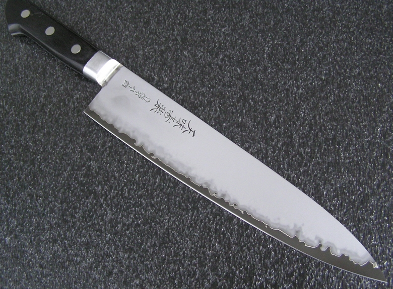

    Guys it is possible to make it by hand but I do not recommend it. Once I tried to mirror polish my Fujiwara Kanefusa Yanagiba. It took me few days and LOADS of elbow grease. Is it worth it? Definitely no. I used sand papers up to 2500 grit and then 3M Wet or Dry polishing cloths up to 1 micron I think. I can't imagine somebody doing the whole knife by hand.
    This is the effect after few days. There was no scratches at all. You can do even better thing in 20 minutes with power tools.
