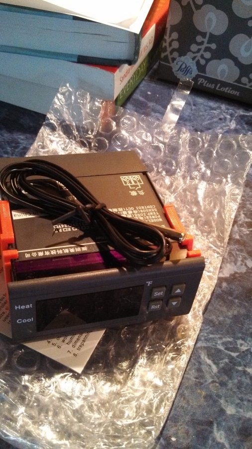

    All this sous vide talk got me to thinking that I might be able to get in the door on the cheap (it's how I roll). Searched and found a cheap temperature controller with a 10 amp relay contact. even was 110 volt ac and calibrated for Fahrenheit. $19 and free shipping from an Ebay seller. IMG_20140501_154011_880.jpg

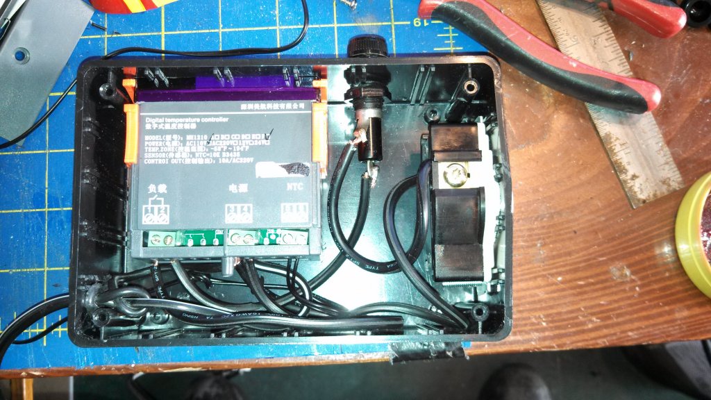

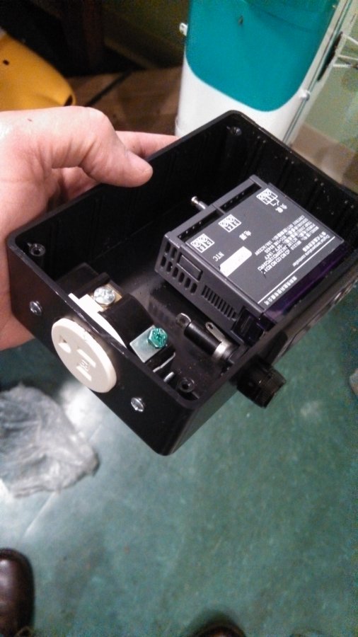

    I had most of the required parts in my junk drawer but needed a project box which I got from radio shack. 10 or 15 minutes with the dremel tool had the required openings cut in the box for a test fit. IMG_20140502_212801_609.jpg
    Here it is ready to be buttoned up.

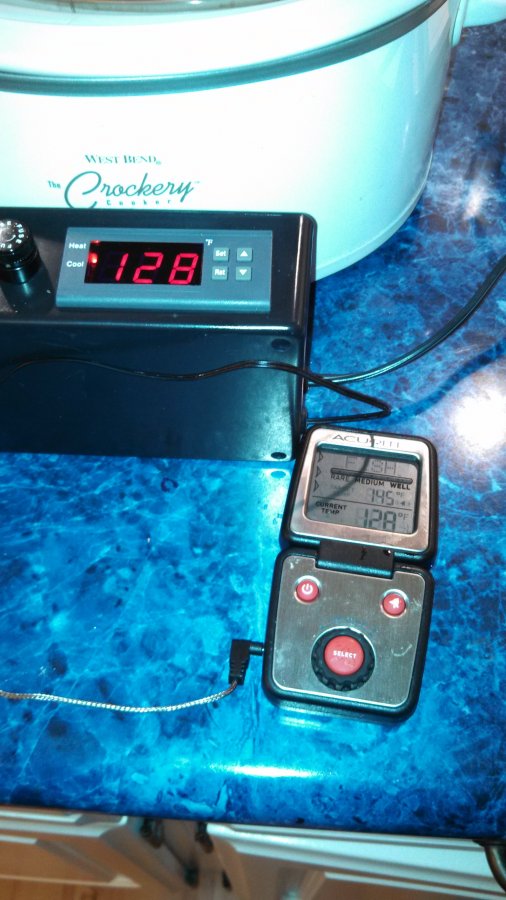

    The test run. I am using my small crock pot just to give me a feel for what I've gotten into. my initial thoughts was that there might be some over run with the heat going through the crock hitting the target temp and then continuing on even though the controller shuts down the heating element. But I thought for a total of less than $25 it was worth a try.
    One of the biggest challenges was trying to understand the included manual. Eventually I just powered it up and experimented with the controls until I figured it out.
    I rigged it up with my Acurite probe thermometer in the water next to the controller probe. I found that the two stepped up and down very closely as it heated and cooled. this controller allows you to set a slew rate down to 1 degree which is where I set mine. it also allows you to set a ceiling temp and a floor temp. For sous vide I suspect you'd need to set all three when ever you wanted to set it up. with the slew at 1 degree, the ceiling at 131, the set temp at 130 and the floor set at 129 I watched anxiously. I found that set up this way the instant the temp hit 131 it shut down the power to the crock pot. this was not solidly at 131, it went back to 130 almost instantly fluctuating from 130 to 131 for about 30 seconds until it stayed at 130 for a few minutes. Again when it dropped to 129 for just an instant, the power was back on and it spent about 30 seconds fluctuating between 129 and 130. It seemed to me that it was never getting very far past the ceiling and floor temps and as such might work in this application. that concludes my tests so far.
