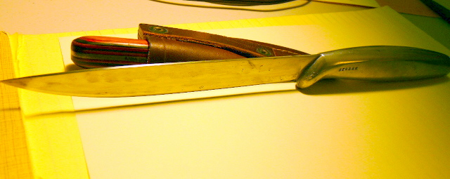

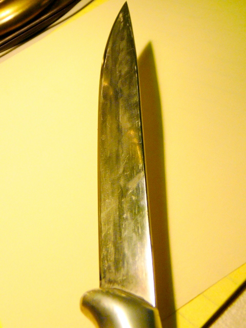

    I will post a picture of a revived old Gerber carver. It had it's original (non gerber.jpg P1030287.JPG ) bevel still on it. Thanks
    to the generosity and curiosity of a member from another forum board, he put a beautiful edge on it.
    Unfortunately, I eventually felt compelled to thin the edge in order to improve performance. Some of
    the scoff marks are from past use and apparent loss of chrome plating(?), but I added my share.
